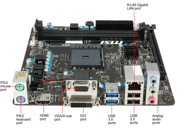

gils83 Posted November 13, 2014 Share Posted November 13, 2014 Â I do not have that option on my Kabini / MSI AM1i and my M5A97pro , i don't know ........ Â Â Â Â Â Â Â Â Link to comment https://www.insanelymac.com/forum/topic/285760-help-topic-for-help-in-os-x-yosemite-1010-and-below/page/87/#findComment-2084897 Share on other sites More sharing options...
