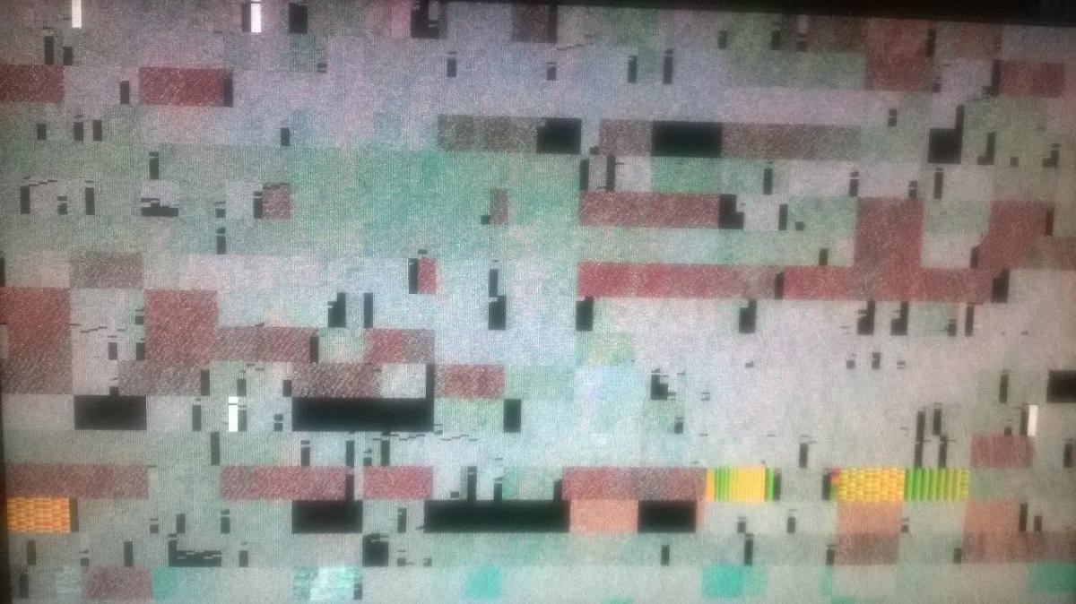

spakk Posted November 25, 2014 Share Posted November 25, 2014 Hi guys! I have problem with my graphics geforce 9800 GT. This card works without issues in previous os x mavericks, in yosemite only artifacts when I use flag GraphicsEnabler=yes and even black screen without this flag. Processor AMD Athlon 64 x2 Sorry for my English =) with -x black screen too Which kernel are you using? booting you with a DSDT.aml? which bootloader you use? please more details and please edit your hardware specifications in your signature, so we can help you better. Link to comment https://www.insanelymac.com/forum/topic/285760-help-topic-for-help-in-os-x-yosemite-1010-and-below/page/90/#findComment-2089318 Share on other sites More sharing options...

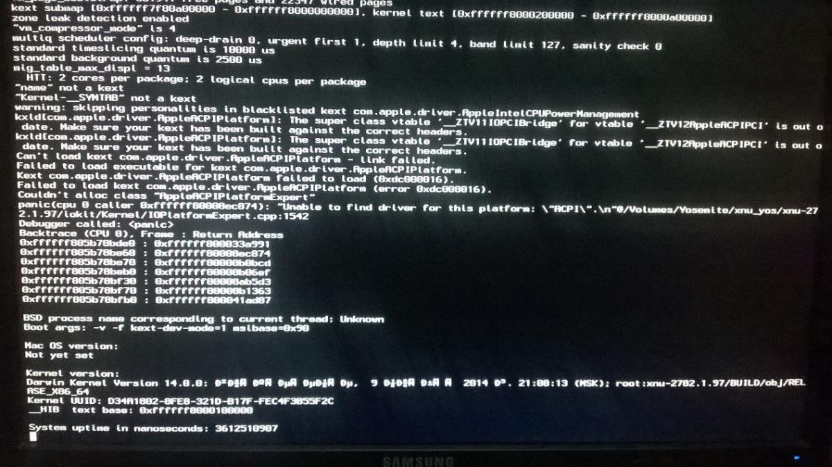

unive Posted November 27, 2014 Share Posted November 27, 2014 And if you end up with a white screen on your GeForce 9800GT, use axmanA's modified IOPC IFamily kextand boot with option msibase=0x90. I take black screen in instalation. after I replaced IOPCIFamily kext there was kernel panic( Link to comment https://www.insanelymac.com/forum/topic/285760-help-topic-for-help-in-os-x-yosemite-1010-and-below/page/90/#findComment-2089819 Share on other sites More sharing options...

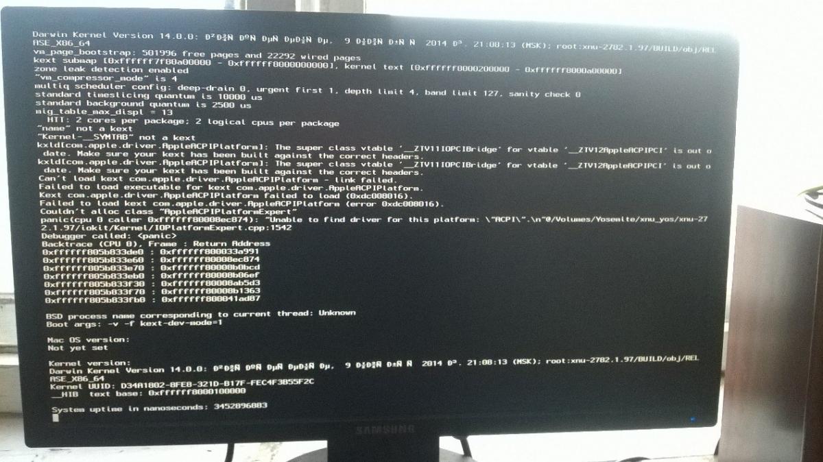

spakk Posted November 27, 2014 Share Posted November 27, 2014 make a picture from the kernel panic and upload it here, a picture says more than a thousand words... Link to comment https://www.insanelymac.com/forum/topic/285760-help-topic-for-help-in-os-x-yosemite-1010-and-below/page/90/#findComment-2089833 Share on other sites More sharing options...
unive Posted November 27, 2014 Share Posted November 27, 2014 make a picture from the kernel panic and upload it here, a picture says more than a thousand words... Link to comment https://www.insanelymac.com/forum/topic/285760-help-topic-for-help-in-os-x-yosemite-1010-and-below/page/90/#findComment-2089924 Share on other sites More sharing options...
spakk Posted November 27, 2014 Share Posted November 27, 2014 @unive install NullpowerManagement.kext and FakeSMC.kext into S/L/Extensions and remove the AppleIntelCPUPowermanagement.kext from S /L/Extensions.then fix the permissions with kext wizard ! then boot with: kext-dev-mode=1 npci=0x3000 -v Link to comment https://www.insanelymac.com/forum/topic/285760-help-topic-for-help-in-os-x-yosemite-1010-and-below/page/90/#findComment-2089959 Share on other sites More sharing options...
unive Posted November 28, 2014 Share Posted November 28, 2014 nullpower and fakesmc are already there in folder extra. and I booted with those parameters tried again with deleted AppleIntelCPUPowermanagement.kext Link to comment https://www.insanelymac.com/forum/topic/285760-help-topic-for-help-in-os-x-yosemite-1010-and-below/page/90/#findComment-2090042 Share on other sites More sharing options...

spakk Posted November 28, 2014 Share Posted November 28, 2014 @unive if you have installed the drivers into /Extra/, then you need to boot with this flag: kext-dev-mode=1 npci=0x3000 UseKernelCache=no -v -f I think Bronya has detected a another possibility fault , therefore, answer the question of Bronya --->maybe you used the wrong kernel that is not compatible with your CPU --> a possible kernel will work with your CPU is BSA_10.10_rc1 Link to comment https://www.insanelymac.com/forum/topic/285760-help-topic-for-help-in-os-x-yosemite-1010-and-below/page/90/#findComment-2090047 Share on other sites More sharing options...
