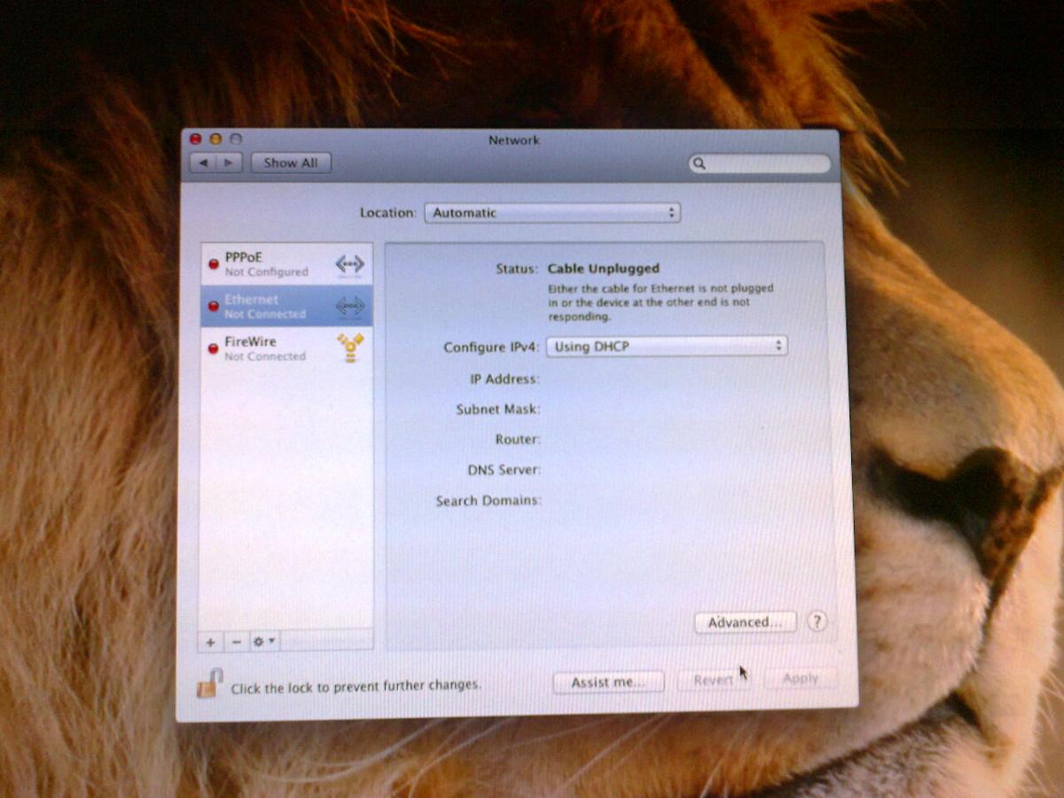

cannon_dt Posted April 22, 2013 Share Posted April 22, 2013 @spakk Here is the original Lion version of IONetworkingFamily.kext - here I cannot find IOPCIPrimaryMatch key at all - so I got no clue where to give my device id and vendor id Evoreboot worked, so thats one problem down. But ethernet and audio are just not working Here is a screenie of network in Lion IONetworkingFamily.kext.zip Link to comment https://www.insanelymac.com/forum/topic/285760-help-topic-for-help-in-os-x-yosemite-1010-and-below/page/47/#findComment-1909557 Share on other sites More sharing options...
cannon_dt Posted April 22, 2013 Share Posted April 22, 2013 I also tried using the kext at http://www.insanelymac.com/forum/topic/280822-solved-os-x-1074-broke-my-realtek-rtl8168c-ethernet/ Modified with my device and vendor ID and without - in both cases nothing works. Nothing has helped me with this ethernet issue Link to comment https://www.insanelymac.com/forum/topic/285760-help-topic-for-help-in-os-x-yosemite-1010-and-below/page/47/#findComment-1909621 Share on other sites More sharing options...
dkechoi Posted April 22, 2013 Share Posted April 22, 2013 I also tried using the kext at http://www.insanelym...8168c-ethernet/ Modified with my device and vendor ID and without - in both cases nothing works. Nothing has helped me with this ethernet issue One tip for you. The device information you got from linux or osx may not correct because that information is how system recognized. If not working, you may use wrong information. So, get the exact device name of audio and network from the specification of your motherboard manual or their web site, post here, then get help. Without correct information, it is hard to help you, and person who is willing to help you also will be frustrated. So, please check your information is correct or not. EDIT: The information from the OS where your device is working does not gaurantee it will work for other OS using the same information. Real physical name of a device matters. How to treat is depends on OS. Link to comment https://www.insanelymac.com/forum/topic/285760-help-topic-for-help-in-os-x-yosemite-1010-and-below/page/47/#findComment-1909635 Share on other sites More sharing options...
cannon_dt Posted April 22, 2013 Share Posted April 22, 2013 Yipeeeeeee.. I did it!! I did use the next from http://www.insanelym...8168c-ethernet/ What I noticed was that in the kext there was another next. Despite the number of times I installed it, it still never loaded (I used the Loaded tab in next wizard). So I used the kext within the next, used kext wizard to install it and the I repaired permissions etc and I got a new "Ethernet 2" in my network. I am typing this from Safari in my Mac Lion now. I still cannot get my audio to work though @dkechoi The vendor ID and device ID I got is from System Info which is what we are supposed to use while making out dsdt (as per hackintosh instructions). I thought this was accurate enough for me to get help. In fact in the kext that finally worked for, I checked that the device id and vendor ID (8168 and 10ec) was already there in Info.plist (this is what the guy in that thread also mentioned). I apologize if I gave anyone any wrong information thus making it more difficult to assist Link to comment https://www.insanelymac.com/forum/topic/285760-help-topic-for-help-in-os-x-yosemite-1010-and-below/page/47/#findComment-1909643 Share on other sites More sharing options...

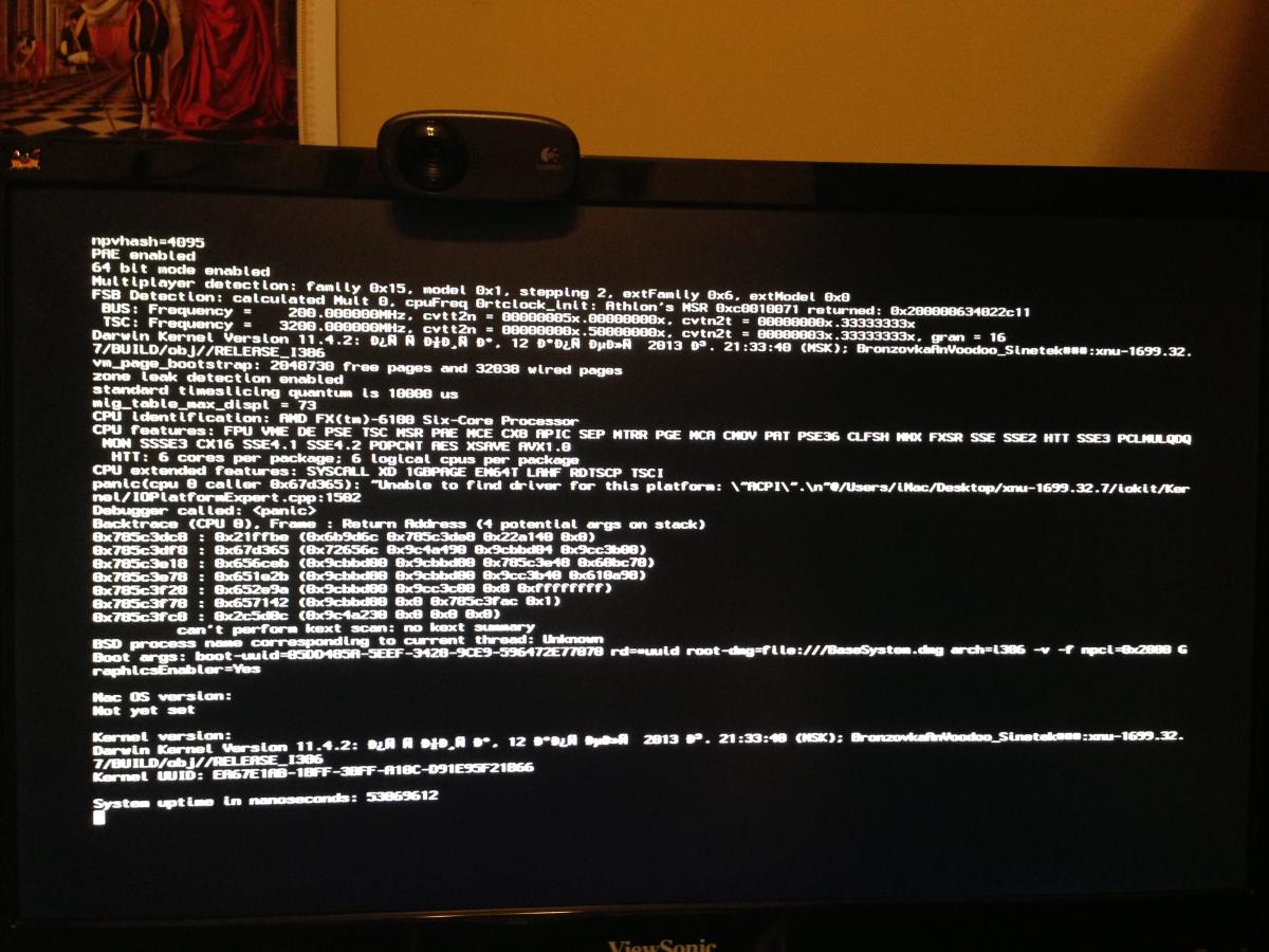

garner Posted April 23, 2013 Share Posted April 23, 2013 Hello, i was wondering if anyone has been successful with the components that i have or anything similar. I am looking for a good tutorial. Here are my specs: AMD FX 6100 six core processor socket am3+ (942) 3.30 GHz Gigabyte GA 970A DS3 motherboard chipset AMD RD9x0 BIOS - Award software international inc , Version- F4 8 GB DDR3 RAM NVIDIA geforce GTX 560 Ti Graphics Card 120GB SSD hard drive, 3 TB internal hard drive Thank you in advance for any help. 1 Link to comment https://www.insanelymac.com/forum/topic/285760-help-topic-for-help-in-os-x-yosemite-1010-and-below/page/47/#findComment-1909785 Share on other sites More sharing options...
theconnactic Posted April 23, 2013 Share Posted April 23, 2013 Install Lion using this tutorial: http://www.insanelymac.com/forum/topic/278181-amd-1073-guide-experimental-only/ But instead of the kernel recommended by Devout - which is deprecated, since it's not that stable - use this one: mach_kernel_rc13 And instead of the bootflags recommended in the tutorial, use these: arch=i386 -v -f npci=0x2000 GraphicsEnabler=Yes. Good luck! 1 Link to comment https://www.insanelymac.com/forum/topic/285760-help-topic-for-help-in-os-x-yosemite-1010-and-below/page/47/#findComment-1909786 Share on other sites More sharing options...
garner Posted April 23, 2013 Share Posted April 23, 2013 I did everything that you said theconnatic and this is what i got. Any help would be appreciated. Thanks. 1 Link to comment https://www.insanelymac.com/forum/topic/285760-help-topic-for-help-in-os-x-yosemite-1010-and-below/page/47/#findComment-1909961 Share on other sites More sharing options...
