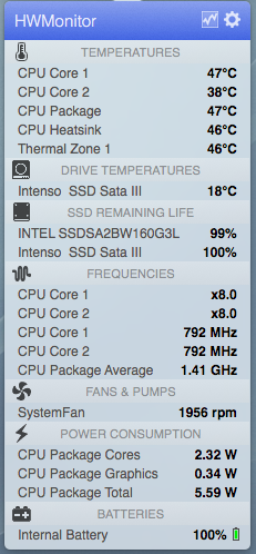

Side question... what idle temps are most folks seeing on their T Series? I am at 48-50 idle with an i5-2450M CPU @ 2.50GHz. On boot for the first 25 seconds after the screen comes up it gets to 75-80 but then settles in to the low 50's. I replaced the fan unit in the last 6 months from the original and that did make a difference. It was idling at 58-60 before that upgrade.
