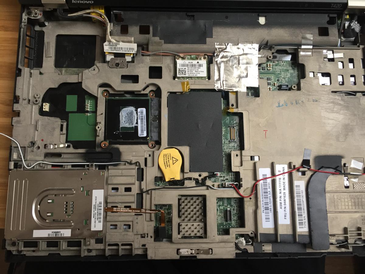

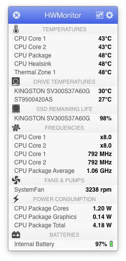

@Somez- do you have the modded bios where you can change the thermal settings? are they the same settings?
do have the same HD in each machine. a SDD runs a lot cooler. idle while writing this the CPU temps range from 41-44C (106-108F).  the FAN is running around to 1958rpm.
my son has same computer but his runs a lot hotter for some reason.

May I ask those who can reach cpu temperature around 41 C and fan speed around 2000 RPM to check what's the part number of their heatsink? It's located under the keyboard and starts as "FRU".
Thanks.

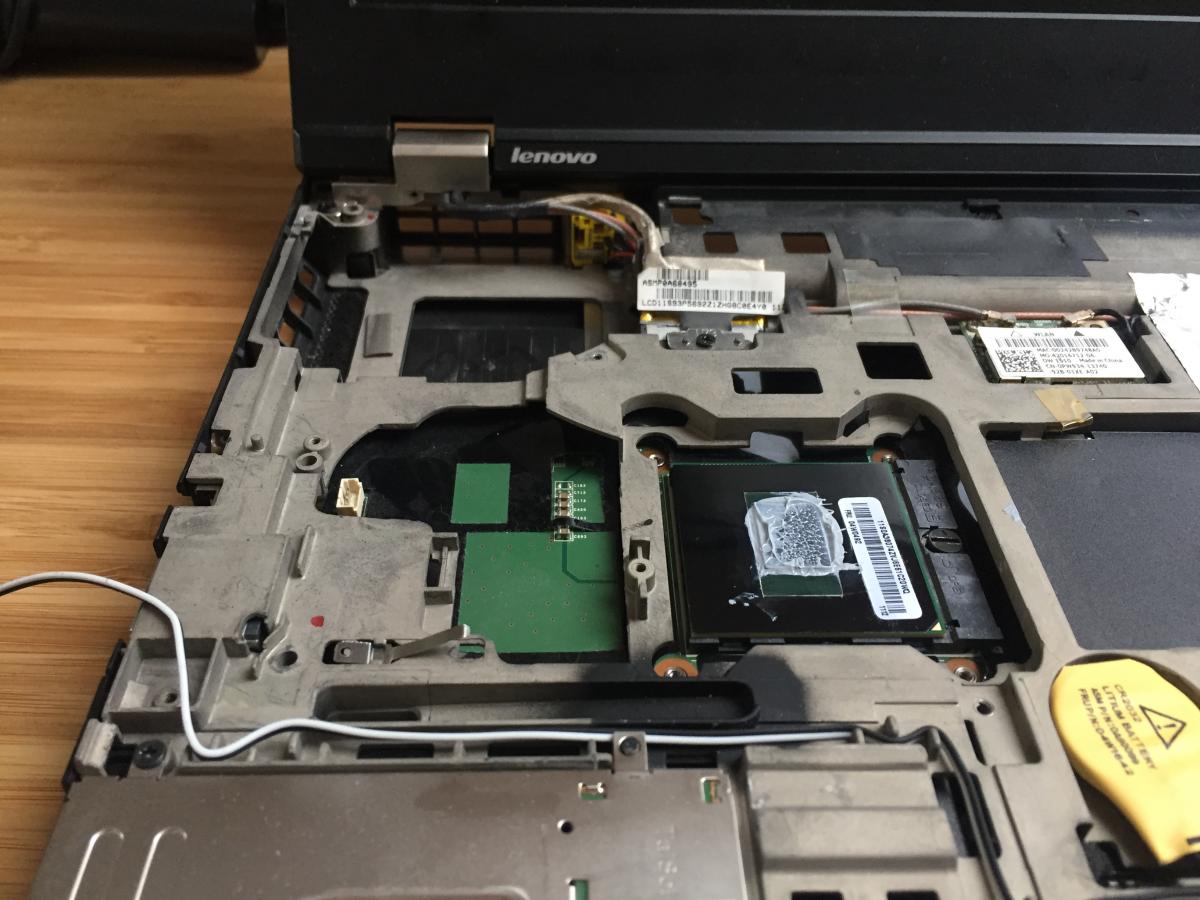

@Somez
In my experience it depends also on the specific heatsink/fan piece itself, not only if its single thick/double thin pipe heatsink, and different fan.
I had the 04W0627 which cooled very well the 2520m, but the 04W0407 worked better for me with the quad processor (idle now at 36 C/1962RPM, but its winter ;) ). Altough for some people it was the other way around, check out this thread if u understand german (https://thinkpad-forum.de/threads/170582-Erfahrungsberichte-Quadcore-im-T420-Mod-Bios-inside).
My gf's t420 has the 04W0627 with 2540m cpu, and its not cooling as well as the one i had (don't know if it just needs repasting, or else...), I can hear her fan spinning up a lot, just with browsing..

I might order a 04W0627 and try out how that works.
@somez - i will check my 2 T420 systems for the Fan FRU. if you install the modded bios with adv menu that provides more control of fan vs temperature.

Well, I haven't changed any advanced settings so far. I'll try to play with the values for the low fan speed, e.g. to trigger low fan speed on higher temp. This will not cool my CPU down though...
