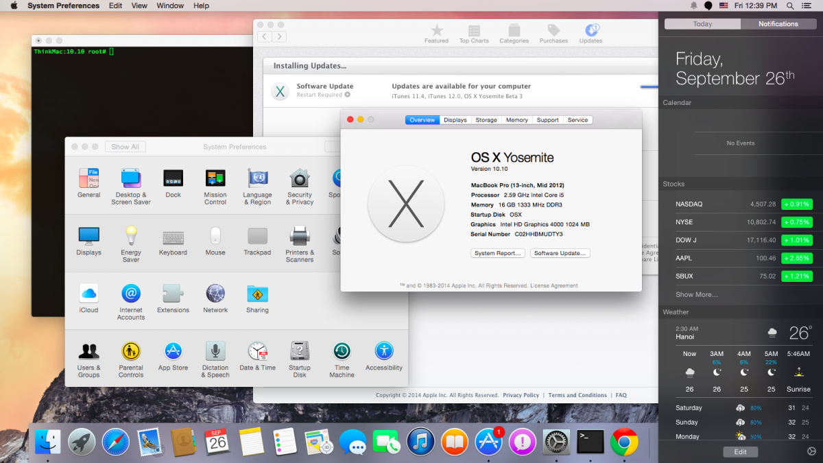

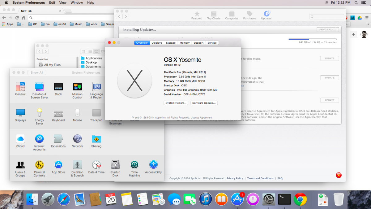

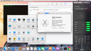

Anyone tried 10.10 Yosemite? I tried last night and it's work with some issues, but useable. I have updated to Beta 3 also.
Here is some screenshots:
Short summary:
- Bluetooth
- NVIDIA not work (DP1, not tested on Beta3)
- Intel HD4000: native res but no QE/CI
- Sound: Need to patch AppleHDA.kext for layout 28
- Battery: need new patch in DSDT (use tluck's T420 DSDT work)
- Sleep / Shutdown work as Mavericks

Hi,  when do you plan on posting kexts?  I've recently install 10.9 on my T430 however am yet to get USB3 or the webcam working.  I've used myhack/chameleon, should I instead be using clover to ensure success?
Aside from the Nvidia chipset, my hardware seems to be identical to yours.

Thanks Uoc Nguyen.  I'm new to hackintosh and I probably will have other questions be posted later.
Thanks again for your help.

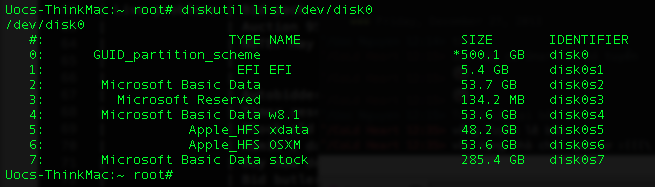

@uoc-nguyen
So I have created mavericks USB bootable disk using this command
sudo /Applications/Install\ OS\ X\ Mavericks.app/Contents/Resources/createinstallmedia --volume /Volumes/Untitled --applicationpath /Applications/Install\ OS\ X\ Mavericks.app --nointeraction
I have modified config.plist
I have clover installed
I am stuck on configuring clover to boot so I can install mavericks
Share this post
Link to post
  You must create a GPT UEFI compatible disk (Follow this instruction to create it: https://wiki.archlinux.org/index.php/UEFI#EFI_System_Partition)
  In short, you must have an ESP (EFI partition), it is a small FAT 32 partition (about >= 128M depend your need) with EFISYS flag. It used to store CLOVER or any EFI firmware / bootloader, Linux kernel, config file, theme...
  After created a GPT partition you can verify it by command `sudo diskutil list /dev/diskX` with diskX is your USB disk, usually is disk1 as disk0 is your internal HDD, and you will see something like this:
I use some live Linux distro for some reasons, that's why my partition number 1 (EFI) is large.
  Since EFI partition is a system partition so Operating System usually hide it. You can mount it by command `sudo disk mount /dev/diskXsY` (if your EFI is first partition of your USB disk then diskXsY should be disk1s1). Now you can install CLOVER and copy config files... to this partition and create your Mac Installer Bootable USB.
  Hint: Press F12 to select boot from USB after reboot
Happy hacking!

I own a T430 Type 2347A39.
After install your kexts I got everything working except the audio and the restart, sleep etc. I was working before the kexts installs...
But how did you got the fn-F9 to work for increase brightness?? My screen is too dark and I have no option to increase...
Share this post
Link to post
  • Audio: you will need to patch AppleHDA and edit DSDT to use it, I'm patched and using the layout 28, you can use my patched AppleHDA version 2.5.3 from 10.9.1 AppleHDA.kext-10.9.1.zip
  • For brightness, currently I'm using the _Q14, _Q15 (Fn-K, Fn-P) in DSDT to control the brightness. If you want to use Fn+F8/F9, you need to find out which Keycode used and will need to edit the DSDT or `/System/Library/Extensions/VoodooPS2Controller.kext/Contents/PlugIns/VoodooPS2Keyboard.kext/Contents/Info.plist`
  • IFAIK, Shutdown / Restart / Sleep may caused by UEFI CLOVER, I take some work around but it still not stable to use, it is needed to edit the DSDT _PTS, _WAK method, try to use some code from this thread http://www.insanelymac.com/forum/topic/285678-lenovo-thinkpad-t420-with-uefi-only/page-25?do=findComment&comment=1952283 as reference. I tried a lots but still no luck.
