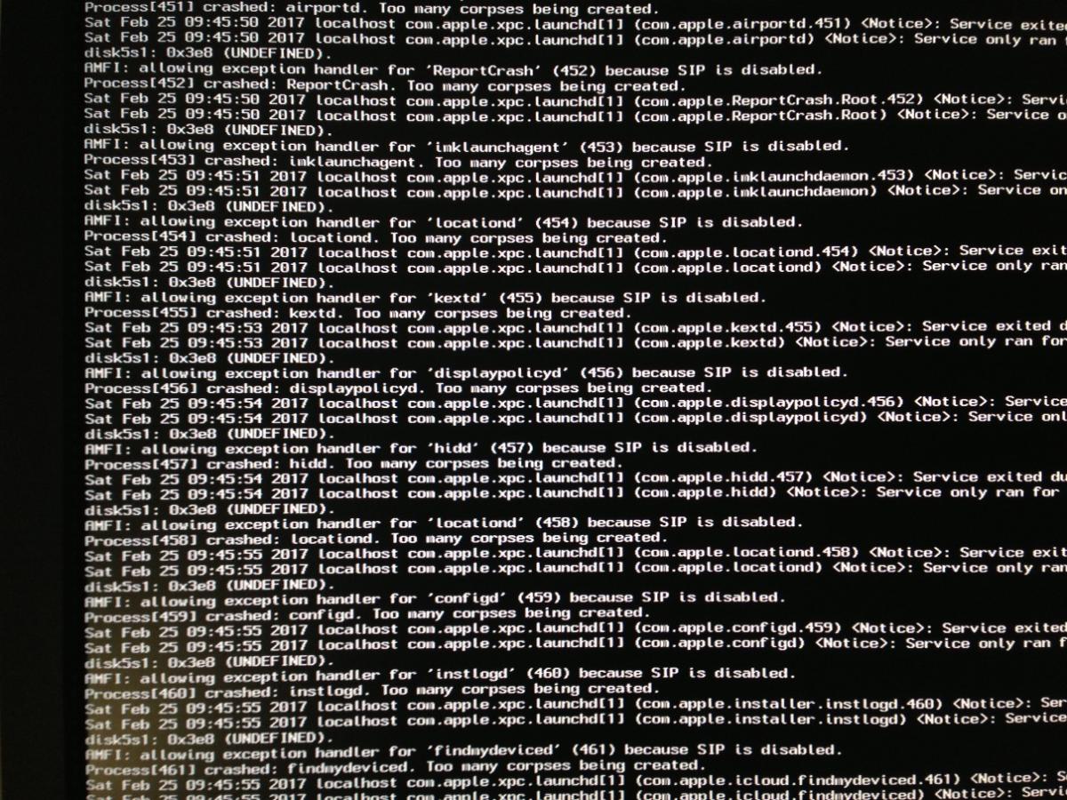

149113 Posted February 25, 2017 Share Posted February 25, 2017 Decided to do a fresh install on my T520 using a 10.12.3 image. Cannot get to the installer. Screen shot below when running in verbose boot mode. The T520 has modded bios 1.45 (latest I could find with a whitelist). The progress bar on the apple boot screen makes it to the end and the activity light still flickers but will not launch into setup. Any suggestions? Link to comment Share on other sites More sharing options...
tluck Posted February 26, 2017 Share Posted February 26, 2017 no idea. the screen shot doesn't provide any help. does the installer have the same Clover ESP as from the HD? Link to comment Share on other sites More sharing options...

149113 Posted February 26, 2017 Share Posted February 26, 2017 no idea. the screen shot doesn't provide any help. does the installer have the same Clover ESP as from the HD? No, I took the one from the latest .zip file and copied that to the USB installer. I'm installing this as a fresh install to a new mSATA drive. Has anyone used the 10.12.3 build with the T420 folder to do a new install? Edit: I ended needing to replace the DSDT files in the EFI folder with ones from a T520. That was only way I could get the USB to boot to the install screen Link to comment Share on other sites More sharing options...

149113 Posted February 27, 2017 Share Posted February 27, 2017 I was able to get a working 10.11.6 T520 with these files including DSDT. I just rename matched resolution config.plist to install it. Have you tried to install to a standard SATA drive? Can you upload that DSDT to try it? Here's the one that I created for my T520. It was the only thing I changed to get it to boot. Everything is up and running now with no issues. I don't remember changing that for El Capitan but that was a long time ago. DSDT.rar Link to comment Share on other sites More sharing options...

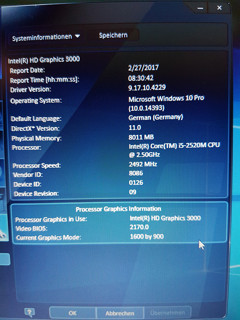

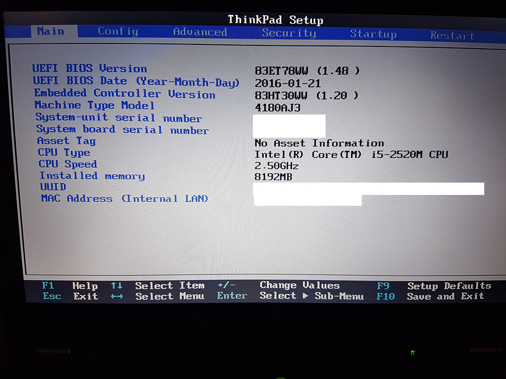

Zandig Posted February 27, 2017 Share Posted February 27, 2017 Modded 1.48, has all the good stuff like the modded 1.46. Lenovo T420 420i v1_48 OAM_NWL_AES-NI_MSR_0xE2_Unlocked_memory_speed_vbios_intel_2119.rar Same as above, but with even more recent Intel VBIOS 2170. Lenovo T420 420i v1_48 OAM_NWL_AES-NI_MSR_0xE2_Unlocked_memory_speed_vbios_intel_2170.rar 1 Link to comment Share on other sites More sharing options...
