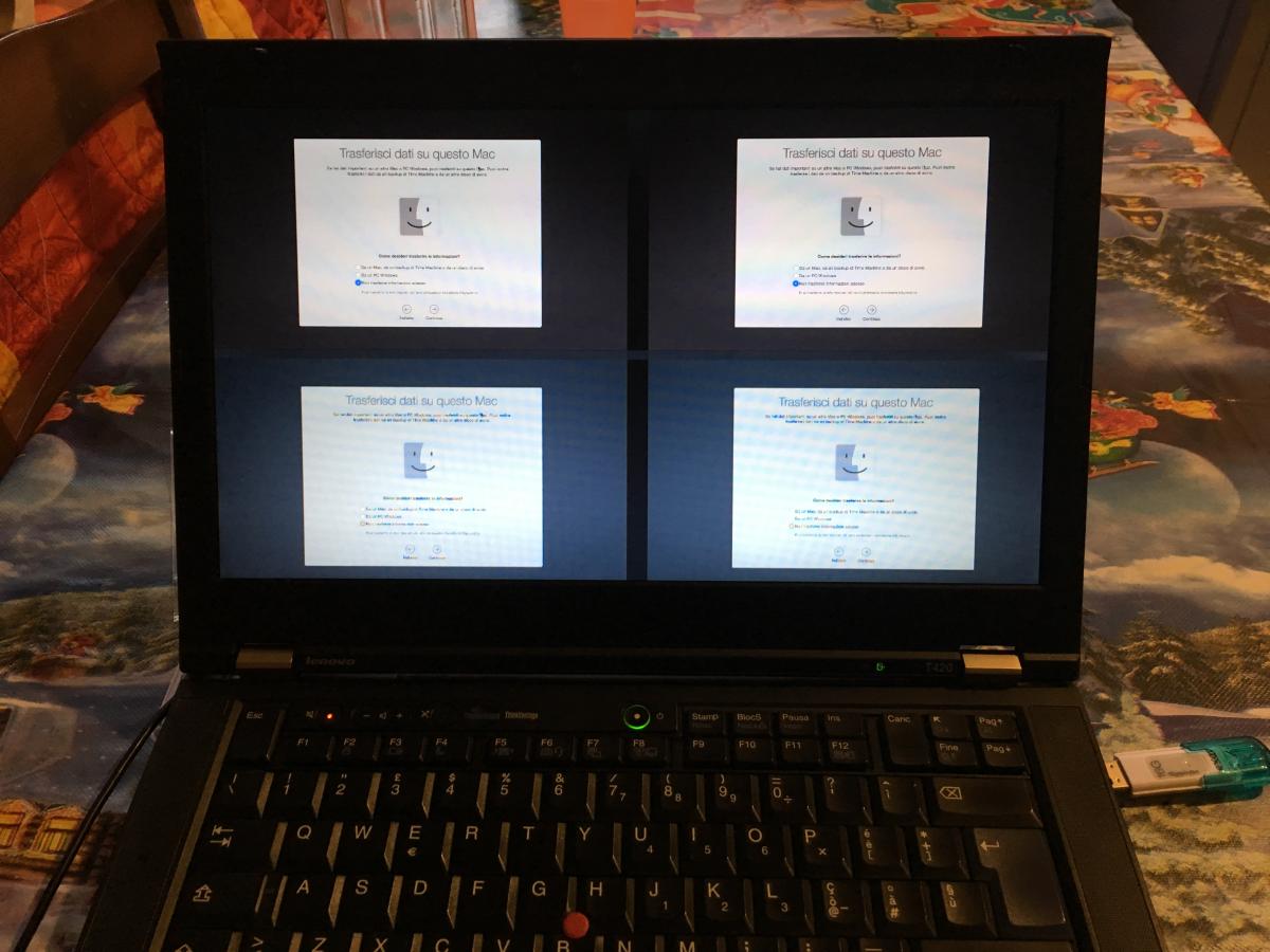

Fibroga Posted January 19, 2017 Share Posted January 19, 2017 Ehi! I have a T420 lenovo , the Low res one. Just installed yosemite but in boot i'm getting this. Can someone helpme ? Bought this laptop Just for mac? Link to comment Share on other sites More sharing options...
tluck Posted January 19, 2017 Share Posted January 19, 2017 @lolxapple - seems like you are up and running now? odd that the ethernet kext would do that. i wonder if there was a kext cache issue? @Fibroga - Yosemite!? how about Sierra or El Capitan... Anyway... when you see a display like this, it usually means you are using DualLink=1 instead of DualLink=0 - or visa versa. which config.plist did you select to use? Link to comment Share on other sites More sharing options...
Fibroga Posted January 19, 2017 Share Posted January 19, 2017 @lolxapple - seems like you are up and running now? odd that the ethernet kext would do that. i wonder if there was a kext cache issue? @Fibroga - Yosemite!? how about Sierra or El Capitan... Anyway... when you see a display like this, it usually means you are using DualLink=1 instead of DualLink=0 - or visa versa. which config.plist did you select to use? That's the problem. How can i Select the right plist ? Using Yosemite cause i have bought an asus wifi usb adapter working with yosemite Link to comment Share on other sites More sharing options...
Fibroga Posted January 19, 2017 Share Posted January 19, 2017 @Fibroga - well is your display 1366x768 or 1600x900? - do you have asus usb-n10 usb? if so the yosemite driver works on El Cap or Sierra. i use the 1083 driver and wireless adapter utility 2.0.2 there are some issues with sleep/wake - but i can share some scripts to help with that. but the basic idea is to shut down the this adaptor before sleep or it goes to zombie land. Yes that's the adapter, i have a 1366x768 display Link to comment Share on other sites More sharing options...
skoal2007 Posted January 19, 2017 Share Posted January 19, 2017 Yes that's the adapter, i have a 1366x768 display cp config.1366x768.plist config.plist instead of cp config.1600x900.plist config.plist Link to comment Share on other sites More sharing options...

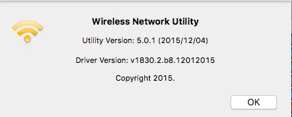

tluck Posted January 23, 2017 Share Posted January 23, 2017 the asus usb N10 connects to my wifi at 72 Mbps (mega BITS per second) max. Ethernet is 1000 Mbps max. i just tested with my asus usb wifi on download and i got 51 Mbps - which is pretty much the limit with my internet provider. here is the driver and App i use: @liumizhou - well i dont know about TrackPoint disappearing. i give up. this new version does a full hw reset on startup etc. been working very well for me. before TrackPoint was always missing on startup. sleep/wake always makes it work - now it works on startup every time. on Fingerz and speed - you can adjust these values to your own situation in the VoodooPSTrackpad/Contents/Info.plist to suite your taste. the speed can be adjusted with Accessibility prefs as well. asus-N10.zip Link to comment Share on other sites More sharing options...

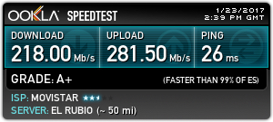

trifero Posted January 23, 2017 Share Posted January 23, 2017 With the same utility as tluck says, version 5.0.1, attached an A2000UA tu a USB 3.0 pcmcia, i have these results… Link to comment Share on other sites More sharing options...
