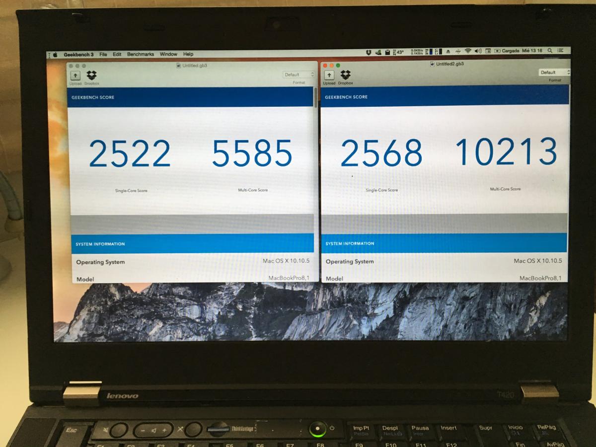

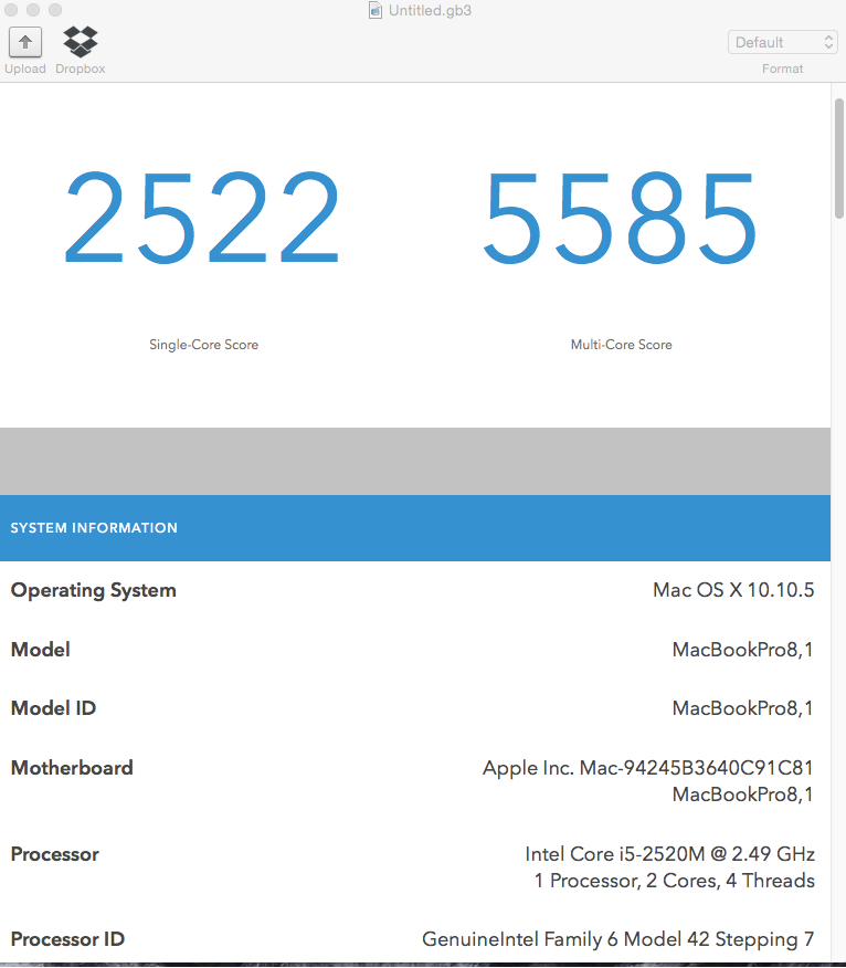

Just in case it is of interest for anyone. Updated my sister´s (my old) T420 with a Intel Core i7 2720QM 2.2GHz Quad.
Temperatures at idle is 36-40º C
Never exceeded 91º C at intensive use
Used artic clean thermal remover, surface purifier and Silver 5

Hi trifero!
What was the previous CPU and what temps did you get with that one?
Thanks.
Thanks for your benchmarks!

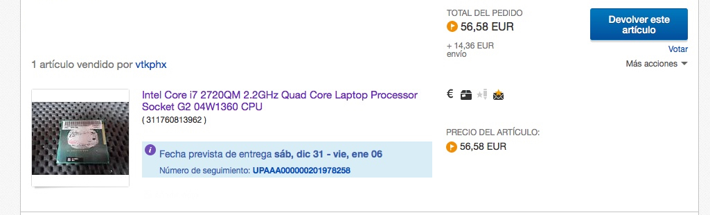

I was thinking of a 2720QM the other day. May I ask how much cash you had to throw for it?
From the days of my MacII I learned that one would hardly notice a cpu upgrade in everyday work unless you would roughly gain the double benchmark wise.
A 2720QM is worth a thought it seems. (Hope this won't spoil second hand prices totally now.)
yeah! double the performance is pretty good. especially for the price - they seem to be about $75 US on eBay. i have moved on to focus on my T460 right now.

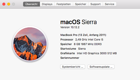

As many here are using the unlocked T420 BIOS, did anybody manage to assign 512MB RAM to the HD3000?
There is a setting for it in UEFI/BIOS, but I´m clueless how to tell the OS to grab 512MB instead of 384.
Could be a Clover tweaking as well.
Just curiosity on my side, whether 512MB would somehow better things compared to 384.

@goodguess - here is a clover kext patch that give you 512MB with 4GB of memory - I do this on my son's box that only has 4GB
<dict>
    <key>Comment</key>
    <string>HD3000 384 to 512</string>
    <key>Find</key>
    <data>
    x0W8AAAAGA==
    </data>
    <key>Name</key>
    <string>AppleIntelSNBGraphicsFB</string>
    <key>Replace</key>
    <data>
    x0W8AAAAIA==
    </data>
   </dict>

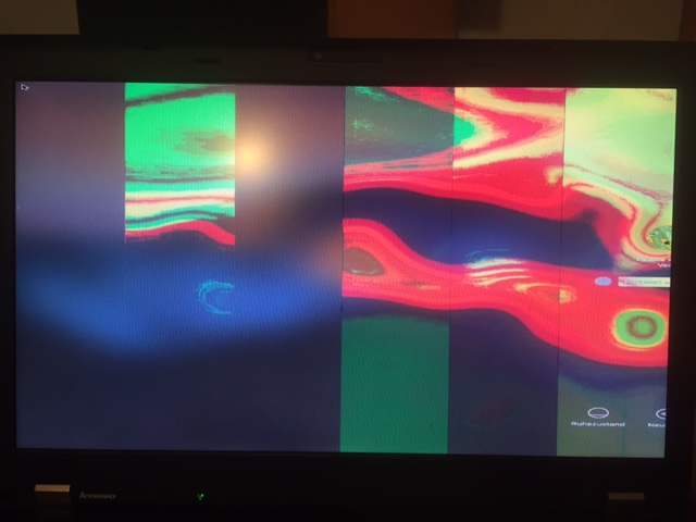

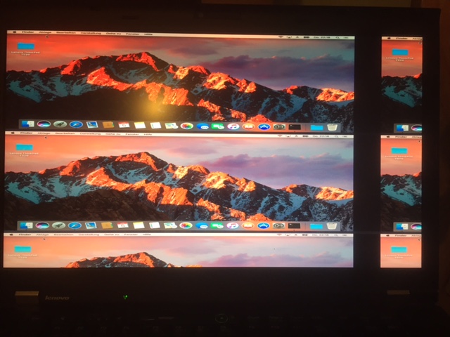

After having converted two Lenovo X220's (without any troubles following the instructions at http://x220.mcdonnelltech.com),I now started converting my own T520, following this guide, since the hardware seems to be nearly identical. As with the X220, I got a BIOS with removed whitelist, and replaced the WiFi with a Dell 1510. Installation was easy thanks to the provided files, thanks again!
Only place where I had to get away from the tutorial was where it came to the screen resolution - I renamed config.1600x900.plist, but updated it inside to 1920x1080 (using the standard plist editor on my iMac, replaced resolution in two places).

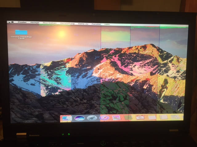

Now the T520 is up and running, with just a "tiny" but highly visual problem: my desktop appears multiple times on my screen!
Clover is showing 1920x1080, the monitor system settings do show 1920x1080 as well, and switching resolutions will only switch resolution in their existing "frame".
Any idea what I can do about this would be quite welcome :)
@CCRDude - the difference between the config.1600 and config.1366 files are 2 things:
1) 1600 = injects a custom EDID to fix a problem with bios T420 EDID
2) 1600 = has DualLink =1
so restart start with the 1366 config and then if you need DualLink=1 edit and reboot.

I copied the 1366 config. but only got what I also had when booting from my X220 pre-configured USB stick. I get the left half of the desktop filling my whole screen, with some psychedelic colours:
(btw, the 1920x1080 resolution works fine from Windows boot stick and Ubuntu boot stick, so I'm sure the display specs are correct)
@CCRdude - so now that you removed the bogus EDID from the 1600 config, you probably need change DualLink=0 to DualLink=1
