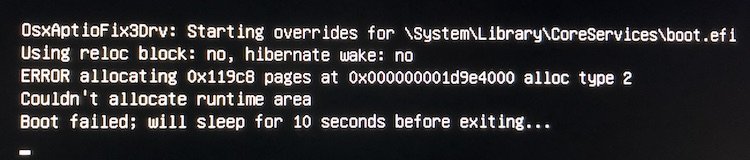

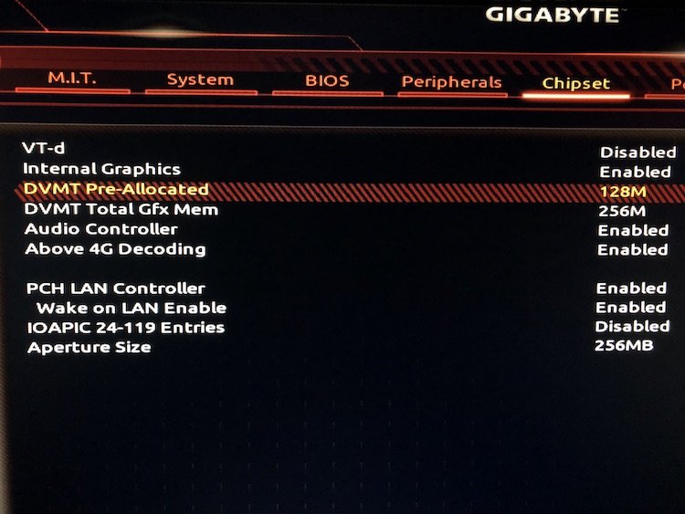

telepati Posted October 14, 2019 Share Posted October 14, 2019 56 minutes ago, vector sigma said: 370 megas aren't enough... so why not taking the default vram (if I've understood you well)? There's no magic to do if the best page is already too small. The only way is to not use AptioMemoryFix, but using one of the OsxAptioFix* that free memory.. This is the setup on BIOS I tried all AptioFix options in Clover Installer; None of them work with the setup above. If I set 64M to 256M AptioMemoryFix.efi working but others AptioFix doesn't work. Link to comment https://www.insanelymac.com/forum/topic/284656-clover-general-discussion/page/813/#findComment-2693601 Share on other sites More sharing options...
vector sigma Posted October 14, 2019 Share Posted October 14, 2019 (edited) 1 hour ago, telepati said: If I set 64M to 256M AptioMemoryFix.efi working but others AptioFix doesn't work. Well, you know what to do: 2 hours ago, vector sigma said: so why not taking the default vram The prelinkedkernel needs more room in a hack due to how boot.efi and the firmware handle the memory... and our aren't real macs. You can try to rebuild the cache, in case the new one will be smaller, or just use the simplest solution ever: legacy Clover. Edited October 14, 2019 by vector sigma 2 1 Link to comment https://www.insanelymac.com/forum/topic/284656-clover-general-discussion/page/813/#findComment-2693611 Share on other sites More sharing options...

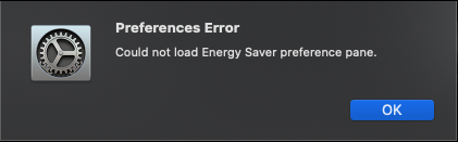

D-an-W Posted October 16, 2019 Share Posted October 16, 2019 Sorry if this is totally unrelated and off topic but just wanted to check if any fellow Clover users had this issue with the latest Catalina 10.15.1 Beta release? Link to comment https://www.insanelymac.com/forum/topic/284656-clover-general-discussion/page/813/#findComment-2693880 Share on other sites More sharing options...
Matgen84 Posted October 17, 2019 Share Posted October 17, 2019 6 hours ago, D-an-W said: Sorry if this is totally unrelated and off topic but just wanted to check if any fellow Clover users had this issue with the latest Catalina 10.15.1 Beta release? It's better to post to 10.15.1 Beta 1 Topic: several users had this issue. Not in my case on my Z390 rig (Clover r5096). 1 1 Link to comment https://www.insanelymac.com/forum/topic/284656-clover-general-discussion/page/813/#findComment-2693897 Share on other sites More sharing options...
