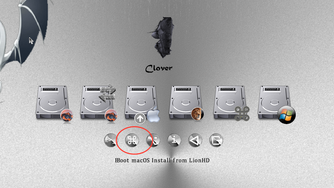

Cyberdevs Posted June 13, 2017 Share Posted June 13, 2017 Hey guys, I'm using clover 4084 and I'm getting multiple boot entries. Does anyone else have this issue? Link to comment https://www.insanelymac.com/forum/topic/284656-clover-general-discussion/page/529/#findComment-2443796 Share on other sites More sharing options...
Needy Posted June 13, 2017 Share Posted June 13, 2017 Hey guys, I'm using clover 4084 and I'm getting multiple boot entries. Does anyone else have this issue? Hey there, Everything's fine here. Could you be more specific? Describe how to reproduce the issue. Furthermore, screenshots, boot log and config(gui and boot sections) would be of help. Link to comment https://www.insanelymac.com/forum/topic/284656-clover-general-discussion/page/529/#findComment-2443863 Share on other sites More sharing options...
Cyberdevs Posted June 13, 2017 Share Posted June 13, 2017 Hey there, Everything's fine here. Could you be more specific? Describe how to reproduce the issue. Furthermore, screenshots, boot log and config(gui and boot sections) would be of help. Hi @Needy, I'm not sure what exactly causes the issue, maybe it's simply that I'm mistaking but I've been trying to test macOS High Sierra and I've been installing it with different settings on different hard drives with different formats (APFS,HFS) And I have several boot entries. It's not big deal for me because I can simply remove them I just wanted to make sure that it's not a bug. As long as it is a single incident on my end it's ok but I just wanted to see if anybody else has came across the issue or not. Link to comment https://www.insanelymac.com/forum/topic/284656-clover-general-discussion/page/529/#findComment-2443874 Share on other sites More sharing options...

SavageAUS Posted June 14, 2017 Share Posted June 14, 2017 Hi @Needy, I'm not sure what exactly causes the issue, maybe it's simply that I'm mistaking but I've been trying to test macOS High Sierra and I've been installing it with different settings on different hard drives with different formats (APFS,HFS) And I have several boot entries. It's not big deal for me because I can simply remove them I just wanted to make sure that it's not a bug. As long as it is a single incident on my end it's ok but I just wanted to see if anybody else has came across the issue or not. I remember when this problem plagued our mainboard. I have not had this issue since updating to latest bios F21. Sent from my SM-G930F using Tapatalk Link to comment https://www.insanelymac.com/forum/topic/284656-clover-general-discussion/page/529/#findComment-2444093 Share on other sites More sharing options...
Slice Posted June 14, 2017 Share Posted June 14, 2017 Hey guys, I'm using clover 4084 and I'm getting multiple boot entries. Does anyone else have this issue? I remember when this problem plagued our mainboard. I have not had this issue since updating to latest bios F21. Sent from my SM-G930F using Tapatalk Yes, for Gigabyte Z170 motherboard it is the solution but I hate BIOS F21, I want F5. For entries to not duplicate me and you have to delete file /EFI/BOOT/BOOTX64.EFI But sure to have /EFI/CLOVER/CLOVERX64.EFI to be in BIOS BOOT MENU This button will help you Link to comment https://www.insanelymac.com/forum/topic/284656-clover-general-discussion/page/529/#findComment-2444145 Share on other sites More sharing options...
Cyberdevs Posted June 14, 2017 Share Posted June 14, 2017 I remember when this problem plagued our mainboard. I have not had this issue since updating to latest bios F21. Sent from my SM-G930F using Tapatalk Yes, for Gigabyte Z170 motherboard it is the solution but I hate BIOS F21, I want F5. For entries to not duplicate me and you have to delete file /EFI/BOOT/BOOTX64.EFI But sure to have /EFI/CLOVER/CLOVERX64.EFI to be in BIOS BOOT MENU This button will help you main2.png Hi guys, Thanks for the replies but the weird thing is that the multiple boot entries is not happening to my Gaming 5 mobo it's happening to my Asus P8H77 Link to comment https://www.insanelymac.com/forum/topic/284656-clover-general-discussion/page/529/#findComment-2444151 Share on other sites More sharing options...
