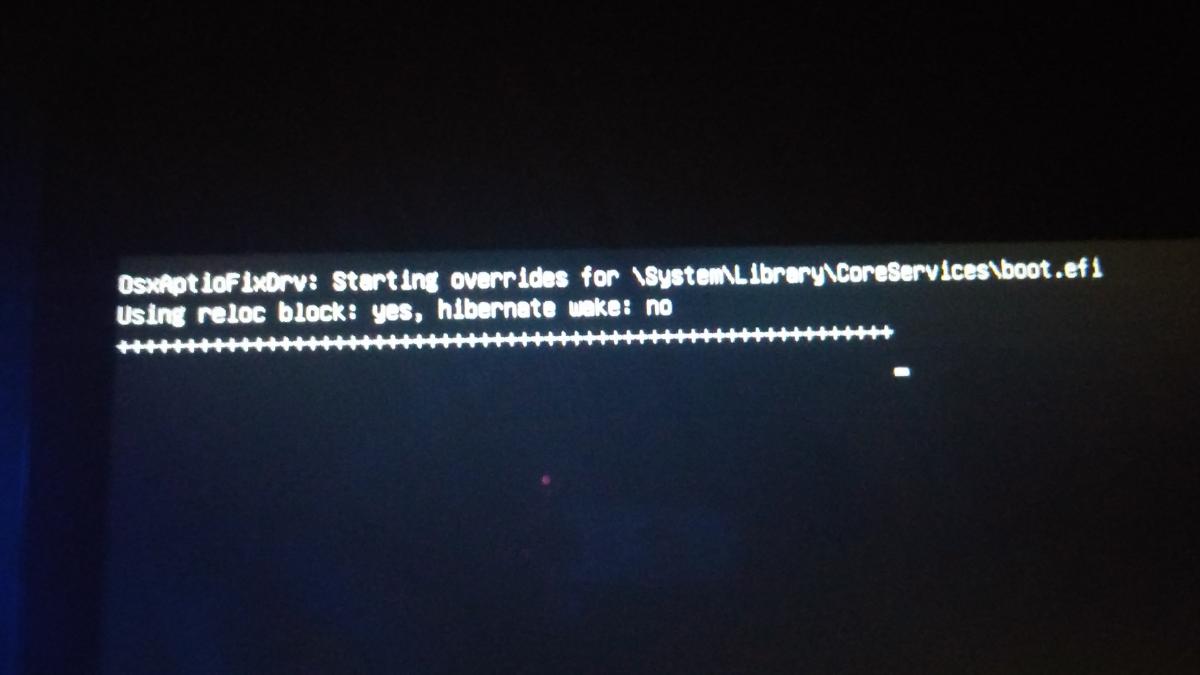

gujiangjiang Posted May 21, 2017 Share Posted May 21, 2017 i tested all today i mentioned this ------------------------------------ i tested many times. seems to get no memory error now. but i can't pass kernel log with -v Ram 8(4x2) dual channel 2. And dimm0,2 but onboard ram ------> i used only OsxAptioFix2Drv-free2000.efi. no problem, -x, -v boot also my laptop has similar issue. i used aptiofixv2 here normal boot no problem. just can't boot if i use -x boot arg ------> i used only OsxAptioFix2Drv-free2000.efi. i can boot -x and -v boot. ------------------------------------ But i dont suggest osxaptiofree2000 because this driver is not same with osxaptiov2. It has changed many code and we dont know. 从我的 iPhone 发送,使用 Tapatalk Link to comment https://www.insanelymac.com/forum/topic/284656-clover-general-discussion/page/516/#findComment-2428878 Share on other sites More sharing options...
Sherlocks Posted May 21, 2017 Share Posted May 21, 2017 But i dont suggest osxaptiofree2000 because this driver is not same with osxaptiov2. It has changed many code and we dont know. 从我的 iPhone 发送,使用 Tapatalk Yes. Just report that shown best result.If get idea from free2000, will help it. Now, i never get failed boot with memory error. 나의 LG-F410S 의 Tapatalk에서 보냄 Link to comment https://www.insanelymac.com/forum/topic/284656-clover-general-discussion/page/516/#findComment-2428883 Share on other sites More sharing options...
tluck Posted May 21, 2017 Share Posted May 21, 2017 hmm interesting... i had not tested -x in a while on my T460 SKL so i thought i would try: - OsxAptioFix2Drv will NOT boot -x -v - OsxAptioFixDrv does boot -x -v Link to comment https://www.insanelymac.com/forum/topic/284656-clover-general-discussion/page/516/#findComment-2428914 Share on other sites More sharing options...

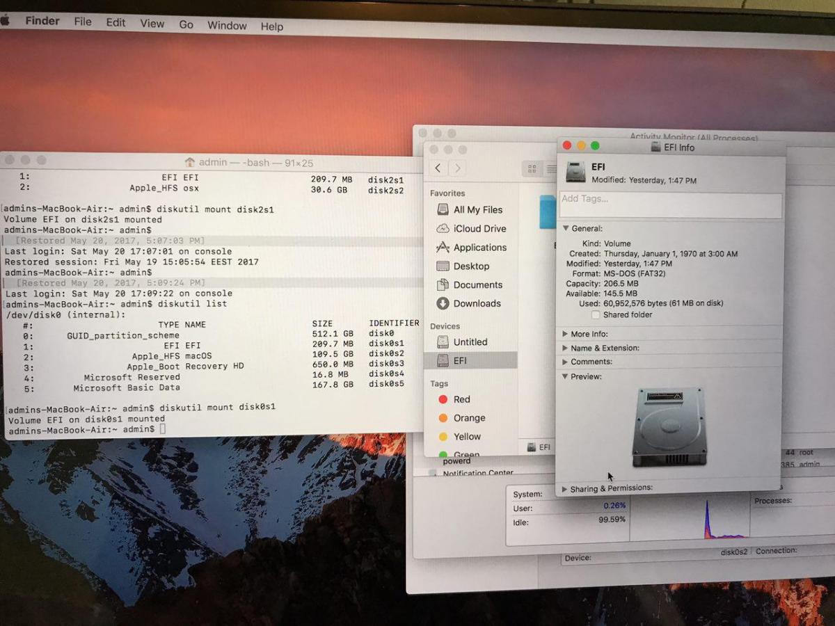

nrudnyk Posted May 22, 2017 Share Posted May 22, 2017 Hi, Guys. I have a problem with clover. I can't dump my ACPI DSDT's using f4, or via f1 menu manually selecting that option. As well as I can't dump log using f2.... I do have EFI partition in FAT32, so I don't know what else could be wrong. I create usb drive as in the following post I used GPT to install osx on my nvme drive, but dumping neither work from usb not from ssd drive... Is there anything I can do? Link to comment https://www.insanelymac.com/forum/topic/284656-clover-general-discussion/page/516/#findComment-2429244 Share on other sites More sharing options...
nrudnyk Posted May 22, 2017 Share Posted May 22, 2017 i've just tried v3998, and it does work.should be some kind of a regression in newer version... Link to comment https://www.insanelymac.com/forum/topic/284656-clover-general-discussion/page/516/#findComment-2429280 Share on other sites More sharing options...
nrudnyk Posted May 22, 2017 Share Posted May 22, 2017 it must be something with my keyboard, because it doesn't work from f1 menu, but does work using f4 directly from external keyboard... so it looks that this is solved for me, thanks Link to comment https://www.insanelymac.com/forum/topic/284656-clover-general-discussion/page/516/#findComment-2429301 Share on other sites More sharing options...
