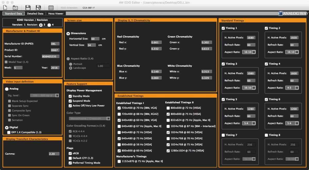

pkdesign Posted October 30, 2016 Share Posted October 30, 2016 Hi, may be this what you are looking for? Tried that, have no clue how to use it. This is what the EDID file looks like when opened. It would seem that those timings are already there in EDID as it is. Directions don’t help much either. I've attached the EDID as pulled which shows some "detailed timings" as 1920x1080. Doesn't this mean that he EDID already has that timing in it? EDID.txt Link to comment https://www.insanelymac.com/forum/topic/284656-clover-general-discussion/page/459/#findComment-2310358 Share on other sites More sharing options...
wastez Posted October 31, 2016 Share Posted October 31, 2016 @ pkdesign If the EDID is correct it could be that your graphicscard doesn´t has the correct VESA Mode in vbios. The easiest way to solve it would be to use on the fly patching via clover. First you can try to use the automatic mode, the keys name is PatchVBios. Link to comment https://www.insanelymac.com/forum/topic/284656-clover-general-discussion/page/459/#findComment-2310738 Share on other sites More sharing options...

pkdesign Posted October 31, 2016 Share Posted October 31, 2016 @ pkdesign If the EDID is correct it could be that your graphicscard doesn´t has the correct VESA Mode in vbios. The easiest way to solve it would be to use on the fly patching via clover. First you can try to use the automatic mode, the keys name is PatchVBios. Thanks but I have tried those things. You are right, the VBIOS does not have the correct VESA, but I have tried PatchVBios alone and with the EDID injected and still have no native resolution. Attached is prebootlog with PatchVBios and Custom EDID in config. preboot_log.txt Link to comment https://www.insanelymac.com/forum/topic/284656-clover-general-discussion/page/459/#findComment-2310981 Share on other sites More sharing options...
