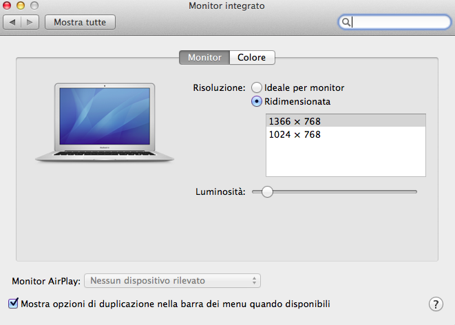

bajito93 Posted November 20, 2013 Share Posted November 20, 2013 I have the same black screen problem if you goes to system preferences, screen, you can change the rotate or the refresh scale? My os x not recognize my internal screen only the external with the HDMI, the black screen problem happened when system load capri.kext Send my your dsdt and fix the black screen problem Link to comment https://www.insanelymac.com/forum/topic/283038-asus-zenbook-prime-ux31a-db51-ultrabook-fixes-mods-tweaks-etc/page/30/#findComment-1970064 Share on other sites More sharing options...
berny_ Posted November 20, 2013 Share Posted November 20, 2013 I have the same black screen problem if you goes to system preferences, screen, you can change the rotate or the refresh scale? My os x not recognize my internal screen only the external with the HDMI, the black screen problem happened when system load capri.kext Send my your dsdt and fix the black screen problem This is what I see in System Preferences This is my dsdt, I'm not sure it's good, if you think is your best please attach it. DSDT.aml.zip If you are able to do so you can solve the other problems? thank you very much Link to comment https://www.insanelymac.com/forum/topic/283038-asus-zenbook-prime-ux31a-db51-ultrabook-fixes-mods-tweaks-etc/page/30/#findComment-1970067 Share on other sites More sharing options...
bajito93 Posted November 20, 2013 Share Posted November 20, 2013 I'm busy but when I have some time I fix your dsdt I have the same system preference screen, os x not recognize the display "unknown monitor" i believe if os x identify the display the black screen problem fix Link to comment https://www.insanelymac.com/forum/topic/283038-asus-zenbook-prime-ux31a-db51-ultrabook-fixes-mods-tweaks-etc/page/30/#findComment-1970072 Share on other sites More sharing options...

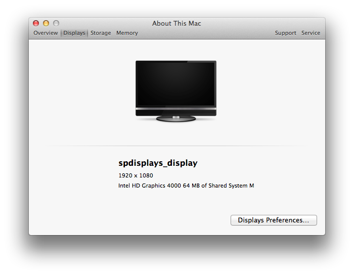

pavn Posted November 30, 2013 Share Posted November 30, 2013 Update: I am able to boot without -x (safe mode) now. I removed all of the following kexts. Booted in single user mode (press space bar in Clover or down arrow key in Chameleon)fsck -fymount -uw /mkdir /kext_backupcd /System/Library/Extensionsmv AppleIntelHD* AppleIntelSNB* AppleIntelFramebuffer* AMDRadeon* ATI* GeForce* NVDA* /kext_backuprm ../Caches/com.apple.kext.caches/Startup/kernelcachereboot I continue now with tuning of the OS X installation in normal mode. Will keep you updated. Link to comment https://www.insanelymac.com/forum/topic/283038-asus-zenbook-prime-ux31a-db51-ultrabook-fixes-mods-tweaks-etc/page/30/#findComment-1972503 Share on other sites More sharing options...
pavn Posted November 30, 2013 Share Posted November 30, 2013 Still GUI is sluggish performance. Display is: spdisplays_display . See attached screenshot. Audio works for me. And audio f keys controls. Brightness f keys controls does work yet. Etc. Internet via network cable works. Bluetooth works. What I would like to fix is GUI sluggish performance. Any hint? Link to comment https://www.insanelymac.com/forum/topic/283038-asus-zenbook-prime-ux31a-db51-ultrabook-fixes-mods-tweaks-etc/page/30/#findComment-1972517 Share on other sites More sharing options...
pavn Posted November 30, 2013 Share Posted November 30, 2013 If AppleIntelHD4000Graphics.kext and AppleIntelFramebufferCapri.kext is used, OS X does not boot, it stops in boot indefinetely. Could you advice how to get Intel HD 4000 Graphics to get work, please? Link to comment https://www.insanelymac.com/forum/topic/283038-asus-zenbook-prime-ux31a-db51-ultrabook-fixes-mods-tweaks-etc/page/30/#findComment-1972542 Share on other sites More sharing options...
pavn Posted November 30, 2013 Share Posted November 30, 2013 I use all the kext provided. You Clover configuration with clover boot loader. But I am unable to get to work my Intel HD 4000 graphics card to work. If the kexts are in /System/Extensions , it simply does not boot to OS X. ( AppleIntelHD4000Graphics.kext and AppleIntelFramebufferCapri.kext ) Could you advice how to get it work? I can boot to OS X with -x . Did you patched your DSDT.aml? I use 68x DSDT and SSDT files, since 68x has Asus Zenbook UX32VD as I have. But my is detected as UX32VDA. But it worked more or less for OS X 10.8.5. Fully work with 10.9 (except SD Card Reader). Can update from App Store like Real Macbook. UX31A.zip Link to comment https://www.insanelymac.com/forum/topic/283038-asus-zenbook-prime-ux31a-db51-ultrabook-fixes-mods-tweaks-etc/page/30/#findComment-1972559 Share on other sites More sharing options...
pavn Posted December 1, 2013 Share Posted December 1, 2013 Can't get Intel Graphics HD4000 to work under 10.9. Link to comment https://www.insanelymac.com/forum/topic/283038-asus-zenbook-prime-ux31a-db51-ultrabook-fixes-mods-tweaks-etc/page/30/#findComment-1972769 Share on other sites More sharing options...
pavn Posted December 4, 2013 Share Posted December 4, 2013 Trying to get Intel HD 4000 graphics to work in acceleration mode QE CI in OS X 10.9 Mavericks. AppleIntelHD4000Graphics.kext is loaded properly. But the main kext files AppleIntelFramebufferCapri.kext and AppleIntelSNBGraphicsFB.kext are not. And are missing Info.plist files somehow. So they are not loaded. Even from fresh installation Extensions folder the Info.plist files are not there. The command: ioreg -l -p IODeviceTree returns: "AAPL,ig-platform-id" = <09006601> properly. GFX0@2 <class IOPCIDevice, id 0x1000001e3, registered, matched, acti$ | | | { | | | "acpi-device" = "IOACPIPlatformDevice is not serializable" | | | "AAPL,ig-platform-id" = <09006601> | | | "assigned-addresses" = <1010008200000000000040f70000000000004000181$ | | | "class-code" = <00000300> | | | "subsystem-vendor-id" = <6b100000> | | | "vendor-id" = <86800000> | | | "hda-gfx" = <"onboard-1"> | | | "IOMemoryDescriptorOptions" = 2048 | | | "IOName" = "display" | | | "AAPL,HasPanel" = <01000000> | | | "AAPL00,DualLink" = <01> | | | "pcidebug" = "0:2:0" | | | "display-connect-flags" = <00000000> | | | "AAPL,gray-value" = <00000000> | | | "IOInterruptControllers" = ("io-apic-0","IOPCIMessagedInterruptCont$ | | | "built-in" = <00> | | | "IOPCIResourced" = Yes | | | "AAPL,RegEntryID" = <007da00f80ffffffff825ff07f000000656d6953000000$ | | | "IODeviceMemory" = (({"address"=4148166656,"length"=4194304}),({"ad$ | | | "IOPowerManagement" = {"ChildrenPowerState"=2,"CurrentPowerState"=2$ | | | "IOPMIsPowerManaged" = Yes | | | "name" = <"display"> | | | "subsystem-id" = <07150000> | | | "AAPL,ndrv-dev" = Yes | | | "AAPL,gray-page" = <01000000> | | | "model" = <"Intel HD Graphics 4000"> | | | "device_type" = <"display"> | | | "compatible" = <"pci1043,1507","pci8086,166","pciclass,030000","GFX$ | | | "IOHibernateState" = <00000000> | | | "attached-gpu-control-path" = "IOService:/AppleACPIPlatformExpert/P$ | | | "reg" = <0010000000000000000000000000000000000000101000020000000000$ | | | "device-id" = <66010000> | | | "revision-id" = <09000000> | | | "IOInterruptSpecifiers" = (<1000000007000000>,<0000000000000100>) | | | "AAPL,iokit-ndrv" = <f05c27817fffffff> | | | "acpi-path" = "IOACPIPlane:/_SB/PCI0@0/GFX0@20000" | | | } Could you help me? AppleIntelFramebufferCapri.kext has no Info.plist file. AppleIntelSNBGraphicsFB.kext has no Info.plist file. Link to comment https://www.insanelymac.com/forum/topic/283038-asus-zenbook-prime-ux31a-db51-ultrabook-fixes-mods-tweaks-etc/page/30/#findComment-1973566 Share on other sites More sharing options...
pavn Posted December 4, 2013 Share Posted December 4, 2013 Got my Intel HD 4000 graphics card to work with QE / CI! Thanks to this guide! http://olarila.com/forum/viewtopic.php?f=28&t=3111 Trying to get Intel HD 4000 graphics to work in acceleration mode QE CI in OS X 10.9 Mavericks. AppleIntelHD4000Graphics.kext is loaded properly. But the main kext files AppleIntelFramebufferCapri.kext and AppleIntelSNBGraphicsFB.kext are not. And are missing Info.plist files somehow. So they are not loaded. Even from fresh installation Extensions folder the Info.plist files are not there. The command: ioreg -l -p IODeviceTree returns: "AAPL,ig-platform-id" = <09006601> properly. GFX0@2 <class IOPCIDevice, id 0x1000001e3, registered, matched, acti$ | | | { | | | "acpi-device" = "IOACPIPlatformDevice is not serializable" | | | "AAPL,ig-platform-id" = <09006601> | | | "assigned-addresses" = <1010008200000000000040f70000000000004000181$ | | | "class-code" = <00000300> | | | "subsystem-vendor-id" = <6b100000> | | | "vendor-id" = <86800000> | | | "hda-gfx" = <"onboard-1"> | | | "IOMemoryDescriptorOptions" = 2048 | | | "IOName" = "display" | | | "AAPL,HasPanel" = <01000000> | | | "AAPL00,DualLink" = <01> | | | "pcidebug" = "0:2:0" | | | "display-connect-flags" = <00000000> | | | "AAPL,gray-value" = <00000000> | | | "IOInterruptControllers" = ("io-apic-0","IOPCIMessagedInterruptCont$ | | | "built-in" = <00> | | | "IOPCIResourced" = Yes | | | "AAPL,RegEntryID" = <007da00f80ffffffff825ff07f000000656d6953000000$ | | | "IODeviceMemory" = (({"address"=4148166656,"length"=4194304}),({"ad$ | | | "IOPowerManagement" = {"ChildrenPowerState"=2,"CurrentPowerState"=2$ | | | "IOPMIsPowerManaged" = Yes | | | "name" = <"display"> | | | "subsystem-id" = <07150000> | | | "AAPL,ndrv-dev" = Yes | | | "AAPL,gray-page" = <01000000> | | | "model" = <"Intel HD Graphics 4000"> | | | "device_type" = <"display"> | | | "compatible" = <"pci1043,1507","pci8086,166","pciclass,030000","GFX$ | | | "IOHibernateState" = <00000000> | | | "attached-gpu-control-path" = "IOService:/AppleACPIPlatformExpert/P$ | | | "reg" = <0010000000000000000000000000000000000000101000020000000000$ | | | "device-id" = <66010000> | | | "revision-id" = <09000000> | | | "IOInterruptSpecifiers" = (<1000000007000000>,<0000000000000100>) | | | "AAPL,iokit-ndrv" = <f05c27817fffffff> | | | "acpi-path" = "IOACPIPlane:/_SB/PCI0@0/GFX0@20000" | | | } Could you help me? AppleIntelFramebufferCapri.kext has no Info.plist file. AppleIntelSNBGraphicsFB.kext has no Info.plist file. Link to comment https://www.insanelymac.com/forum/topic/283038-asus-zenbook-prime-ux31a-db51-ultrabook-fixes-mods-tweaks-etc/page/30/#findComment-1973589 Share on other sites More sharing options...

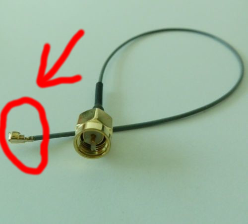

pavn Posted December 13, 2013 Share Posted December 13, 2013 This connector fits to Atheros AR5B195 WiFi WLAN Bluetooth Combo Half Mini PCI-E Card. Would this connector work to make an adapter for Wifi antenna for exchanged Wifi cards? http://www.ebay.com/itm/150946310965?ssPageName=STRK:MEWAX:IT&_trksid=p3984.m1423.l2649 Now the question is where to find connector which fits Asus Zenbook antenna? To make (solder) an adapter. Link to comment https://www.insanelymac.com/forum/topic/283038-asus-zenbook-prime-ux31a-db51-ultrabook-fixes-mods-tweaks-etc/page/30/#findComment-1975461 Share on other sites More sharing options...
ninditsu Posted December 15, 2013 Share Posted December 15, 2013 @pavn I think you can donate the connectors from the original intel card. but I suspect the connector you need is a female w.fl to male u.fl Link to comment https://www.insanelymac.com/forum/topic/283038-asus-zenbook-prime-ux31a-db51-ultrabook-fixes-mods-tweaks-etc/page/30/#findComment-1976055 Share on other sites More sharing options...
bajito93 Posted December 23, 2013 Share Posted December 23, 2013 This is what I see in System Preferences Schermata 2013-11-20 alle 20.50.55.png This is my dsdt, I'm not sure it's good, if you think is your best please attach it. DSDT.aml.zip If you are able to do so you can solve the other problems? thank you very much I fix your keyboard light with 68x's instruction, sorry for the wait. DSDT-fixed.aml.zip 1 Link to comment https://www.insanelymac.com/forum/topic/283038-asus-zenbook-prime-ux31a-db51-ultrabook-fixes-mods-tweaks-etc/page/30/#findComment-1978293 Share on other sites More sharing options...
pavn Posted December 26, 2013 Share Posted December 26, 2013 Female u.fl is what I have and I can connect it to replaced WIFI card. Now I need to find out what connector is needed to connect to antenna cable. It needs to be male. Maybe w.fl you mentioned? @pavn I think you can donate the connectors from the original intel card. but I suspect the connector you need is a female w.fl to male u.fl Link to comment https://www.insanelymac.com/forum/topic/283038-asus-zenbook-prime-ux31a-db51-ultrabook-fixes-mods-tweaks-etc/page/30/#findComment-1979080 Share on other sites More sharing options...
bajito93 Posted December 26, 2013 Share Posted December 26, 2013 if you want wifi on the zenbook, you need to buy a internal wifi car (AR5B195). You need to mod the wifi card connectors, remove the circles, and when you finished you only have a little film connector on the wifi card, now you can connect the antenna with the wifi card, i suggest put some insulating tape to better hold connectors. Some page ago, you can read some more information. Link to comment https://www.insanelymac.com/forum/topic/283038-asus-zenbook-prime-ux31a-db51-ultrabook-fixes-mods-tweaks-etc/page/30/#findComment-1979089 Share on other sites More sharing options...
pavn Posted December 27, 2013 Share Posted December 27, 2013 Yes, I did the suggested thing with Atheros AR9285 with circles partly removed to simplify the process. I am not completely happy with the process. Unfortunately I think I broke connectors on leads the way I will not be able to connect the Intel Wifi card if needed in the future easily now. I am not completely sure if the antenna connectors are connected optimally. I used hot glue gun to hold the leads on the AR9285 Wifi card. What is the maximum speed you get and how far can you go? I am trying to find out if it antenna leads are connected properly to the Wifi card. Now I am also trying to find out how to resolve issue with iMessage, FaceTime, iCloud to be able to connect there? Link to comment https://www.insanelymac.com/forum/topic/283038-asus-zenbook-prime-ux31a-db51-ultrabook-fixes-mods-tweaks-etc/page/30/#findComment-1979175 Share on other sites More sharing options...
