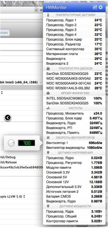

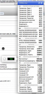

For fan speeds to be reported by FakeSMC you must add this DSDT device:
                Device (SMCD)
                    Name (_HID, "FAN00000")  // _HID: Hardware ID
                    Method (FAN0, 0, NotSerialized)
                        Store (\_SB.PCI0.LPCB.EC0.TACH (Zero), Local0)
                        Return (Local0)
                    Name (TACH, Package (0x02)
                        "System Fan",
                        "FAN0"
FakeSMC will display the fan speed in RPMs. Credit goes to Rehabman for the FakeSMC fix.

This worked perfectly, thank you! I was wondering why we didn't get any fan speed measurements at all. This did the trick!

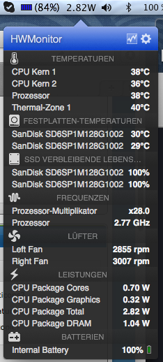

Hi 68x,
Im Using a UX301LA, i've got my fans working too, since rehab released his patch for the hp xD
and modified my code, and rehab asked me, i should look in this thread :-)
I found out you are using exactly the same code xD
Here is my Code (i Have 2 fans, and one chip "i7-4558u+Iris5100"):
    Device (SMCD)
        Name (TACH, Package (0x04)
            "Left Fan", "FAN1",
            "Right Fan", "FAN0"
            Return (Local0)
        Method (FAN1, 0, NotSerialized)
            Store (\_SB.PCI0.LPCB.EC0.TACH (One), Local0)
            Return (Local0)
And so far its working very well :-)
I attached a picture at the buttom :-)

How the fan control from FakeSMC is working on the picture of my previous post?
Only with the LPC devices, that are supported in hwmon?
There is really not much support for laptops...
