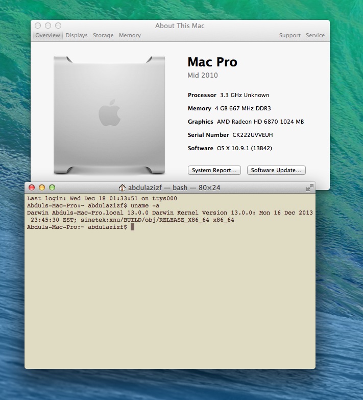

running on an athlon II X4 620 everythings works now with sinetek's v4 kernel.
no pink icons, no icon glitches, no pink PNGs nor TIFFs
furthermore the system is faster and iTunes isn't laggy any more,
well {censored} done sinetek, now the system is fully usable.

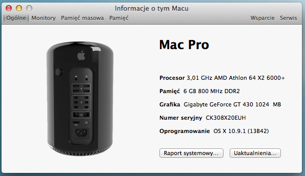

You gave me an idea with tscsync. It looks like it isn't implemented in the v4_kernel - this is my opinion. On mine Athlon there was a lot of glitches, freezes with v4_kernel - on Bronzovkas kernels I haven't got that issues.
But!!! I installed the VoodooTSCSyncAMD.kext in Extra, run MyFix with MyHack.app and restart the PC. Now it's working perfectly, fast, no glitches, no freezes, no pink icons, no icon bug :)

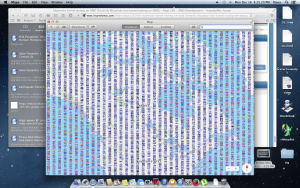

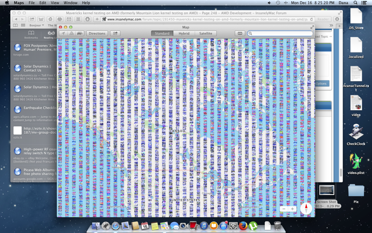

RUNNING BOTH CORES AND CLOCK RUNNING CRAZY AGAIN...
CPU=1 CLOCK IS STABLE AND ACCURATE...
MAPS STILL DISTORTED...
OTHERWISE FAST AND STABLE...
FOR NOW IT'S GOOD!
JUST NEEDS BIT MORE TWEAKS....
CLOCK WAS OK, BUT JUMPED BACK 1 HOUR....NOW LOSING TIME...WILL GO BACK TO CPUS=1

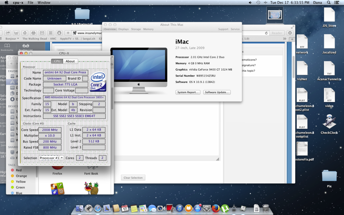

IS THERE A NEWER VERSION OF TSCSYNCHAMD.KEXT OUT THERE??
CLOCK IS RUNNING BACKWARDS.....WITH 2 CORES
CPU IS AMD X2 64 2800+ FAMILY 15
OOPS SINETEK AMD X2 64 3800+ FAMILY 15
Have you set TSCSync with the correct amount of cores??
