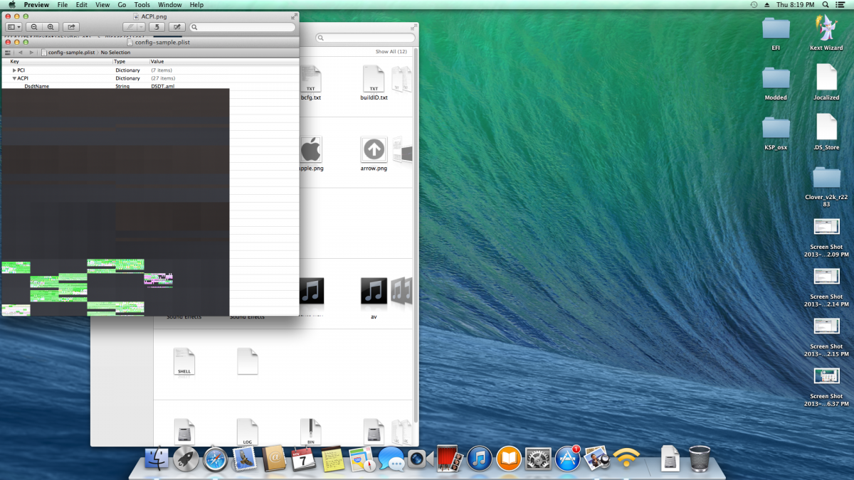

Sinetek Posted November 7, 2013 Share Posted November 7, 2013 @devsI still think it might be a problem with the cache. #commpage.c switch (cpu_info.cache_line_size) { case 128: bits |= kCache128; break; case 64: bits |= kCache64; break; case 32: bits |= kCache32; break; default: break; } maybe try forcing 128B cacheline size? or maybe even disabling all caches to test (machine will be VERY SLOW) 2 Link to comment Share on other sites More sharing options...

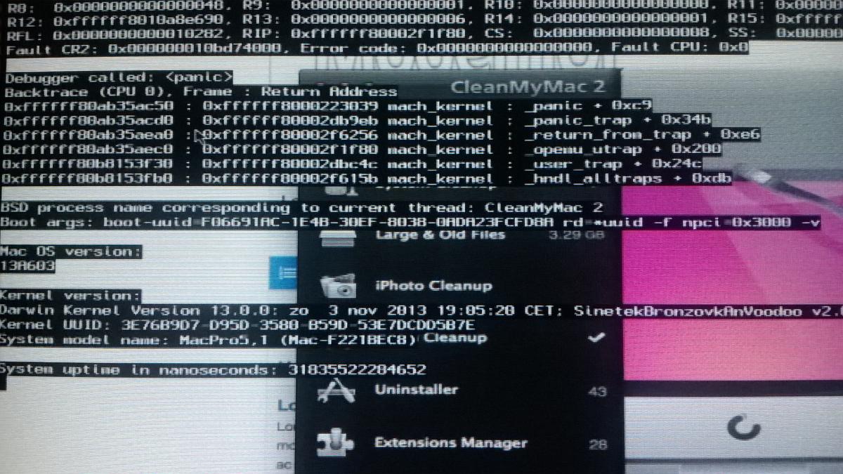

Shaneee Posted November 7, 2013 Share Posted November 7, 2013 Get this KP every time I close CleanMyMac. Never had the problem before. opemu? Link to comment Share on other sites More sharing options...
Andy Vandijck Posted November 7, 2013 Share Posted November 7, 2013 Get this KP every time I close CleanMyMac. Never had the problem before. opemu? WP_20131107_001.jpg Which kernel is it?Could you test with the kernel in the PM pack? I'll try to trace it down. Link to comment Share on other sites More sharing options...
Shaneee Posted November 7, 2013 Share Posted November 7, 2013 Which kernel is it? Could you test with the kernel in the PM pack? I'll try to trace it down. Do I need the system.kext as well if I'm not using the app? Link to comment Share on other sites More sharing options...
Andy Vandijck Posted November 7, 2013 Share Posted November 7, 2013 Do I need the system.kext as well if I'm not using the app?You need the System.kext for VoodooPState.kext to work... Link to comment Share on other sites More sharing options...
Shaneee Posted November 7, 2013 Share Posted November 7, 2013 You need the System.kext for VoodooPState.kext to work... Works fine with the kernel in the PM pack. Not using the system.kext as I don't use VoodooPState. Edit: After running a full clean my whole PC froze upon closing it. No HDD activity just froze. No log for it 1 Link to comment Share on other sites More sharing options...

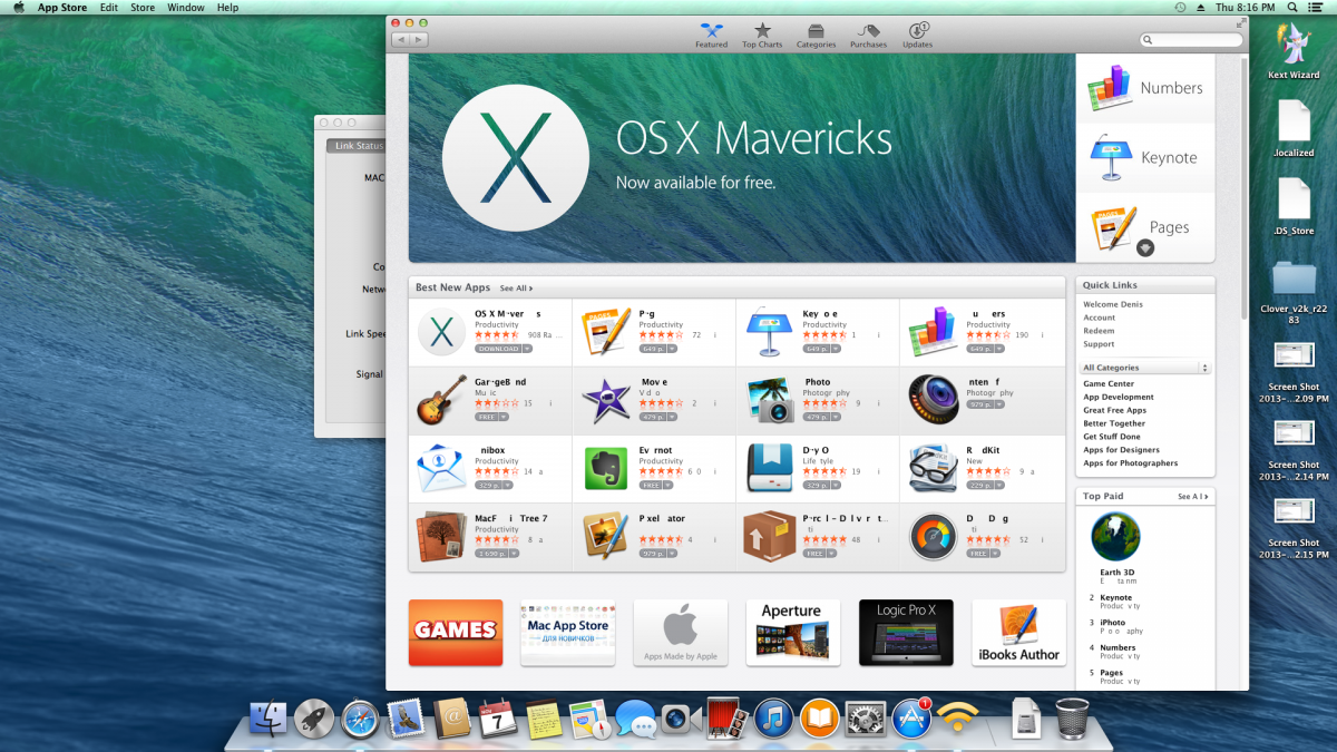

denisrus Posted November 7, 2013 Share Posted November 7, 2013 Using latest Bronya kernel I have issues with text in Safari, Appstore and other apps. This bug is also in photo preview. I read a lot information (in this topic and many others) but I didn't find answer why it's appearing. Changing AMD framebuffers in clover didn't helped. Injecting my graphic card id also didn't help. But QE/CI and OpenGL are working. So is it a kernel bug or wrong framebuffer? Or something else? Or may be modding a vbios to support uefi gop will help? I attach a crash log file that was generated when I opened a photo in stock preview app (in .zip file .crash file (when uploading .crash file I've got a message that uploading this type of file isn't permitted)). Hardware: Motherboard: ASRock 970 Extreme 3 CPU: AMD FX-8320 VIDEO: Sapphire AMD HD Radeon 7870 Dual-X (HDMI connection to monitor) RAM: Corsair XMS3 4GB (1ps) Preview Crash File.zip Link to comment Share on other sites More sharing options...

Sinetek Posted November 7, 2013 Share Posted November 7, 2013 yeah, I confirm the graphics problems are due to caching issues. on AMD there are a few more MSR's controlling caching and so on, SYSCFG TOP_MEM2TOP_MEM1unfortunately I haven't found the right combination yet, but disabling the caches entirely, the nvidia driver works. 7 Link to comment Share on other sites More sharing options...
theconnactic Posted November 7, 2013 Author Share Posted November 7, 2013 That explains why the dumps from previous sessions when trying to boot to nVidia (and sometimes ATI, at least when WindowServer initializes) yeah, I confirm the graphics problems are due to caching issues. on AMD there are a few more MSR's controlling caching and so on, SYSCFG TOP_MEM2TOP_MEM1unfortunately I haven't found the right combination yet, but disabling the caches entirely, the nvidia driver works. under ML or Mavericks. P.S.: deleted support request post from another user: this topic is not the appropriate place. Link to comment Share on other sites More sharing options...
