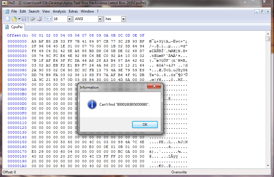

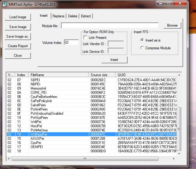

oSxFr33k Posted October 21, 2011 Share Posted October 21, 2011 @^Andy^, Hi Andy I had a couple questions for you on the Bios Hack. I have an Asus Gamers Laptop G74SX with the same issue the APTIO EFI Bios Lock on Speedstep. I have a couple of screenshots showing that this string cannot be found in my CpuPei and I don't have a second module remotely similar to the ones you posted only the CpuPei. I have also attached my rom from Asus website to see if anyone can clue me in on what string I may need to change or how I can figure out what the string in my Bios needs to be changed to? I apologize if this seems like hijacking your thread and if I did please forgive me and let me know and direct me to the proper thread for this. I did search and came up with nothing for my Laptop and somewhat desperate!! I am using the mmtool as you can see on my screenshot and I am unsure if my EFI is the newer 8GB or 4GB have to find out. I also read that using the phoenix tools is necessary for the newer and larger sized ROm only correct? Is there some danger in writing back to modules with the Phoenix tool versus the mmtool? I read this somewhere that something gets changed when written back to the rom which may cause problems?he past with assemblers I have dwelled in the past with disassemblers and debuggers way back so I dunno if this is where I have t start and have no idea how to start to find out what string needs to be modified? G74SxAS203.zip Thanks again. Link to comment https://www.insanelymac.com/forum/topic/261312-p8p67pro-and-non-pro-lion-install-usb-for-dummies/page/14/#findComment-1763097 Share on other sites More sharing options...
^Andy^ Posted October 21, 2011 Author Share Posted October 21, 2011 @^Andy^, Hi Andy I had a couple questions for you on the Bios Hack. I have an Asus Gamers Laptop G74SX with the same issue the APTIO EFI Bios Lock on Speedstep. I have a couple of screenshots showing that this string cannot be found in my CpuPei and I don't have a second module remotely similar to the ones you posted only the CpuPei. I have also attached my rom from Asus website to see if anyone can clue me in on what string I may need to change or how I can figure out what the string in my Bios needs to be changed to? I apologize if this seems like hijacking your thread and if I did please forgive me and let me know and direct me to the proper thread for this. I did search and came up with nothing for my Laptop and somewhat desperate!! I am using the mmtool as you can see on my screenshot and I am unsure if my EFI is the newer 8GB or 4GB have to find out. I also read that using the phoenix tools is necessary for the newer and larger sized ROm only correct? Is there some danger in writing back to modules with the Phoenix tool versus the mmtool? I read this somewhere that something gets changed when written back to the rom which may cause problems?he past with assemblers I have dwelled in the past with disassemblers and debuggers way back so I dunno if this is where I have t start and have no idea how to start to find out what string needs to be modified? G74SxAS203.zip Thanks again. Sorry oSxFr33k but I can't help you. There is no way I can test or verify any bios hacks on hardware that I dont own and due to the rather severe implications of getting it wrong (i.e. bricked laptop or pc) I wont even try - sorry mate :S Just to be on the safe side (and for curiosity), I de-compiled the modified bios modules and checked their assembly code, and the changes are very little: Before the patch it changes the value of the 15th bit of accumulator eax to 1, which seem to be the lock method, after the patch this value remains as it is. loc_FFFF0953: movzx eax, al or eax, 6000400h cmp [ebp+var_1], bl jz short loc_FFFF096D cmp [ebp+var_2], 4 jbe short loc_FFFF0972 or eax, 18008000h ; <---- after the patch this becomes 18000000h jmp short loc_FFFF0972 loc_FFFF096D: or eax, 8000h ; <---- after the patch this becomes 0 loc_FFFF0972: push 0FFFFFFFFh push 0FFFFFFF8h push ebx push eax push esi call sub_FFFF195C add esp, 14h test byte ptr [ebp+var_8+2], 0Fh pop esi pop ebx jz short loc_FFFF098D mov al, 2 jmp short loc_FFFF0994 I'm not entirely sure what you are getting at, all I can say is that the modified bios works for me. Link to comment https://www.insanelymac.com/forum/topic/261312-p8p67pro-and-non-pro-lion-install-usb-for-dummies/page/14/#findComment-1763114 Share on other sites More sharing options...
