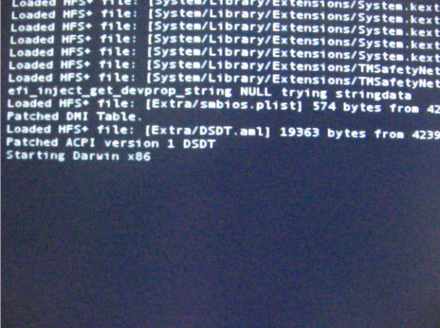

MOmann Posted October 12, 2011 Share Posted October 12, 2011 tried it.. "Wating for root device" after reboot. Had to restore a backup. Anybody experienced the same problem? Link to comment https://www.insanelymac.com/forum/topic/259068-guide-a-fast-and-easy-way-to-install-lion/page/20/#findComment-1759049 Share on other sites More sharing options...
tokra128 Posted October 13, 2011 Share Posted October 13, 2011 Hi guys... what I did .... first, install chimera (it will allow you to use facetime and icloud) - you will get rid of still waiting for root device, then apply the 10.7.2 update ... For sound you have to patch manually the applehda.. MAybe someone can mace a script for us for sound (for p35 - ds4 I mean)! Link to comment https://www.insanelymac.com/forum/topic/259068-guide-a-fast-and-easy-way-to-install-lion/page/20/#findComment-1759148 Share on other sites More sharing options...

clarktim Posted October 13, 2011 Share Posted October 13, 2011 Loaded Lion using the USB method here. Install went pretty smooth actually. I let the installer make a DSDT.aml for me instead of using my old one. I wanted to see if it worked any better. Well, it works fine. Very cool indeed. First boot stopped at 'waiting for root device'. Upgraded to Chameleon v2.1svn r1547 (found in a post somewhere on this board, can't remember where) Reboot works fine now. (I removed the verbose boot from the Boot.plist and added a wait time so it would auto boot) Video is working fine. on-board sound does not work. Always problems with that. So I use a USB sound device. Works through every upgrade. Used software update to install 10.7.2 - no issues Lion "seems" to be much more responsive for me. Windows open quicker. (could be just my imagination) All-in-all an excellent load. Many thanks to tseug! It worked awesome! Link to comment https://www.insanelymac.com/forum/topic/259068-guide-a-fast-and-easy-way-to-install-lion/page/20/#findComment-1759310 Share on other sites More sharing options...

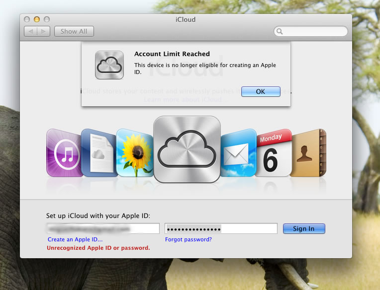

gnomme Posted October 19, 2011 Share Posted October 19, 2011 Any luck with iCloud on GA P35 DS4? I can't login in iCloud... Link to comment https://www.insanelymac.com/forum/topic/259068-guide-a-fast-and-easy-way-to-install-lion/page/20/#findComment-1762378 Share on other sites More sharing options...
nathandw Posted October 20, 2011 Share Posted October 20, 2011 Yep, no problems with iCloud after initial problems. iCloud wouldn't accept like another account from this computer or so. Download Chameleon Wizard and get yourself a new SN in your smbios.plist. The generator will do this for you. After that everything's working jsut fine. Link to comment https://www.insanelymac.com/forum/topic/259068-guide-a-fast-and-easy-way-to-install-lion/page/20/#findComment-1762490 Share on other sites More sharing options...
Narayana Posted October 20, 2011 Share Posted October 20, 2011 Hello- I am looking to install OS X on my HTPC when its target SSD arrives tomorrow. mp4 embedded sub support is poor in Windows and I would like to give plex a spin. The system configuration is as follows: GA-EP45T-USB3P Intel Core2Quad (Q8300) @ 2.5GHz Radeon 5770 (MSI Hawk R5770) I had a few questions regarding this installation method and would greatly appreciate some help: 1. DSDT.aml The changelog.txt states, "Implemented autogeneration of DSDT.aml. Should work for most motherboards similar to Gigabyte GA-P35-DS4." What is qualified as similar? The differences between the two boards (P35.. vs. EP45...) that I see are the northbridge (P35 vs. P45), southbridge (ICH9R vs. ICH10R), and the audio chipsets (ALC889A vs. ALC889). Is this sufficiently similar to correctly generate a new DSDT.aml file when running finalize? 2. Will I need different kexts for the ALC889 to work properly vs. the 889A ? Should I just use [url="http://www.insanelymac.com/forum/topic/279450-why-insanelymac-does-not-support-tonymacx86/"]#####[/url] to resolve this post-installation? Should I remove the 889A kexts from the ALC885_889A_LION folder before I proceed creating my boot drive? 3. Not sure 2 is really important as I plan to run audio through the HDMI on the 5770. Do the newer versions of Chameleon support sound through the 5770's HDMI? Or are DSDT changes still necessary to enable this? 4. I read that the version of Chameleon included with this package has problems with RAID installs. I have a 3ware 9650se-8lpml coming in the day after tomorrow that I plan to run a 5x1.5TB RAID 5 with. As this volume won't be my install volume, I should have no issues, right? 5. This question has nothing to do with the installation method, but just in case anyone knows: Will switching to AHCI mode on the SATA controller of my motherboard permanently break my current ICH10R array? Or will it come back when I go back to RAID mode (which seems to support AHCI disks on it)? Everything is backed up (hopefully!), so it's not too much of a concern. Thanks in advance and sorry for the many questions! Link to comment https://www.insanelymac.com/forum/topic/259068-guide-a-fast-and-easy-way-to-install-lion/page/20/#findComment-1762505 Share on other sites More sharing options...
gnomme Posted October 20, 2011 Share Posted October 20, 2011 Yep,no problems with iCloud after initial problems. iCloud wouldn't accept like another account from this computer or so. Download Chameleon Wizard and get yourself a new SN in your smbios.plist. The generator will do this for you. After that everything's working jsut fine. Are you shure you have a GA-P35 DS4??? I used the Chameleon Wizard as well but I still have no luck with iCloud. Can you post here your steps? Here is what I get: (see attachment) Link to comment https://www.insanelymac.com/forum/topic/259068-guide-a-fast-and-easy-way-to-install-lion/page/20/#findComment-1762539 Share on other sites More sharing options...
tseug Posted October 20, 2011 Author Share Posted October 20, 2011 Hello- I am looking to install OS X on my HTPC when its target SSD arrives tomorrow. mp4 embedded sub support is poor in Windows and I would like to give plex a spin. The system configuration is as follows: GA-EP45T-USB3P Intel Core2Quad (Q8300) @ 2.5GHz Radeon 5770 (MSI Hawk R5770) I had a few questions regarding this installation method and would greatly appreciate some help: 1. DSDT.aml The changelog.txt states, "Implemented autogeneration of DSDT.aml. Should work for most motherboards similar to Gigabyte GA-P35-DS4." What is qualified as similar? The differences between the two boards (P35.. vs. EP45...) that I see are the northbridge (P35 vs. P45), southbridge (ICH9R vs. ICH10R), and the audio chipsets (ALC889A vs. ALC889). Is this sufficiently similar to correctly generate a new DSDT.aml file when running finalize? "Similar" means: If it works it's similar. If it doesn't it's not. An incomplete but more specific answer can be found here. 2. Will I need different kexts for the ALC889 to work properly vs. the 889A ? Should I just use [url="http://www.insanelymac.com/forum/topic/279450-why-insanelymac-does-not-support-tonymacx86/"]#####[/url] to resolve this post-installation? Should I remove the 889A kexts from the ALC885_889A_LION folder before I proceed creating my boot drive? 3. Not sure 2 is really important as I plan to run audio through the HDMI on the 5770. Do the newer versions of Chameleon support sound through the 5770's HDMI? Or are DSDT changes still necessary to enable this? 4. I read that the version of Chameleon included with this package has problems with RAID installs. I have a 3ware 9650se-8lpml coming in the day after tomorrow that I plan to run a 5x1.5TB RAID 5 with. As this volume won't be my install volume, I should have no issues, right? 5. This question has nothing to do with the installation method, but just in case anyone knows: Will switching to AHCI mode on the SATA controller of my motherboard permanently break my current ICH10R array? Or will it come back when I go back to RAID mode (which seems to support AHCI disks on it)? Everything is backed up (hopefully!), so it's not too much of a concern. Thanks in advance and sorry for the many questions! With respect to your other questions I simply don't know. I know how to set up the system in my sig. That it works for other boards out of the box is just a happy coincidence. My intention with publishing the script was that it could be modified to support other hardware setups fairly easily. It's sort of a template script, if you will. Link to comment https://www.insanelymac.com/forum/topic/259068-guide-a-fast-and-easy-way-to-install-lion/page/20/#findComment-1762543 Share on other sites More sharing options...
tseug Posted October 20, 2011 Author Share Posted October 20, 2011 Are you shure you have a GA-P35 DS4??? I used the Chameleon Wizard as well but I still have no luck with iCloud. Can you post here your steps? Here is what I get: (see attachment) I just tried a clean install on a test partition. No issues with iCloud. Link to comment https://www.insanelymac.com/forum/topic/259068-guide-a-fast-and-easy-way-to-install-lion/page/20/#findComment-1762562 Share on other sites More sharing options...
nathandw Posted October 20, 2011 Share Posted October 20, 2011 Open Cham.Wiz. and click on SMBios in the menu. Then click on "modify" or so, I got the german translation, anyways, it's the button under the paypal icon. Choose a premade SMBios, the MacPro3,1. Then generate a serial number and click on "Copy". Your serial now moves to the right side. A click on "Save" will put the data in your smbios.plist. Reboot and enjoy iCloud. Well at least it worked for me... Link to comment https://www.insanelymac.com/forum/topic/259068-guide-a-fast-and-easy-way-to-install-lion/page/20/#findComment-1762580 Share on other sites More sharing options...
gnomme Posted October 20, 2011 Share Posted October 20, 2011 I just tried a clean install on a test partition. No issues with iCloud. But you customize your serial number and so with the wizard? Second, did you activate your iCloud account in a iPhone or genuine Mac first? Link to comment https://www.insanelymac.com/forum/topic/259068-guide-a-fast-and-easy-way-to-install-lion/page/20/#findComment-1762589 Share on other sites More sharing options...
tseug Posted October 20, 2011 Author Share Posted October 20, 2011 But you customize your serial number and so with the wizard?Second, did you activate your iCloud account in a iPhone or genuine Mac first? I didn't customize the serial number. I did, on the other hand, activate on either an iPod touch or a genuine mac first (can't remember which). Link to comment https://www.insanelymac.com/forum/topic/259068-guide-a-fast-and-easy-way-to-install-lion/page/20/#findComment-1762612 Share on other sites More sharing options...
gnomme Posted October 20, 2011 Share Posted October 20, 2011 I didn't customize the serial number. I did, on the other hand, activate on either an iPod touch or a genuine mac first (can't remember which). I think that the problem is that! Link to comment https://www.insanelymac.com/forum/topic/259068-guide-a-fast-and-easy-way-to-install-lion/page/20/#findComment-1762653 Share on other sites More sharing options...
nathandw Posted October 21, 2011 Share Posted October 21, 2011 I activated iCloud on my Hack. But that only worked after customizing the serial. Link to comment https://www.insanelymac.com/forum/topic/259068-guide-a-fast-and-easy-way-to-install-lion/page/20/#findComment-1762860 Share on other sites More sharing options...

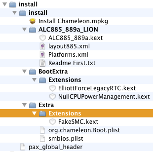

lobstu Posted October 23, 2011 Share Posted October 23, 2011 no mkboot or finalize files in the 1.1 zip. unable to proceed from step 4: sudo install/mkboot ... please advise what to do! Link to comment https://www.insanelymac.com/forum/topic/259068-guide-a-fast-and-easy-way-to-install-lion/page/20/#findComment-1763642 Share on other sites More sharing options...
