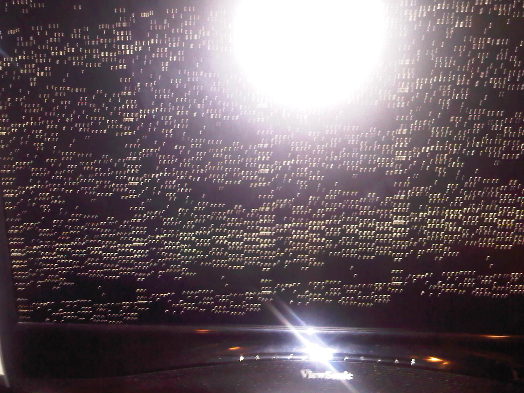

davrosndaleks Posted September 5, 2011 Share Posted September 5, 2011 Any thoughts as to why I'm getting screen tear? It boots beautifully and looks as though it's about to start install and then this.... GA-G41MT-D3 REV1.3 ATI HD5770 2GIG RAM 80GIG HDD thanks very much Link to comment https://www.insanelymac.com/forum/topic/259068-guide-a-fast-and-easy-way-to-install-lion/page/18/#findComment-1744621 Share on other sites More sharing options...

davrosndaleks Posted September 7, 2011 Share Posted September 7, 2011 Any thoughts as to why I'm getting screen tear? It boots beautifully and looks as though it's about to start install and then this.... GA-G41MT-D3 REV1.3 ATI HD5770 2GIG RAM 80GIG HDD thanks very much found that my ATI HD 5770 was causing the error- installed my x800gt and away it went. Am i able to re-install the 5770 after the install is complete? I am guessing I will have to edit the DSDT if I am even able. Link to comment https://www.insanelymac.com/forum/topic/259068-guide-a-fast-and-easy-way-to-install-lion/page/18/#findComment-1745505 Share on other sites More sharing options...
