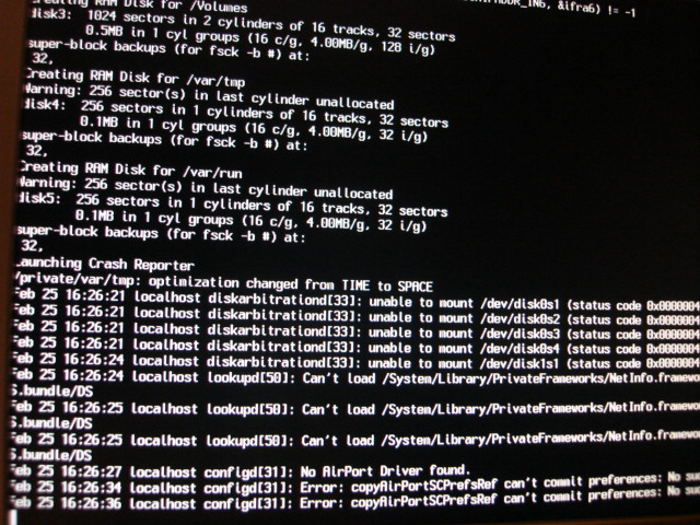

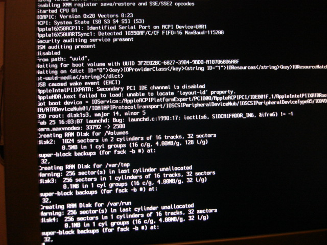

Chrisp7 Posted February 26, 2007 Share Posted February 26, 2007 (edited) Can anyone help - I am so so close but its just not starting! (After at least 10 and rising reinstalls)  My setup:  CPU CORE 2 DUO E6400 CASE + POWER SUPPLY HIPER R ATX 580W CORSAIR 2X 1GB DDR2 6400 ASROCK CONROE945G-DVI (BIOS updated to 1.6) PIONEER DVR-112DBK NVIDIA 6600 WD 160GB IDE SATA 500gb (non apple formatted) APPLE USB KEYBOARD MICROSOFT WIRELESS USB MOUSE.  I am using the latest "JaS.Mac.OS.X.10.4.8.AMD.Intel.SSE2.SSE3.PPF.1.Defiant.diskutil.biker880.ich -R.patch.Integrated" (semthex 8.8.1)  If I install with Nvidia N40 drivers, Intel SSE2 SSE3 - the system starts up, apple icon shows up and the 'star' starts spinning and after a while mentions that I need to restart my system. The same thing happens with a fresh install with just the Intel SSE2 SSE3 installed.  Can anyone help at all - it seems so close!  Is it to do with the BIOS? does 1.6 work? I read a lot about 1.4 working ok. Or is there anything else I need to do?  Thanks v much:)  ps the Hard drive is set as master. pps 10.4.6 works perfectly. ppps the 2 pics are from the same -v  EDIT - Disabling the USB Legacy support has got it working! v happy:) Edited February 26, 2007 by Chrisp7 Link to comment https://www.insanelymac.com/forum/topic/24637-asrock-conroe945g-dvi/page/28/#findComment-311458 Share on other sites More sharing options...
