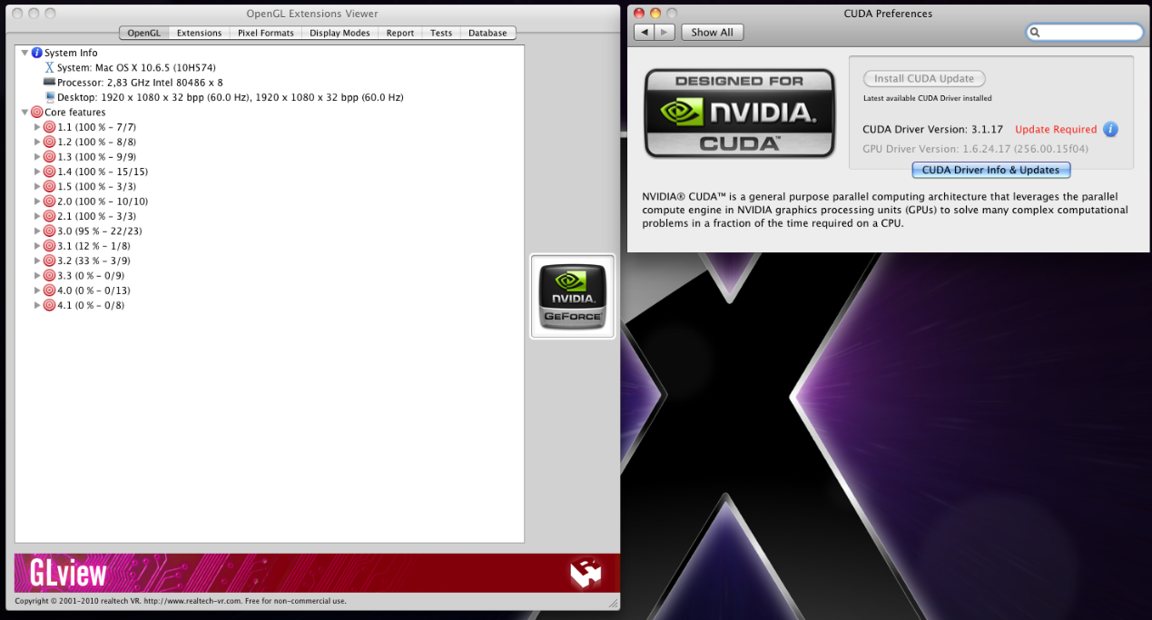

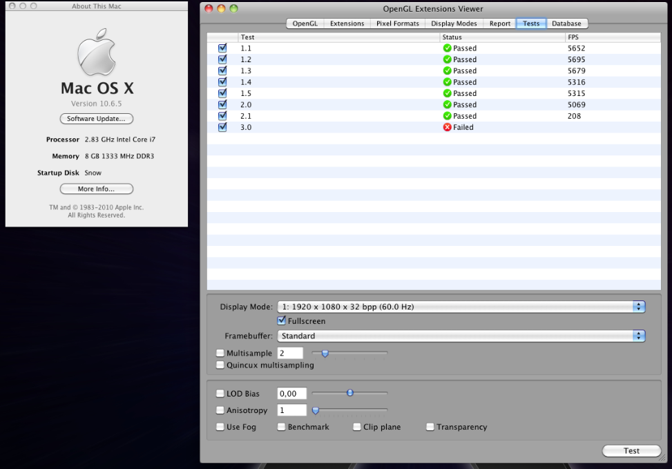

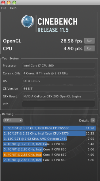

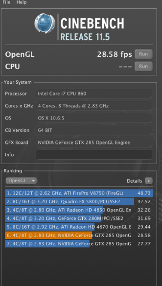

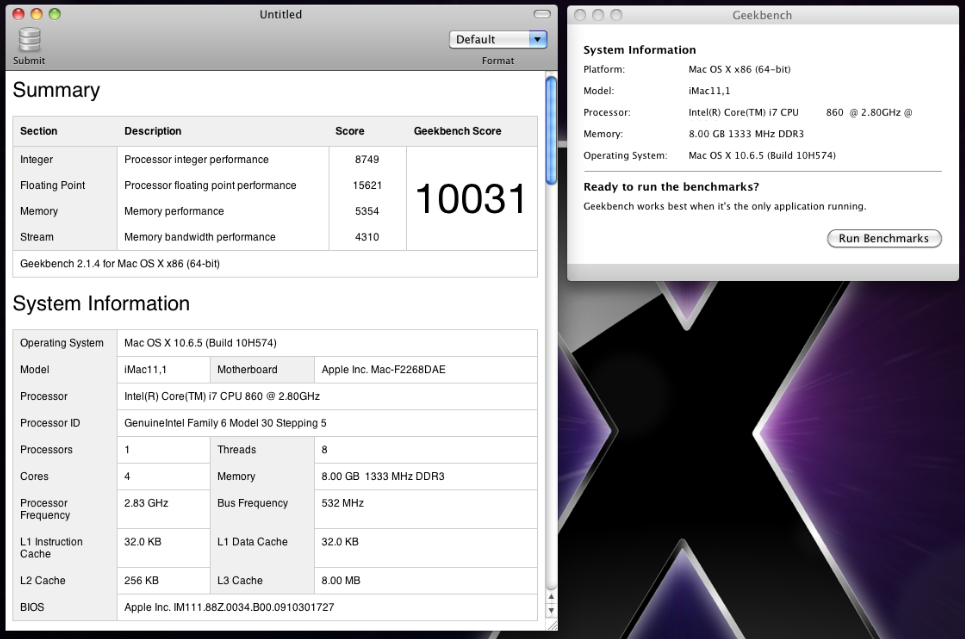

quattrofx Posted November 11, 2010 Share Posted November 11, 2010 Updated over Software Update without problems. As usual only AppleHDA needs to be reinstalled. I have made some TESTS and can confirm a small increase in performance comparing to the state before: http://www.insanelymac.com/forum/index.php...t&p=1539683 GALAXIES 32K_V2 NVIDIA INNO3D GeForce GTX 285 1GB _________SIM:___________________ GIGAFLOPS: Vector Single Core CPU:___________________12 Vector Multi Core CPU:____________________48 GeForce GTX 285:_______________________ 338 Hybrid Multi Core CPU+GPU:______________80 As U can see new NVidia Driver is installed, but appropriate CUDA Driver still failed - well known Nvidia bug! This time Premiere CS5 still using Hardware accelerated Mercury Engine. Let´s wait a few days....as usual. Cheers QuattroFX Link to comment Share on other sites More sharing options...

Gringo Vermelho Posted November 12, 2010 Share Posted November 12, 2010 Updated to 10.6.5 with the combo updater. Everything works fine, USB (ICH10R) graphics (9800 GTX+) and temps are the same as before. Motherboard is Asus P5Q-E. Nvidia drivers and OpenGL framework got updated. Just like with 10.6.4, I have the latest CUDA version but every time I boot up my Hack I get the CUDA update dialog that says "latest version installed" but still tells me to update and that's just retarded. Apparently it happens on real Macs as well. Game performance seems the same. Left 4 Dead 2 just crashed though, it's never done that before. I had to hex-edit the new AppleHDA binary to get AD2000B sound working. Same procedure as with 10.6.3-10.6.4. See the "How To Patch AppleHDA" thread at the ProjectOSX forums for more information. Link to comment Share on other sites More sharing options...

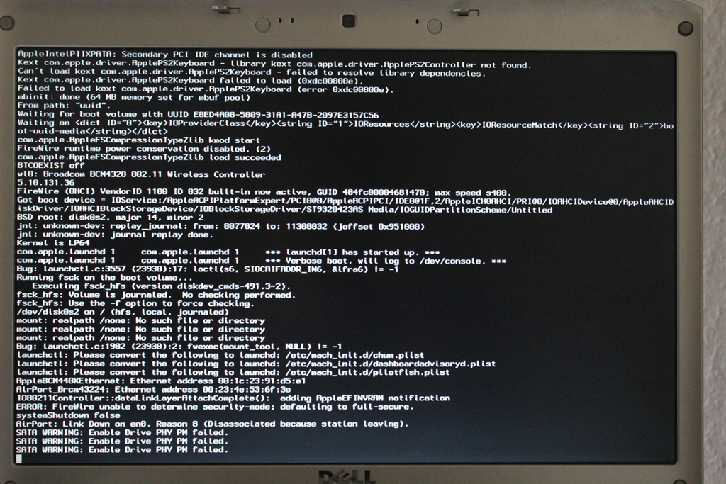

Thomas Van Ta Posted November 12, 2010 Share Posted November 12, 2010 Anyone knows about this? PHY PM failed¿? I uploaded via software update, dont use sleepenabler. Inspiron 1520 retail. Link to comment Share on other sites More sharing options...
