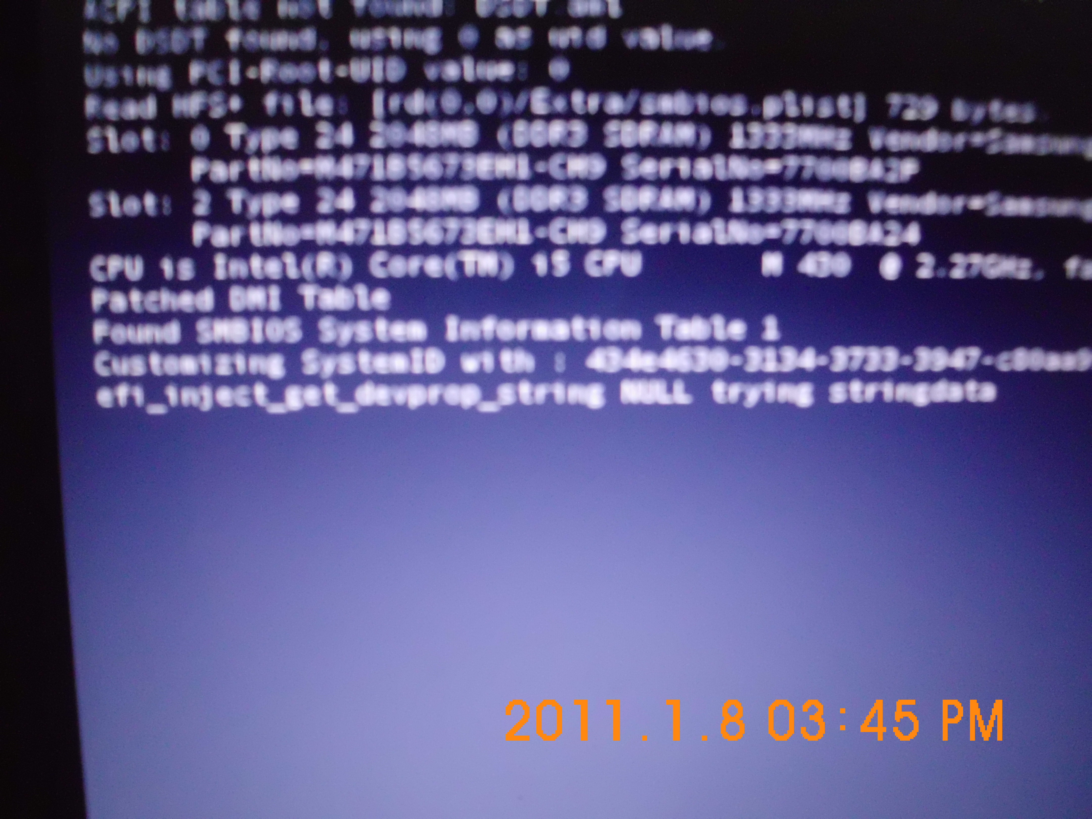

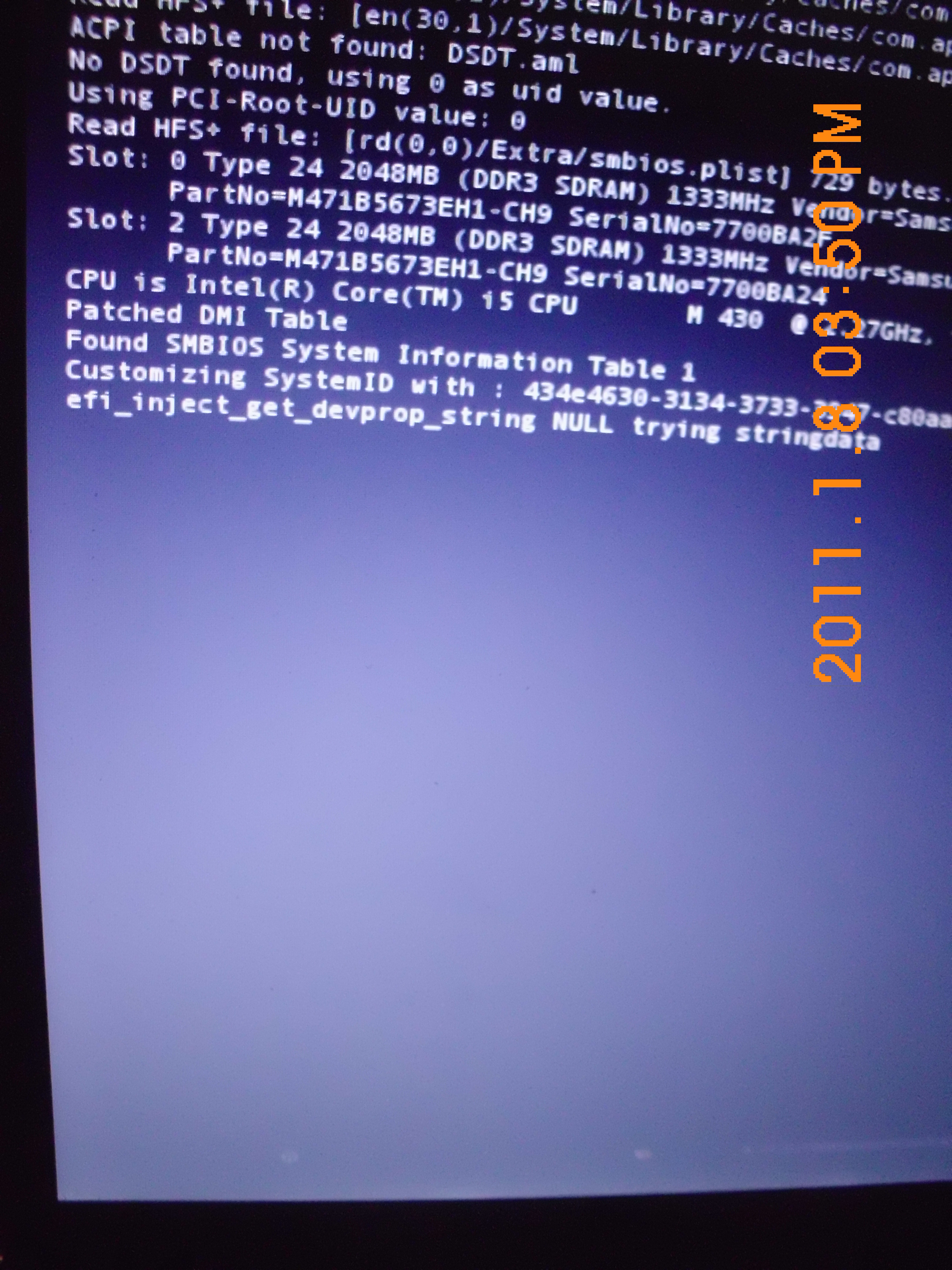

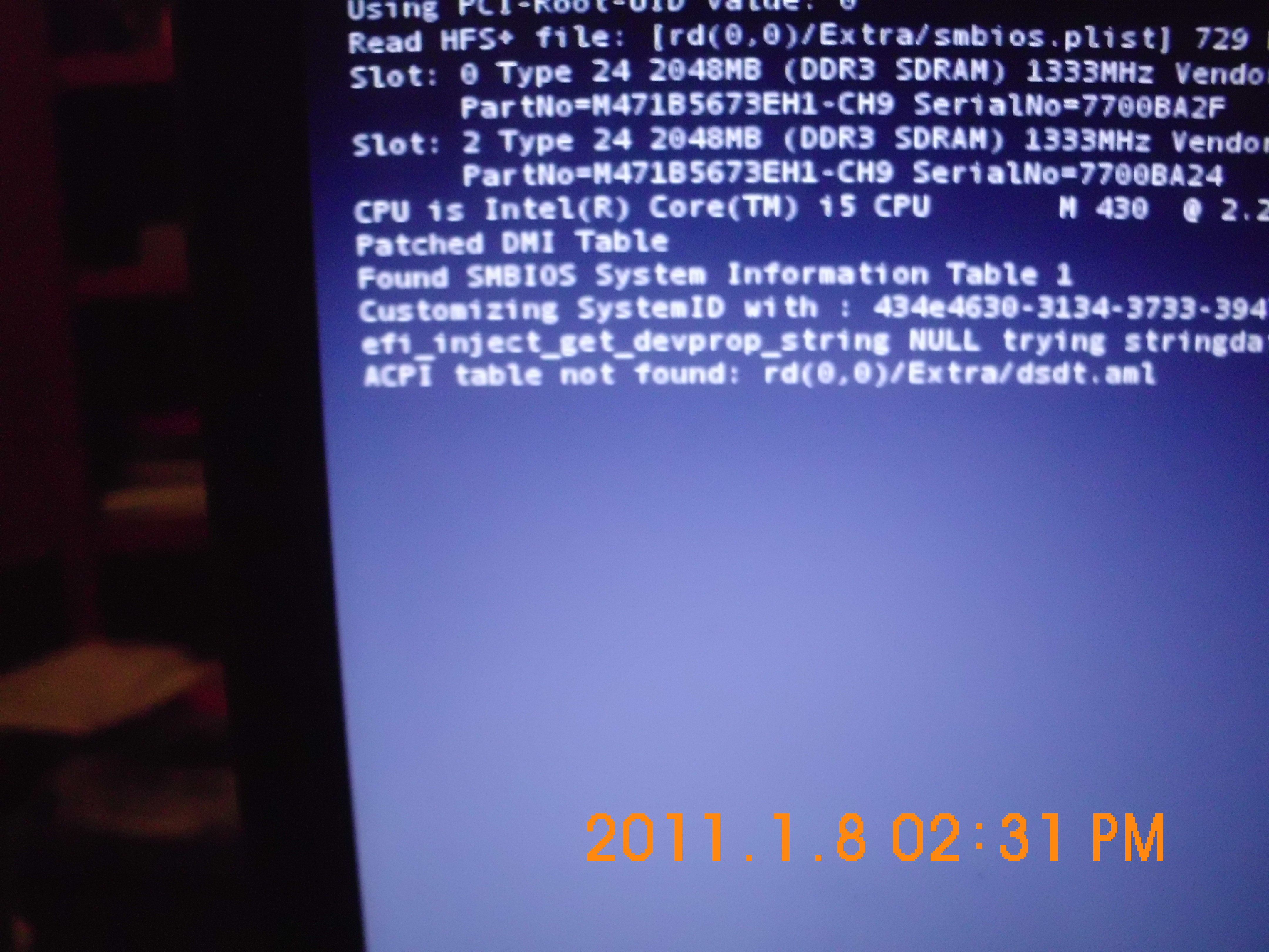

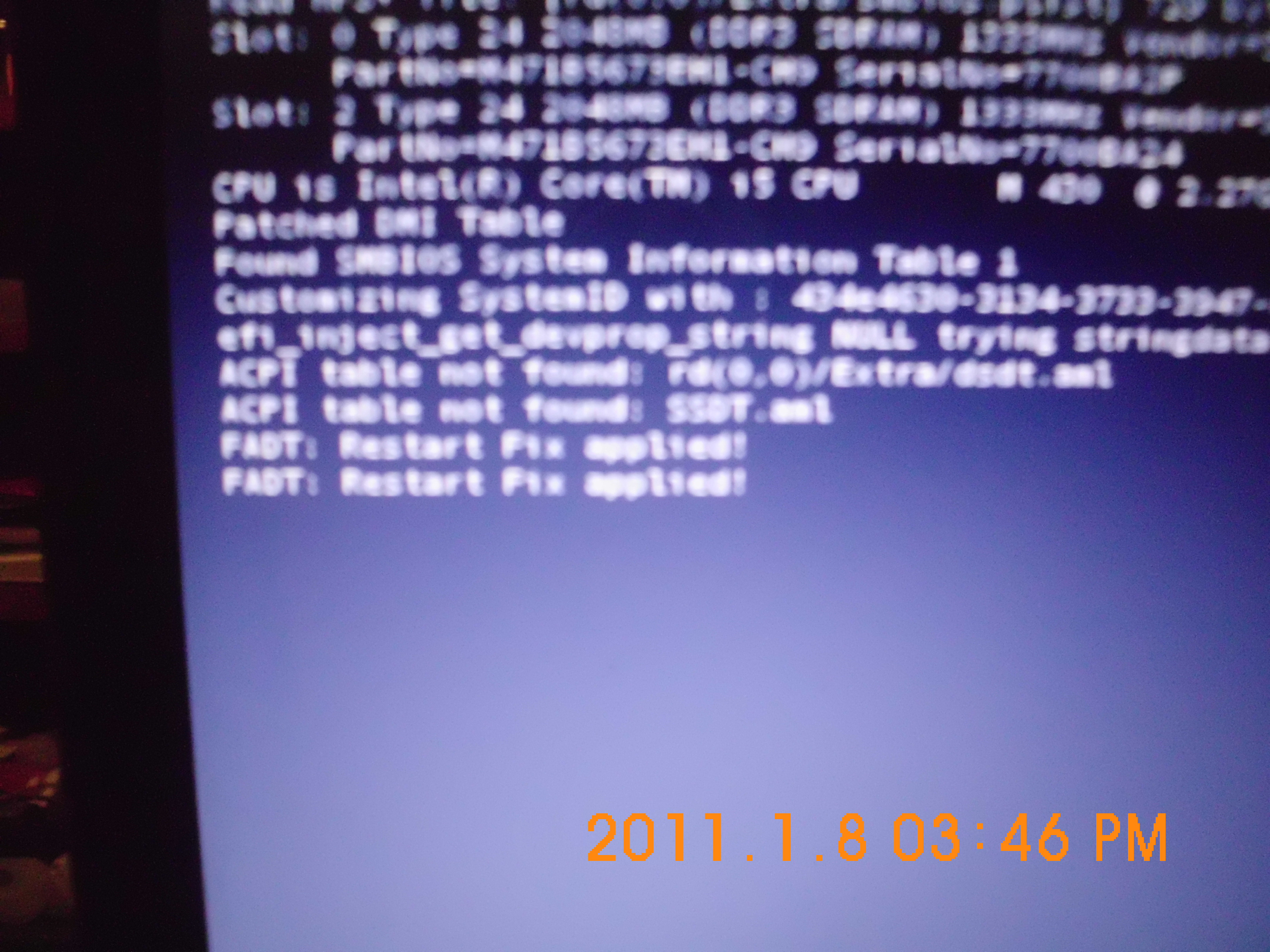

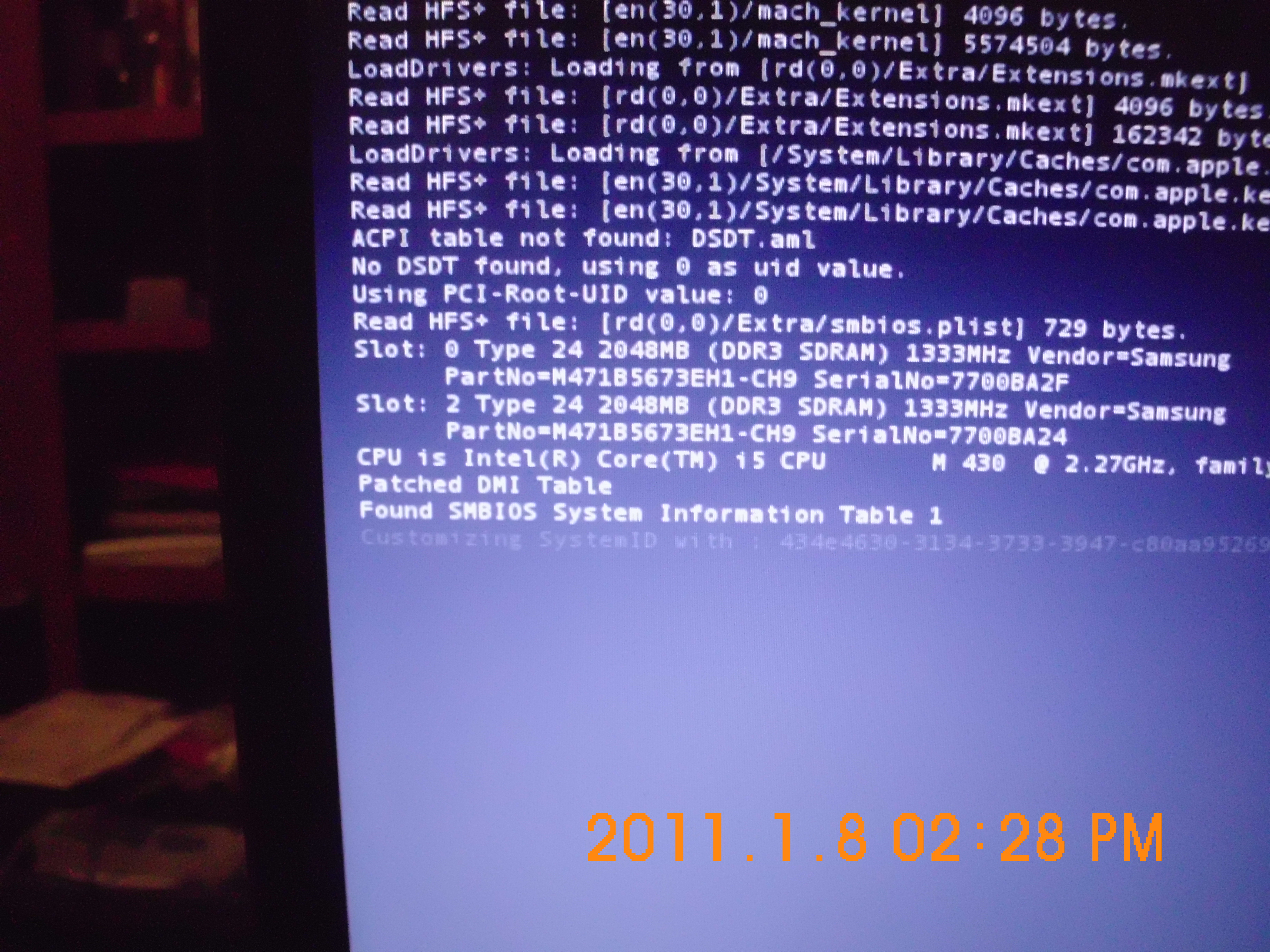

jannierox Posted January 9, 2011 Share Posted January 9, 2011 Well I have tried quite a few times and haven't been able to get it functioning properly yet...still trying! not ready to give up yet . I want to try and help ya figure this out best I can. EDIT: well i am lost as I try to load the installer from the 10.6.3 apple cd it starts the list of loading and errors then just restarts...tried everything i can think of...any ideas?... also how do i post my dsdt for you? Link to comment https://www.insanelymac.com/forum/topic/221653-guide-hp-dv8-dv7-dv6-dv5-1064-easy-comprehensive-installation/page/38/#findComment-1618316 Share on other sites More sharing options...

Mammoth Posted January 10, 2011 Author Share Posted January 10, 2011 EDIT: Well I removed my second drive and tried a few more times. I tried trying the drive in both places i could as well. I took some pictures to try to show what happened. They aren't great but maybe they can help see if I went wrong somewhere Hopefully they are helpful. Ok, try starting up with -f and see how far you get. also meant to re-ask how to give you the dsdt for my machine... This is the easiest and surest way to generate a proper, CLEAN, DSDT: - Download Ubuntu Live CD from ubuntu web site - Burn and boot from CD. You'll be in Ubuntu desktop. Default user is ubuntu and home folder is /home/ubuntu. - From top menu bar, accessories (system) launch terminal and issue the following command: sudo cat /proc/acpi/dsdt > dsdt.aml - Now you'll have it in your home folder. Link to comment https://www.insanelymac.com/forum/topic/221653-guide-hp-dv8-dv7-dv6-dv5-1064-easy-comprehensive-installation/page/38/#findComment-1619153 Share on other sites More sharing options...
jannierox Posted January 10, 2011 Share Posted January 10, 2011 Ok, try starting up with -f and see how far you get. This is the easiest and surest way to generate a proper, CLEAN, DSDT: - Download Ubuntu Live CD from ubuntu web site - Burn and boot from CD. You'll be in Ubuntu desktop. Default user is ubuntu and home folder is /home/ubuntu. - From top menu bar, accessories (system) launch terminal and issue the following command: sudo cat /proc/acpi/dsdt > dsdt.aml - Now you'll have it in your home folder. ok I tried -f and a long list of things started, but in the end it still came up restart fix applied. Restarts again. Link to comment https://www.insanelymac.com/forum/topic/221653-guide-hp-dv8-dv7-dv6-dv5-1064-easy-comprehensive-installation/page/38/#findComment-1619208 Share on other sites More sharing options...
doomer0 Posted January 10, 2011 Share Posted January 10, 2011 ok I tried -f and a long list of things started, but in the end it still came up restart fix applied. Restarts again. i would suggest to try with the parameters busratio=17 / cpus=1 / -x , or mix of them Link to comment https://www.insanelymac.com/forum/topic/221653-guide-hp-dv8-dv7-dv6-dv5-1064-easy-comprehensive-installation/page/38/#findComment-1619367 Share on other sites More sharing options...
