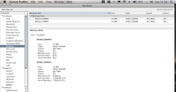

zef Posted February 21, 2010 Share Posted February 21, 2010 @rekursor: All goes fine on the desktop using P5K-E mobo (ICH9R), but still get the "... gathering this information" error on my Acer notebook in sysprofiler with all trunk revs since r90 with 10.5.8. Before r90, the bank layout and and memory size/type was reported correctly on all setup. Link to comment https://www.insanelymac.com/forum/topic/201902-chameleon-rc4-is-out/page/34/#findComment-1414607 Share on other sites More sharing options...

rekursor Posted February 21, 2010 Share Posted February 21, 2010 @rekursor: All goes fine on the desktop using P5K-E mobo (ICH9R), but still get the "... gathering this information" error on my Acer notebook in sysprofiler with all trunk revs since r90 with 10.5.8. Before r90, the bank layout and and memory size/type was reported correctly on all setup. I also had the same problem with my EP45DS3L with 10.5.8 and then discovered this pb was not new, have a search here to AppleSMBIOS27 and error gathering, iGuru and netkas also seemed to deal with that pb when they started to fill the memory information. I think we have to go further and understand why we all have/had this problem but for now I found a fix on 10.5.8 that solved my problem: I use the Hardware profiler fix from: http://thireus.dareyourmind.net/10.5.8_Thireus_Fixes_3.5.zip @DB1 thanks for this important report, thanks to you I isolated the problem (prob. not related to the malloc in itsellf but to a side effect...) I'm on it @MC, you are absolutely right, we waste space, and I will care about that soon (an obvious example is the Platform related memory structures we inherited from the latest asere mods with i.e 64x2x12 string byte alloc when we obviously know that only 2x2*16 bytes avg will be stored, we need dynamic alloc here ) Link to comment https://www.insanelymac.com/forum/topic/201902-chameleon-rc4-is-out/page/34/#findComment-1414703 Share on other sites More sharing options...

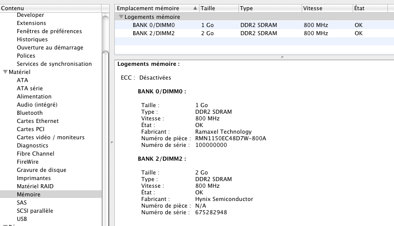

macandrea Posted February 21, 2010 Share Posted February 21, 2010 With Pre10d build Time Machine complained about "previous backup being done on a different machine" + some apps whose registration was hardware based (not UUID based only) stopped working... Has any of you experienced a similar problem? Memory was detected properly (4x2GB DDR3 1333). Thanks a lot for your great work!!! Link to comment https://www.insanelymac.com/forum/topic/201902-chameleon-rc4-is-out/page/34/#findComment-1414781 Share on other sites More sharing options...
