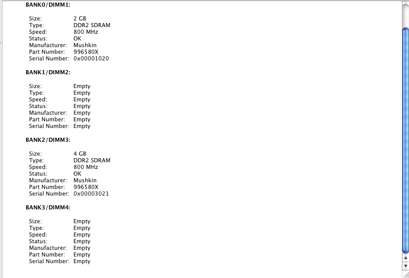

FKA Posted April 3, 2010 Share Posted April 3, 2010 I confirm this "issue" same for me too numkeypad not work with AsereBNL v1.1.9 (I try inside firefox 3.5.8) numkeypad work with Chameleon RC5 pre8 (I try inside firefox 3.5.8) Fabio Hi No numkeypad problems here with either AsereBNK 1.1.9 or pre8 However both are showing my memory in sys prof' to be 6GB - I only have 4GB ! Any ideas? Cheers D. Link to comment https://www.insanelymac.com/forum/topic/201902-chameleon-rc4-is-out/page/39/#findComment-1441219 Share on other sites More sharing options...
snackole Posted April 3, 2010 Share Posted April 3, 2010 Did you remove all the memory info from your smbios.plist ? Link to comment https://www.insanelymac.com/forum/topic/201902-chameleon-rc4-is-out/page/39/#findComment-1441233 Share on other sites More sharing options...
FKA Posted April 3, 2010 Share Posted April 3, 2010 Did you remove all the memory info from your smbios.plist ? yep! yep! I've just gone back to RC4 with my old smbios with RAM details and it's exactly the same! Must be this MSI board. My second 2GB bank of RAM is seen as 4GB, can't believe I've only just seen this .. D, Link to comment https://www.insanelymac.com/forum/topic/201902-chameleon-rc4-is-out/page/39/#findComment-1441315 Share on other sites More sharing options...
Beerkex'd Posted April 3, 2010 Share Posted April 3, 2010 No numkeypad problems here with either AsereBNK 1.1.9 Same here, numpad is fine with AsereBLN 1.1.9. I have Logitech Control Center installed though. I have a different problem: OS X does not remember my keyboard layout setting - I have to keep selecting it in every app I use, all the time. I wonder if that's what Netkas is talking about in the release blurb for PCI EFI 10.6: http://netkas.org/?p=372 However both are showing my memory in sys prof' to be 6GB - I only have 4GB ! Try dumping your DMI info with this tool http://www.insanelymac.com/forum/index.php?showtopic=153582 Maybe it'll give some clues, who knows. Link to comment https://www.insanelymac.com/forum/topic/201902-chameleon-rc4-is-out/page/39/#findComment-1441395 Share on other sites More sharing options...
FKA Posted April 4, 2010 Share Posted April 4, 2010 Thanks for the tip .. Can see a 4GB and 2GB blocks . Handle 0x002D, DMI type 16, 15 bytes Physical Memory Array Location: System Board Or Motherboard Use: System Memory Error Correction Type: None Maximum Capacity: 4 GB Error Information Handle: 0x002E Number Of Devices: 4 Handle 0x002E, DMI type 18, 23 bytes 32-bit Memory Error Information Type: Bad Read Granularity: Device Level Operation: Read Vendor Syndrome: Unknown Memory Array Address: Unknown Device Address: Unknown Resolution: Unknown Handle 0x002F, DMI type 19, 15 bytes Memory Array Mapped Address Starting Address: 0x00000000000 Ending Address: 0x000FFFFFFFF Range Size: 4 GB Physical Array Handle: 0x002D Partition Width: 0 Handle 0x0030, DMI type 17, 27 bytes Memory Device Array Handle: 0x002D Error Information Handle: 0x0031 Total Width: 64 bits Data Width: 64 bits Size: 2048 MB Form Factor: DIMM Set: None Locator: DIMM1 Bank Locator: BANK0 Type: DDR2 Type Detail: Synchronous Speed: 800 MHz (1.2 ns) Manufacturer: Mushkin Serial Number: 0x00001020 Asset Tag: AssetTagNum0 Part Number: 996580X Handle 0x0031, DMI type 18, 23 bytes 32-bit Memory Error Information Type: Bad Read Granularity: Device Level Operation: Read Vendor Syndrome: Unknown Memory Array Address: Unknown Device Address: Unknown Resolution: Unknown Handle 0x0032, DMI type 20, 19 bytes Memory Device Mapped Address Starting Address: 0x00000000000 Ending Address: 0x0007FFFFFFF Range Size: 2 GB Physical Device Handle: 0x0030 Memory Array Mapped Address Handle: 0x002F Partition Row Position: 1 Interleaved Data Depth: 1 Handle 0x0033, DMI type 17, 27 bytes Memory Device Array Handle: 0x002D Error Information Handle: 0x0034 Total Width: Unknown Data Width: Unknown Size: No Module Installed Form Factor: DIMM Set: None Locator: DIMM2 Bank Locator: BANK1 Type: DDR2 Type Detail: Unknown Speed: 800 MHz (1.2 ns) Manufacturer: Mushkin Serial Number: 0x00003021 Asset Tag: AssetTagNum1 Part Number: 996580X Handle 0x0034, DMI type 18, 23 bytes 32-bit Memory Error Information Type: Bad Read Granularity: Device Level Operation: Read Vendor Syndrome: Unknown Memory Array Address: Unknown Device Address: Unknown Resolution: Unknown Handle 0x0035, DMI type 20, 19 bytes Memory Device Mapped Address Starting Address: 0x00000000000 Ending Address: 0x000000003FF Range Size: 1 kB Physical Device Handle: 0x0033 Memory Array Mapped Address Handle: 0x002F Partition Row Position: 1 Interleaved Data Depth: 1 Handle 0x0036, DMI type 17, 27 bytes Memory Device Array Handle: 0x002D Error Information Handle: 0x0037 Total Width: 64 bits Data Width: 64 bits Size: 4096 MB Form Factor: DIMM Set: None Locator: DIMM3 Bank Locator: BANK2 Type: DDR2 Type Detail: Synchronous Speed: 800 MHz (1.2 ns) Manufacturer: Mushkin Serial Number: 0x00003021 Asset Tag: AssetTagNum2 Part Number: 996580X Handle 0x0037, DMI type 18, 23 bytes 32-bit Memory Error Information Type: Bad Read Granularity: Device Level Operation: Read Vendor Syndrome: Unknown Memory Array Address: Unknown Device Address: Unknown Resolution: Unknown Handle 0x0038, DMI type 20, 19 bytes Memory Device Mapped Address Starting Address: 0x00080000000 Ending Address: 0x0017FFFFFFF Range Size: 4 GB Physical Device Handle: 0x0036 Memory Array Mapped Address Handle: 0x002F Partition Row Position: 1 Interleaved Data Depth: 1 Handle 0x0039, DMI type 17, 27 bytes Memory Device Array Handle: 0x002D Error Information Handle: 0x003A Total Width: Unknown Data Width: Unknown Size: No Module Installed Form Factor: DIMM Set: None Locator: DIMM4 Bank Locator: BANK3 Type: DDR2 Type Detail: Unknown Speed: 800 MHz (1.2 ns) Manufacturer: Mushkin Serial Number: 0x00003021 Asset Tag: AssetTagNum3 Part Number: N/A Handle 0x003A, DMI type 18, 23 bytes 32-bit Memory Error Information Type: Bad Read Granularity: Device Level Operation: Read Vendor Syndrome: Unknown Memory Array Address: Unknown Device Address: Unknown Resolution: Unknown Handle 0x003B, DMI type 20, 19 bytes Memory Device Mapped Address Starting Address: 0x00000000000 Ending Address: 0x000000003FF Range Size: 1 kB Physical Device Handle: 0x0039 Memory Array Mapped Address Handle: 0x002F Partition Row Position: 1 Interleaved Data Depth: 1 D I wonder if that's what Netkas is talking about in the release blurb for PCI EFI 10.6: http://netkas.org/?p=372 could be. Link to comment https://www.insanelymac.com/forum/topic/201902-chameleon-rc4-is-out/page/39/#findComment-1441477 Share on other sites More sharing options...
Beerkex'd Posted April 4, 2010 Share Posted April 4, 2010 wow, that looks really strange. According to the dump, the sticks in slots 2, 3 and 4 have the same serial number (impossible!) but it looks like slots 2 and 4 are unpopulated? What's the actual, physical layout, how many modules, which slots are populated and with what size sticks? 2GB sticks in slot 1 and 3, right? Link to comment https://www.insanelymac.com/forum/topic/201902-chameleon-rc4-is-out/page/39/#findComment-1441484 Share on other sites More sharing options...
FKA Posted April 4, 2010 Share Posted April 4, 2010 2GB sticks in slot 1 and 3, right? correct 2x2GB pc2 6400. And everything is fine with Windows7 x64 ! Link to comment https://www.insanelymac.com/forum/topic/201902-chameleon-rc4-is-out/page/39/#findComment-1441741 Share on other sites More sharing options...
Beerkex'd Posted April 4, 2010 Share Posted April 4, 2010 Could there be a defect in the second RAM stick's SPD programming? What happens if you swap the two sticks? The empty slots 2 and 4 get a serial number - the same as the stick in slot 3 - and also has the manufacturer listed. The empty slot 2 has a part number listed as well. But both slots are listed as unpopulated :-) So the most buggy readout comes from the empty slot 2 (ignoring the phantom 2GB in slot 3!) What happens if you plug your RAM into slots 2 and 4 instead? Maybe it's something in your DSDT? Could it have something to do with this code: http://www.insanelymac.com/forum/index.php...t&p=1431895 Link to comment https://www.insanelymac.com/forum/topic/201902-chameleon-rc4-is-out/page/39/#findComment-1441810 Share on other sites More sharing options...
FKA Posted April 4, 2010 Share Posted April 4, 2010 Could there be a defect in the second RAM stick's SPD programming? What happens if you swap the two sticks? The empty slots 2 and 4 get a serial number - the same as the stick in slot 3 - and also has the manufacturer listed. The empty slot 2 has a part number listed as well. But both slots are listed as unpopulated :-) So the most buggy readout comes from the empty slot 2 (ignoring the phantom 2GB in slot 3!) What happens if you plug your RAM into slots 2 and 4 instead? Maybe it's something in your DSDT? Could it have something to do with this code: http://www.insanelymac.com/forum/index.php...t&p=1431895 stuck at work ... I'll have a mess around later . Removing the mem device from dsdt may be the way forward if there is no fault with the sticks, I'm pretty sure there isn't! Cheers D. Link to comment https://www.insanelymac.com/forum/topic/201902-chameleon-rc4-is-out/page/39/#findComment-1441881 Share on other sites More sharing options...

FKA Posted April 5, 2010 Share Posted April 5, 2010 stuck at work ... I'll have a mess around later . Removing the mem device from dsdt may be the way forward if there is no fault with the sticks, I'm pretty sure there isn't! Cheers D. removing Device (MEM ... has made no difference! Link to comment https://www.insanelymac.com/forum/topic/201902-chameleon-rc4-is-out/page/39/#findComment-1442374 Share on other sites More sharing options...
