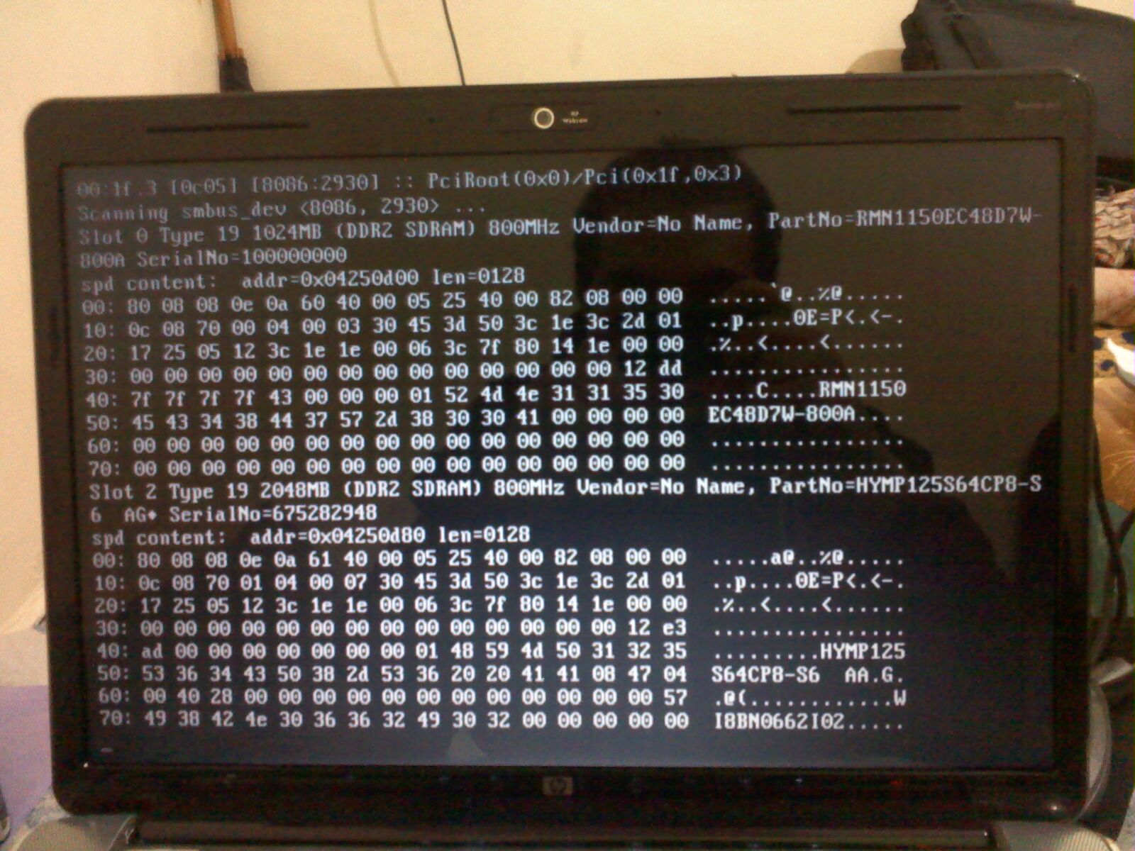

rachaf Posted February 19, 2010 Share Posted February 19, 2010 Is this what you want "rekursor": sorry for the quality of image Link to comment https://www.insanelymac.com/forum/topic/201902-chameleon-rc4-is-out/page/33/#findComment-1413621 Share on other sites More sharing options...
rekursor Posted February 19, 2010 Share Posted February 19, 2010 iNDi is one of the Chameleon developers and my friend well if he wants to have a look to the the spd.c sources, he's welcome maybe he will find smtg ? Is this what you want "rekursor": sorry for the quality of image Yes thanks your vendor IDs are bank 4, 0x43 and bank 0, 0xAD ... I'll see what I can do Link to comment https://www.insanelymac.com/forum/topic/201902-chameleon-rc4-is-out/page/33/#findComment-1413622 Share on other sites More sharing options...

rekursor Posted February 19, 2010 Share Posted February 19, 2010 Yes thanks your vendor IDs are bank 4, 0x43 and bank 0, 0xAD ...I'll see what I can do I added all known vendors, should work with all memories that conform to the DDR2 jedec standard (most of them) will be avail in few minutes as 10d ... RC5pre10 core2quad 8200 2.3GHz oc to 2.8HGz - vanilla, using fakesmc + ati/alc888 kexts only, no DSDT: - correctly shows overclocked CPU frequency (previous buids did not) - correctly shows DDR2/800 (previous builds showed 667) - restart fix does NOT work - stuck on blue screen with spinning circle thanx for your work! EDIT: i noticed in profiller - Bus Speed: 1.6 GHz - this is probably wrong Bus speed is not addressed by this memory detection, so this is normal: use SMbusspeed to address this. Then try latest pre10d that will be avail in few minutes in the same original topic for vendor names and parts... EDIT: done here: http://www.insanelymac.com/forum/index.php...t&p=1413138 Link to comment https://www.insanelymac.com/forum/topic/201902-chameleon-rc4-is-out/page/33/#findComment-1413648 Share on other sites More sharing options...
Dr. Hurt Posted February 19, 2010 Share Posted February 19, 2010 I finally got OS X back up and working again. Had to replace a faulty DVD drive, reformat and reinstall!! I just tried 10d and it works great except for memory detection for the second memory slot. My motherboard has 2 slots only with address 0 and 2 (I think) to enable dual channel. I had this same issue with Asere's loader at first, then he somehow fixed it. Second thing is, it detects default RAM speed, not actual (current) RAM speed. I don't really mind though. Good job, rekursor. A very good step forward. Thanks Link to comment https://www.insanelymac.com/forum/topic/201902-chameleon-rc4-is-out/page/33/#findComment-1413672 Share on other sites More sharing options...

rachaf Posted February 19, 2010 Share Posted February 19, 2010 i have the same thing with rc5pre10d the second memory slot (hynix) not detected from everest i have this (sorry in french): PropriÈtÈs du pÈriphÈrique mÈmoire: Forme SODIMM Type DDR2 Type dÈtaillÈ Synchronous Taille 1024 Mo Vitesse 800 MHz Taille totale 64 bits Largeur de donnÈes 64 bits Emplacement du pÈriphÈrique DIMM0 NumÈro de la banque BANK 0 Fabricant 7F7F7F7F43000000 NumÈro de sÈrie 00000000 …tiquette Inconnu NumÈro du type de composant 000000000000000000000000000000000000 [ PÈriphÈriques mÈmoire / DIMM2 ] PropriÈtÈs du pÈriphÈrique mÈmoire: Forme SODIMM Type DDR2 Type dÈtaillÈ Synchronous Taille 2048 Mo Vitesse 800 MHz Taille totale 64 bits Largeur de donnÈes 64 bits Emplacement du pÈriphÈrique DIMM2 NumÈro de la banque BANK 2 Fabricant AD00000000000000 NumÈro de sÈrie 04004028 …tiquette Inconnu NumÈro du type de composant 282828282828282828282828282828282828 Link to comment https://www.insanelymac.com/forum/topic/201902-chameleon-rc4-is-out/page/33/#findComment-1413696 Share on other sites More sharing options...
rekursor Posted February 19, 2010 Share Posted February 19, 2010 I finally got OS X back up and working again. Had to replace a faulty DVD drive, reformat and reinstall!! I just tried 10d and it works great except for memory detection for the second memory slot. My motherboard has 2 slots only with address 0 and 2 (I think) to enable dual channel. I had this same issue with Asere's loader at first, then he somehow fixed it. Second thing is, it detects default RAM speed, not actual (current) RAM speed. I don't really mind though. Good job, rekursor. A very good step forward. Thanks Thanks, now it is clear why some of you have the second slot not detected correctly, (especially on laptops) I'm on it, time to introduce smbios tables type 5,6,16,17 use ... Link to comment https://www.insanelymac.com/forum/topic/201902-chameleon-rc4-is-out/page/33/#findComment-1413708 Share on other sites More sharing options...
rekursor Posted February 20, 2010 Share Posted February 20, 2010 Thanks,now it is clear why some of you have the second slot not detected correctly, (especially on laptops) I'm on it, time to introduce smbios tables type 5,6,16,17 use ... CALL FOR REPORTING: ATTENTION ALL laptop users or desktop users that get one mem. slot recognized and the other not recognized (N / A), I made a boot version that reports the number of slots detected by smbios then: For each slot <n> , it will say: Bank Connection code for Slot <n> is <hex_value>, so <k> bank connections per slot deducted Please report for each slot the <hex_value> and <k> (about 8 numbers to write on paper max.) With this, I think I can deduct the correct slot mapping ... the boot file to do this is HERE: boot_report.tar.gz TIA Link to comment https://www.insanelymac.com/forum/topic/201902-chameleon-rc4-is-out/page/33/#findComment-1414033 Share on other sites More sharing options...
