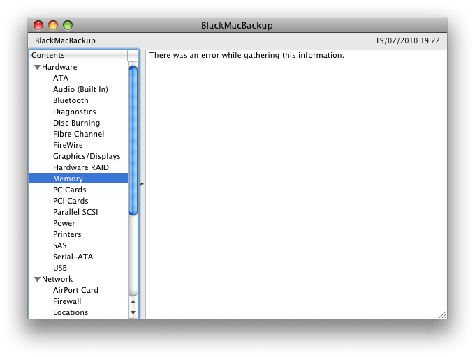

scrax Posted February 19, 2010 Share Posted February 19, 2010 @ Gabo and scrax: try the new version modified for DDR2 owner here: http://www.insanelymac.com/forum/index.php...t&p=1413138 It works for the detection, but I have the same oerrror of Blackosx now in System Profiler. another strange thing is that at boot, before loading the GUI, i have a sort of lspci result, and after that i can see the RAM data collected, for every bank I need to press a key to go on. In this part the value are correct. I saw the lspci thing also before the memory code, when i compiled myself the pre8 and pre9 Link to comment https://www.insanelymac.com/forum/topic/201902-chameleon-rc4-is-out/page/32/#findComment-1413379 Share on other sites More sharing options...
rekursor Posted February 19, 2010 Share Posted February 19, 2010 It works for the detection, but I have the same oerrror of Blackosx now in System Profiler.another strange thing is that at boot, before loading the GUI, i have a sort of lspci result, and after that i can see the RAM data collected, for every bank I need to press a key to go on. In this part the value are correct. I saw the lspci thing also before the memory code, when i compiled myself the pre8 and pre9 Yes I have DEBUG_SPD to 1 so that one could see if its memory is detected and how. Too bad it seems not to work well with ddr2 because I think I added new code that conforms with DDR2 SPD specification (which btw is very different from the DDR3 one ) After all, it's only a one shot work, I didn't spend weeks on it ... I'll see what I can do. Link to comment https://www.insanelymac.com/forum/topic/201902-chameleon-rc4-is-out/page/32/#findComment-1413405 Share on other sites More sharing options...

blackosx Posted February 19, 2010 Share Posted February 19, 2010 Still no clue for ddr2 users, blackosx did you figured out whats happenings with the profile info ?here: http://www.insanelymac.com/forum/index.php...t&p=1413138 Hi rekursor I have just tried pre10C. How do I use the DumpSPD=y option? as I typed it directly in to Chameleon's GUI but didn't notice anything. I have 30 mins now to try anything you like for tests This is what I see using Pre10b. The memory is correctly detected at this point. Link to comment https://www.insanelymac.com/forum/topic/201902-chameleon-rc4-is-out/page/32/#findComment-1413526 Share on other sites More sharing options...
rekursor Posted February 19, 2010 Share Posted February 19, 2010 no i have no error; (!) ahh, so I believe that my first ddr2 version pre10 screwed up something on ddr2 machines, but then 10b/c versions seem to work well... When I start my broken core2duo/ddr2 config with a boot cd, I can get rid of this error I have, but *not* if I install a previous booter with no mem detection ... So it seems that something has been changed in the boot config that makes this error happening. maybe a kext changed or a bios config resetted ? Will continue to investigate ... Link to comment https://www.insanelymac.com/forum/topic/201902-chameleon-rc4-is-out/page/32/#findComment-1413528 Share on other sites More sharing options...

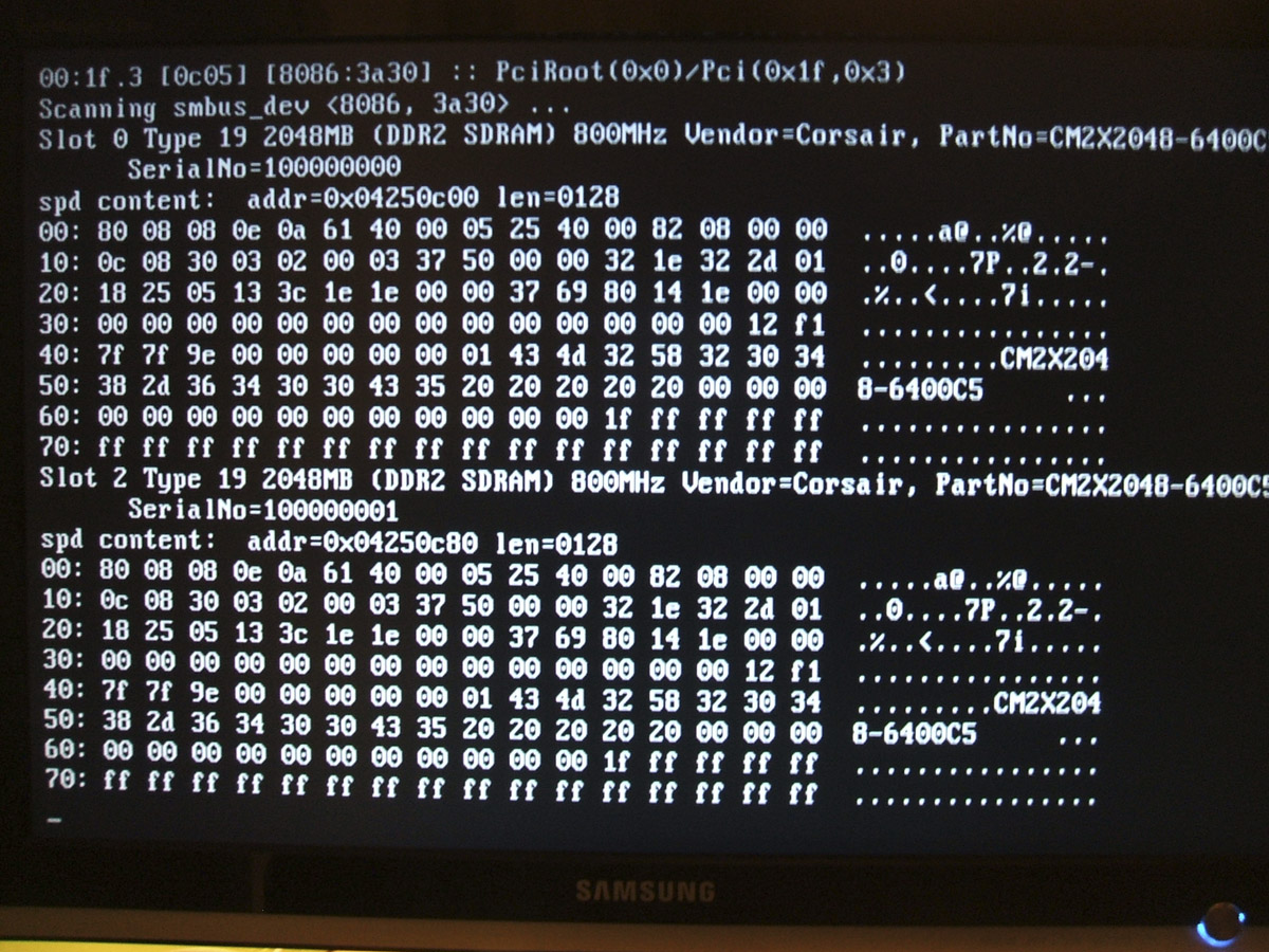

rekursor Posted February 19, 2010 Share Posted February 19, 2010 Hi rekursor I have just tried pre10C. How do I use the DumpSPD=y option? as I typed it directly in to Chameleon's GUI but didn't notice anything. I have 30 mins now to try anything you like for tests This is what I see using Pre10b. The memory is correctly detected at this point. It would be nice if you could test from a backup disk the 10c version to see if it screws up the profile info. Because it works well for rachaf (except a cosmetic vendor name that we'll find out later), so I start to believe that only the first pre10 version screwed up something in ddr2 configs ... inormally putting DumpSPD to y in the boot config should display the same info in 10c, but don't bother with : if it worked with 10b it will work the same with 10c. the only thing to fix is to get back to a state where you don't have the profile error (gathering information) Link to comment https://www.insanelymac.com/forum/topic/201902-chameleon-rc4-is-out/page/32/#findComment-1413534 Share on other sites More sharing options...
blackosx Posted February 19, 2010 Share Posted February 19, 2010 Okay I have tried booting two separate 10.5.8 installs from pre10c on HDD and from a USB stick. Still get the system profiler error. I will now try with two separate 10.6 installs. EDIT: Still no joy I even tried booting without a SMBIOS.plist. I have to go out now but post any other ideas you have for me to try later.. Link to comment https://www.insanelymac.com/forum/topic/201902-chameleon-rc4-is-out/page/32/#findComment-1413547 Share on other sites More sharing options...
rekursor Posted February 19, 2010 Share Posted February 19, 2010 between when i use the boot of AsereBLN i have this: ram_AsereBLN.tiff Please use the dump version 10b and write the hexadecimal values of bytes 64 to 71. I can integrate this hynix brand if I can get the content of these fields Thanks Link to comment https://www.insanelymac.com/forum/topic/201902-chameleon-rc4-is-out/page/32/#findComment-1413555 Share on other sites More sharing options...

rachaf Posted February 19, 2010 Share Posted February 19, 2010 Please use the dump version 10b and write the hexadecimal values of bytes 64 to 71.I can integrate this hynix brand if I can get the content of these fields Thanks sorry, but how can i get dump? Link to comment https://www.insanelymac.com/forum/topic/201902-chameleon-rc4-is-out/page/32/#findComment-1413575 Share on other sites More sharing options...
rekursor Posted February 19, 2010 Share Posted February 19, 2010 sorry, but how can i get dump? use the version: RC5pre10b upper in this thread and when the boot wait for a key read the dump ... The fields range is in hexa: 0x40 to 0x47 for ddr2 vendor id. @king: I have no idea about the lag on the laptop But I KNOW now that I can't help for your dimm because all id fields for vendor name are FF, plus I had a check to this Unifosa vendor and it is not registered, sorry about that ... Link to comment https://www.insanelymac.com/forum/topic/201902-chameleon-rc4-is-out/page/32/#findComment-1413581 Share on other sites More sharing options...
