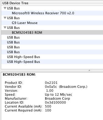

kdawg Posted January 9, 2010 Share Posted January 9, 2010 I know this is old - so maybe everyone is already working well but.. I have a Trend TBW-105UB that works fine, sleep and all. Can wake with mouse too.Can you take a snapshot of the USB device in system profiler so we can see the Product ID and Vendor ID? It would be helpful from now on to know what each manufacturer uses for a chipset. Apple only supports a few, Cambridge Silicon Radio and Broadcom are two of them. We should compile a list of all the USB devices. If you all post them I'll compile them into another thread. Link to comment https://www.insanelymac.com/forum/topic/193272-apple-magic-mouse-osx86-external-bluetooth-dongle/page/7/#findComment-1380217 Share on other sites More sharing options...
jeff33702 Posted January 11, 2010 Share Posted January 11, 2010 Can you take a snapshot of the USB device in system profiler so we can see the Product ID and Vendor ID? It would be helpful from now on to know what each manufacturer uses for a chipset. Apple only supports a few, Cambridge Silicon Radio and Broadcom are two of them. We should compile a list of all the USB devices. If you all post them I'll compile them into another thread. Sorry guys - I haven't been able to reproduce being able to wake the machine from sleep using the mouse. I might have hit the keyboard at the same time and not realized it? Anyway, other than that, it works fine. It works after the machine wakes but you just cant use it to actually WAKE the machine. Link to comment https://www.insanelymac.com/forum/topic/193272-apple-magic-mouse-osx86-external-bluetooth-dongle/page/7/#findComment-1381998 Share on other sites More sharing options...

jeff33702 Posted January 12, 2010 Share Posted January 12, 2010 Trend TBW-105UB Link to comment https://www.insanelymac.com/forum/topic/193272-apple-magic-mouse-osx86-external-bluetooth-dongle/page/7/#findComment-1383269 Share on other sites More sharing options...
