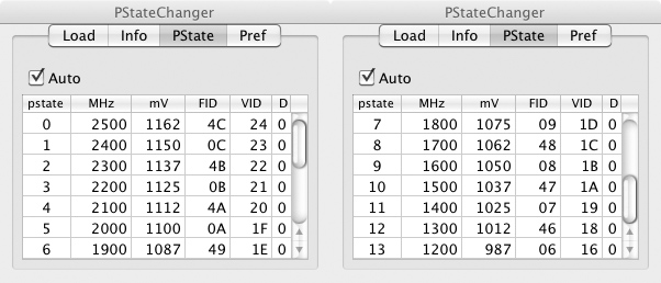

Intel Core 2 E5200 has 13 p-states. I need to add all of these to the DSDT?
Here is my Intel Q6600 (just 4 p-states):
Scope (_PR)
    Name (PSS, Package (0x04)
        Package (0x06) { Zero, Zero, 10, 10, 0x0928, Zero },
        Package (0x06) { Zero, Zero, 10, 10, 0x0824, One },
        Package (0x06) { Zero, Zero, 10, 10, 0x0720, 2 },
        Package (0x06) { Zero, Zero, 10, 10, 0x061B, 3 }
    Name (PSD, Package (0x05)
        0x05,Zero,Zero,0xFC,0x04
    Name (CST, Package (0x02)
        0x01,
        Package (0x04){ResourceTemplate (){Register (FFixedHW,0x01,0x02,0x000,0x00,)},One,One,0x03E8},
    Processor (CPU0, 0x00, 0x00000410, 0x06)
        Alias (PSS, _PSS)
        Alias (PSD, _PSD)
        Alias (CST, _CST)
    Processor (CPU1, 0x01, 0x00000410, 0x06)
        Alias (PSS, _PSS)
        Alias (PSD, _PSD)
        Alias (CST, _CST)
    Processor (CPU2, 0x02, 0x00000410, 0x06)
        Alias (PSS, _PSS)
        Alias (PSD, _PSD)
        Alias (CST, _CST)
    Processor (CPU3, 0x03, 0x00000410, 0x06)
        Alias (PSS, _PSS)
        Alias (PSD, _PSD)
        Alias (CST, _CST)
I hope someone can help me with an idea about the Intel E5200.
Probably should be something close to this assuming three c-states and you have 14 p-states.
Scope (_PR)
    Name (PSS, Package (0x0E)
        Package (0x06) { Zero, Zero, 10, 10, 0x4C24, Zero },
        Package (0x06) { Zero, Zero, 10, 10, 0x0C23, One },
        Package (0x06) { Zero, Zero, 10, 10, 0x4B22, 2 },
        Package (0x06) { Zero, Zero, 10, 10, 0x0B21, 3 }
        Package (0x06) { Zero, Zero, 10, 10, 0x4A20, 4 },
        Package (0x06) { Zero, Zero, 10, 10, 0x0A1F, 5 },
        Package (0x06) { Zero, Zero, 10, 10, 0x491E, 6 },
        Package (0x06) { Zero, Zero, 10, 10, 0x091D, 7 },
        Package (0x06) { Zero, Zero, 10, 10, 0x481C, 8 },
        Package (0x06) { Zero, Zero, 10, 10, 0x081B, 9 },
        Package (0x06) { Zero, Zero, 10, 10, 0x471A, 0xA },
        Package (0x06) { Zero, Zero, 10, 10, 0x0719, 0xB },
        Package (0x06) { Zero, Zero, 10, 10, 0x4618, 0xC },
        Package (0x06) { Zero, Zero, 10, 10, 0x0616, 0xD },
        0x05,Zero,Zero,0xFC,0x02
       Name (CST, Package (0x04) // 3 cstates
           0x03,
           Package (0x04){ResourceTemplate (){Register (FFixedHW,0x01,0x02,0x0000000000000000,0x00,)},One,One,0x03E8},
           Package (0x04){ResourceTemplate (){Register (SystemIO,0x08,0x00,0x0000000000000414, ,)},0x02,One,0x01F4},
           Package (0x04){ResourceTemplate (){Register (SystemIO,0x08,0x00,0x0000000000000415, ,)},0x03,0x55,0xFA}
        Alias (PSS, _PSS)
        Alias (PSD, _PSD)
        Alias (CST, _CST)
        Alias (PSS, _PSS)
        Alias (PSD, _PSD)
        Alias (CST, _CST)

Okay using this guide I am almost 100% only have the FakeSMC.kext and my LegacyHDA in the Extras folder everything is working great. Is there a way to test the processor to see if via speed-step it roles through all the multipliers. my geek-bench is about 1000 points lower now and via the voodoo-monitor I see I never get about the x7 multiplier even during the bench. I should be able to max at x10 multiplier......
Please don't flame me here for a speedstep question I did not see an answer to this anywhere else before posting.
Using the myHack installer it set me up as iMac 8,1 could this be the issue
Hi Ridge,
yeah it's better to be set as macpro3.1 for dsdt speedstep, and you should have a better geekbench score with dsdt speedstep then without
