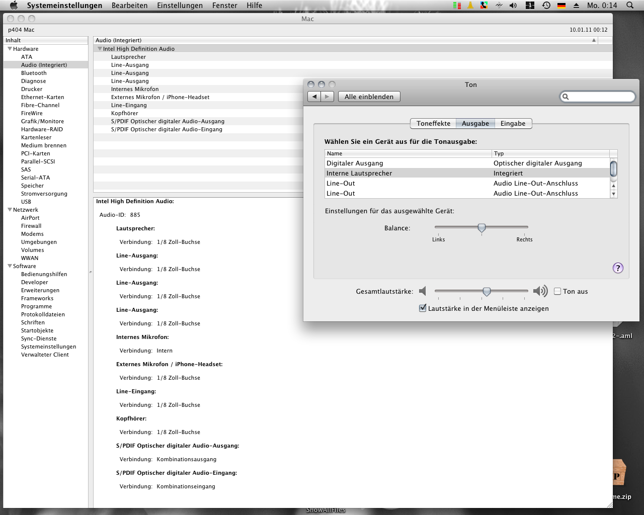

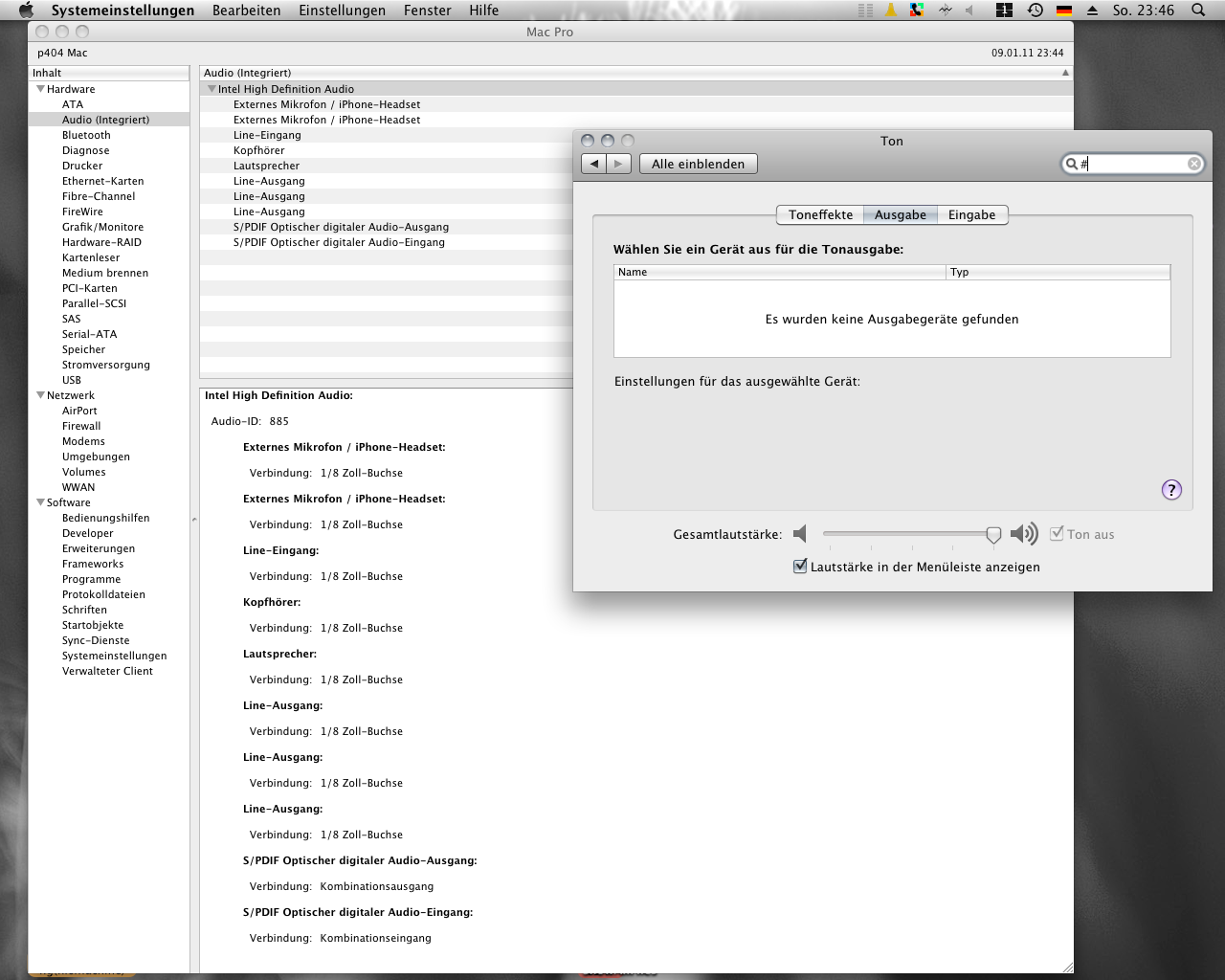

loisl Posted January 10, 2011 Share Posted January 10, 2011 1- Copy "Extra" folder to HD (DSDT in "Extra" folder)loisl.zip 2- Install Chameleon RC5 Chameleon_v2.0_RC5_r700.zip reboot -v Hi MaLd0n, I'm testing the first system At boot I have no errors and start the system. 1) SLEEP is working 2) For the Graphics Card nVidia 8800 GTX I've entered the code yet (according to Device (PCI0)): Device (PEGP) { Name (_ADR, 0x00010000) Device (GFX0) { Name (_ADR, Zero) Name (_SUN, One) Method (_DSM, 4, NotSerialized) { Store (Package (0x16) { "@0,compatible", Buffer (0x0B) { "NVDA,NVMac" }, "@0,device_type", Buffer (0x08) { "display" }, "@0,name", Buffer (0x0F) { "NVDA,Display-A" }, "@1,compatible", Buffer (0x0B) { "NVDA,NVMac" }, "@1,device_type", Buffer (0x08) { "display" }, "@1,name", Buffer (0x0F) { "NVDA,Display-B" }, "NVCAP", Buffer (0x18) { /* 0000 */ 0x04, 0x00, 0x00, 0x00, 0x00, 0x00, 0x03, 0x00, /* 0008 */ 0x0C, 0x00, 0x00, 0x00, 0x00, 0x00, 0x00, 0x07, /* 0010 */ 0x00, 0x00, 0x00, 0x00 }, "VRAM,totalsize", Buffer (0x04) { 0x00, 0x00, 0x00, 0x30 }, "device_type", Buffer (0x0D) { "NVDA,GeForce" }, "model", Buffer (0x18) { "nVidia GeForce 8800 GTX" }, "rom-revision", Buffer (0x26) { "nVidia GeForce 8800 GTX OpenGL Engine" } }, Local0) DTGP (Arg0, Arg1, Arg2, Arg3, RefOf (Local0)) Return (Local0) } } } .... Graphics Card is work on two monitors 3) SOUND CARD is NOT working see two pictures many many thanks loisl Link to comment https://www.insanelymac.com/forum/topic/192518-dsdt-fixes-for-gigabyte-boards/page/73/#findComment-1619098 Share on other sites More sharing options...
MaLd0n Posted January 10, 2011 Share Posted January 10, 2011 ALC889a?? HDEF in DSDT LegacyHda in Extra/Extensions no additions to nothing in the scope pr use the power management by chameleon RC5 run on terminal ioreg -lw0 | grep CSTInfo Link to comment https://www.insanelymac.com/forum/topic/192518-dsdt-fixes-for-gigabyte-boards/page/73/#findComment-1619119 Share on other sites More sharing options...
loisl Posted January 10, 2011 Share Posted January 10, 2011 ALC889a?? HDEF in DSDT LegacyHda in Extra/Extensions no additions to nothing in the scope pr use the power management by chameleon RC5 run on terminal ioreg -lw0 | grep CSTInfo the "Device (HDEF)" in the new dsdt is the same as old LegacyHda is in Extra/Extensions The OLD is 11. März 2010 (71.108 Byte) and your NEW is 5. Dezember 2009 (69.803 Byte) And in the OLD i have the HDAEnabler.kext (1.0.0d1, Copyright © 2008 by Kabyl) $ ioreg -lw0 | grep CSTInfo | | | "CSTInfo" = 19136773 many many thanks loisl Link to comment https://www.insanelymac.com/forum/topic/192518-dsdt-fixes-for-gigabyte-boards/page/73/#findComment-1619178 Share on other sites More sharing options...
loisl Posted January 10, 2011 Share Posted January 10, 2011 SOUND is WORKS ;-) I once looked into the /System/Library/Extensions/ and I had about 20 files more than the MacBookPro. There were repeated changes made since 10.5.3 . Deleted everything and copied the 215 files from MacBookPro and everything works perfectly! Once and extra thanks to my MaLd0n for the perfect job. You are a great champion! many many thanks loisl Link to comment https://www.insanelymac.com/forum/topic/192518-dsdt-fixes-for-gigabyte-boards/page/73/#findComment-1619750 Share on other sites More sharing options...
