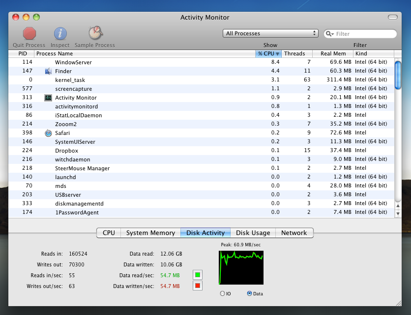

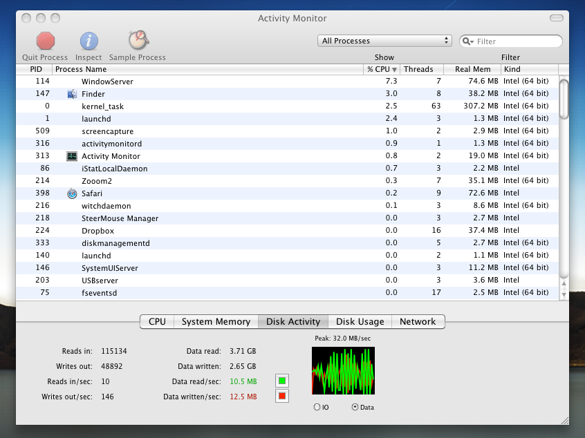

HCE Posted May 19, 2010 Share Posted May 19, 2010 Is dsdt responsible for slow SATA tranfer speeds on Gigabyte boards? I've come across this problem being discussed with regard to ASUS motherboards, and I was wondering if Gigabyte users experience the same issue: http://www.insanelymac.com/forum/index.php...1981&st=100 . Unfortunately, the fix suggested http://www.projectosx.com/forum/index.php?showtopic=564 brings no improvement for my board. I'm using a GA-P35-DS3L (ICH9 board), and I've noticed that transfers between native Mac OS Extended Journaled partitions are significantly slower than transfers between Mac and NTFS partitions (using Paragon NTFS). Transfers inside Windows 7 tell the same story, at double the speed I reach in Snow Leopard. My Seagate SATAII disk drives are not functioning at the speeds they used to function under Tiger or Leopard. In fact, they never get past 30-35 MB/s (that is the peak, the average transfer speed is much lower). Here are the relevant pics: I will post my dsdt.aml as well, in case anyone has any idea what may be wrong. Thank you. dsdt.zip Link to comment https://www.insanelymac.com/forum/topic/192518-dsdt-fixes-for-gigabyte-boards/page/72/#findComment-1471273 Share on other sites More sharing options...
