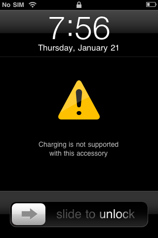

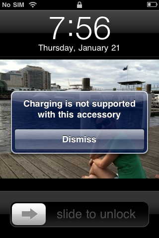

sk1nhead Posted January 21, 2010 Share Posted January 21, 2010 hhmm now this is weird.. my machine can't seem to charge my iPhone 3G via USB but on the older model 2G it's working.. iPhoto and iTunes can detect them but not charge the device.. anyone having this problem? ow it works on my MBP so i'm sure it's my hack that's causing this.. all i can think is the dsdt entry on my usb. TIA. Link to comment https://www.insanelymac.com/forum/topic/192518-dsdt-fixes-for-gigabyte-boards/page/66/#findComment-1391501 Share on other sites More sharing options...
kdawg Posted January 21, 2010 Share Posted January 21, 2010 hhmm now this is weird.. my machine can't seem to charge my iPhone 3G via USB but on the older model 2G it's working.. iPhoto and iTunes can detect them but not charge the device.. anyone having this problem? ow it works on my MBP so i'm sure it's my hack that's causing this.. all i can think is the dsdt entry on my usb. TIA. I know USB ports have to supply a certain amount of voltage in order for the iPod/iPhone to charge. Perhaps it's not supplying enough. Link to comment https://www.insanelymac.com/forum/topic/192518-dsdt-fixes-for-gigabyte-boards/page/66/#findComment-1391514 Share on other sites More sharing options...
mm67 Posted January 21, 2010 Share Posted January 21, 2010 hhmm now this is weird.. my machine can't seem to charge my iPhone 3G via USB but on the older model 2G it's working.. iPhoto and iTunes can detect them but not charge the device.. anyone having this problem? ow it works on my MBP so i'm sure it's my hack that's causing this.. all i can think is the dsdt entry on my usb. TIA. I'm not sure if this helps, but try using EHCI devices like this: Device (EHC1) { Name (_ADR, 0x001D0007) Name (_PRW, Package (0x02) {0x0D,0x04}) OperationRegion (PWRC, PCI_Config, 0x52, 0x2F) Field (PWRC, ByteAcc, NoLock, Preserve) { PMES, 16, Offset (0x2E), WRTA, 1 } } Device (EHC2) { Name (_ADR, 0x001A0007) Name (_PRW, Package (0x02) {0x0D,0x04}) OperationRegion (PWRC, PCI_Config, 0x52, 0x2F) Field (PWRC, ByteAcc, NoLock, Preserve) { PMES, 16, Offset (0x2E), WRTA, 1 } } and method INI like this: Method (_INI, 0, NotSerialized) { Store (One, ^PCI0.EHC1.WRTA) Store (One, ^PCI0.EHC2.WRTA) Sleep (0x5) Store (0xC9C2, ^PCI0.EHC1.PMES) Store (0xC9C2, ^PCI0.EHC2.PMES) } Link to comment https://www.insanelymac.com/forum/topic/192518-dsdt-fixes-for-gigabyte-boards/page/66/#findComment-1391520 Share on other sites More sharing options...
sk1nhead Posted January 21, 2010 Share Posted January 21, 2010 I know USB ports have to supply a certain amount of voltage in order for the iPod/iPhone to charge. Perhaps it's not supplying enough. Thanks kdawg... i think so too but i believe it's supplying too much power (not sure)?? BTW just own a 3Gs just today so i cant be sure if it's working on an unmodded orig dsdt - will test in a while.. @all - any 3Gs owners out there? did you ever experience problems like above? specially with dsdt shutdown/usb fix from mm67? TIA edit: I'm not sure if this helps, but try using EHCI devices like this: Device (EHC1) { Name (_ADR, 0x001D0007) Name (_PRW, Package (0x02) {0x0D,0x04}) OperationRegion (PWRC, PCI_Config, 0x52, 0x2F) Field (PWRC, ByteAcc, NoLock, Preserve) { PMES, 16, Offset (0x2E), WRTA, 1 } } Device (EHC2) { Name (_ADR, 0x001A0007) Name (_PRW, Package (0x02) {0x0D,0x04}) OperationRegion (PWRC, PCI_Config, 0x52, 0x2F) Field (PWRC, ByteAcc, NoLock, Preserve) { PMES, 16, Offset (0x2E), WRTA, 1 } } and method INI like this: Method (_INI, 0, NotSerialized) { Store (One, ^PCI0.EHC1.WRTA) Store (One, ^PCI0.EHC2.WRTA) Sleep (0x5) Store (0xC9C2, ^PCI0.EHC1.PMES) Store (0xC9C2, ^PCI0.EHC2.PMES) } thanks mm67.. will try that in a while - upgrading this phone to the latest 3.1.2 and will test it after.. i'm still using your golden EHC and INI Link to comment https://www.insanelymac.com/forum/topic/192518-dsdt-fixes-for-gigabyte-boards/page/66/#findComment-1391522 Share on other sites More sharing options...
kdawg Posted January 21, 2010 Share Posted January 21, 2010 Thanks kdawg... i think so too but i believe it's supplying too much power (not sure)?? BTW just own a 3Gs just today so i cant be sure if it's working on an unmodded orig dsdt - will test in a while.. @all - any 3Gs owners out there? did you ever experience problems like above? specially with dsdt shutdown/usb fix from mm67? TIA edit: thanks mm67.. will try that in a while - upgrading this phone to the latest 3.1.2 and will test it after.. i'm still using your golden EHC and INI What about adding something like this to your EHCI devices: Method (_DSM, 4, NotSerialized) { Store (Package (0x07) { "AAPL,current-available",0x05DC, "AAPL,current-extra",0x04B0, "AAPL,current-in-sleep",0x09C4, Buffer (One){0x00} }, Local0) DTGP (Arg0, Arg1, Arg2, Arg3, RefOf (Local0)) Return (Local0) } Link to comment https://www.insanelymac.com/forum/topic/192518-dsdt-fixes-for-gigabyte-boards/page/66/#findComment-1391530 Share on other sites More sharing options...
sk1nhead Posted January 21, 2010 Share Posted January 21, 2010 I'm not sure if this helps, but try using EHCI devices like this: Device (EHC1) { Name (_ADR, 0x001D0007) Name (_PRW, Package (0x02) {0x0D,0x04}) OperationRegion (PWRC, PCI_Config, 0x52, 0x2F) Field (PWRC, ByteAcc, NoLock, Preserve) { PMES, 16, Offset (0x2E), WRTA, 1 ......................... What about adding something like this to your EHCI devices: Method (_DSM, 4, NotSerialized) { Store (Package (0x07) { "AAPL,current-available",0x05DC, "AAPL,current-extra",0x04B0, ........................... } sync/charge via USB Phone 2G = OK iPod 160GB Classic = OK iPhone 32GB 3Gs = no joy for charge only sync what's funny is i restored/update the iPhone to 3.1.2 even with that warning (not charging) hehe.. anymore ideas or suggestion? good thing though is it's still syncing.. Link to comment https://www.insanelymac.com/forum/topic/192518-dsdt-fixes-for-gigabyte-boards/page/66/#findComment-1391581 Share on other sites More sharing options...
kdawg Posted January 21, 2010 Share Posted January 21, 2010 sync/charge via USB Phone 2G = OK iPod 160GB Classic = OK iPhone 32GB 3Gs = no joy for charge only sync what's funny is i restored/update the iPhone to 3.1.2 even with that warning (not charging) hehe.. anymore ideas or suggestion? good thing though is it's still syncing.. I have a 3G and 3GS iPhones. I'll play with it when I get home tonight and report back. I don't use my OSX86 machine to sync my phone so I'm curious to see. Link to comment https://www.insanelymac.com/forum/topic/192518-dsdt-fixes-for-gigabyte-boards/page/66/#findComment-1391588 Share on other sites More sharing options...
mm67 Posted January 21, 2010 Share Posted January 21, 2010 sync/charge via USB Phone 2G = OK iPod 160GB Classic = OK iPhone 32GB 3Gs = no joy for charge only sync what's funny is i restored/update the iPhone to 3.1.2 even with that warning (not charging) hehe.. anymore ideas or suggestion? good thing though is it's still syncing.. Have you tried all usb ports, I think that someone else had same kind of problem but ports on back plate did work. Link to comment https://www.insanelymac.com/forum/topic/192518-dsdt-fixes-for-gigabyte-boards/page/66/#findComment-1391595 Share on other sites More sharing options...
sk1nhead Posted January 21, 2010 Share Posted January 21, 2010 I have a 3G and 3GS iPhones. I'll play with it when I get home tonight and report back. I don't use my OSX86 machine to sync my phone so I'm curious to see. haha thanks again, unfortunately mine uses OSx86 for syncing because all my large media, podcast, appstore apps etc are in there.. well it's no biggie though since i can just transfer what i need to my MBP but it'll be a pain.. (edit: i forgot syncing is fine) this is the best i could get restore/update still a no go.. a screenshot of 2 iPhone plugged - the one on top is an iPhone 8GB 2G (charging and syncing).. i dont have a 3G iPhone so i have no means to test it.. weird e? Have you tried all usb ports, I think that someone else had same kind of problem but ports on back plate did work. thanks mm67 for the suggestion but yes i tried all four of my USB slot - i also tried 3 apple USB cable (2 from the iPhone2G and 3Gs and one from iPod with the lock mechanism) and all of them yield the same result - mounted but not charging and with an home screen error.. EDIT: booted on Windows 7 64bit and it's the same.. WT now what does it mean? BIOS (i'm on F10 right now but will try F9 or F8 a bit later)? broken USB (why it's only on the 3Gs)? defective motherboard??? hmmm.. new iPhone - new problem Link to comment https://www.insanelymac.com/forum/topic/192518-dsdt-fixes-for-gigabyte-boards/page/66/#findComment-1391599 Share on other sites More sharing options...

Sull Posted January 21, 2010 Share Posted January 21, 2010 My 3Gs charges fine. I sync my iPhone with my hack and charge... I have a different board... Link to comment https://www.insanelymac.com/forum/topic/192518-dsdt-fixes-for-gigabyte-boards/page/66/#findComment-1391683 Share on other sites More sharing options...
sk1nhead Posted January 21, 2010 Share Posted January 21, 2010 My 3Gs charges fine. I sync my iPhone with my hack and charge... I have a different board... YES turns out it's not the iPhone 3Gs nor OSX86.. but what could be the culprit? EDIT: booted on Windows 7 64bit and it's the same.. WT now what does it mean? BIOS (i'm on F10 right now but will try F9 or F8 a bit later)? broken USB (why it's only on the 3Gs)? defective motherboard??? hmmm.. new iPhone - new problem Link to comment https://www.insanelymac.com/forum/topic/192518-dsdt-fixes-for-gigabyte-boards/page/66/#findComment-1391693 Share on other sites More sharing options...
Sull Posted January 21, 2010 Share Posted January 21, 2010 Did you try a different cable. ? Link to comment https://www.insanelymac.com/forum/topic/192518-dsdt-fixes-for-gigabyte-boards/page/66/#findComment-1391709 Share on other sites More sharing options...
