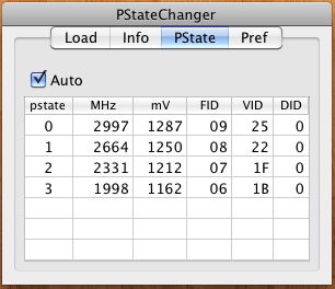

I have a Q6600 overclocked to 3,0ghz . I've noticed that whatever the cpu vcore i set in bios, when SL boots it overrides my setting
here is what pstatechanger reads.
I'm running 48° with a noctua u12 heatsink
what modifications should i make (dsdt, kext loading) to enjoy the benefit of best speedstep (and power when i need it)
all in bios is set to enabled regarding C1E and all that stuff
thank you
