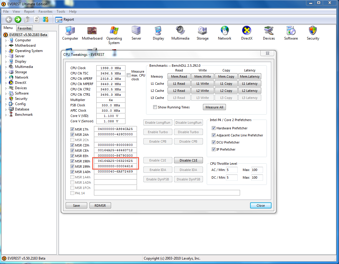

FKA Posted July 6, 2010 Author Share Posted July 6, 2010 If you have Windows too check what Everest shows. On my MSI boards SSDT dump VID's are 1B and 28, that's what I saw in Everest, didn't check with VoodooMonitor. not sure what I'm meant to be looking for in Everest - however the SSDT _PSS I posted earlier was taken from an Everest dump. CPU-Z and Everest are showing vCore idle @1.09v in Win7 Voodoo monitor is currently showing idle @1.052v (I believe C1E has kicked in here as vCore for lowest multi is 1.084 as shown in voodoo monitor.) So nothing too much to worry about - just don't understand the disparity?! D Link to comment https://www.insanelymac.com/forum/topic/181631-dsdt-vanilla-speedstep-generic-scope-_pr/page/69/#findComment-1505390 Share on other sites More sharing options...
mm67 Posted July 6, 2010 Share Posted July 6, 2010 not sure what I'm meant to be looking for in Everest - however the SSDT _PSS I posted earlier was taken from an Everest dump. CPU-Z and Everest are showing vCore idle @1.09v in Win7 Voodoo monitor is currently showing idle @1.052v (I believe C1E has kicked in here as vCore for lowest multi is 1.084 as shown in voodoo monitor.) So nothing too much to worry about - just don't understand the disparity?! D You should see some familiar numbers here: And yes, I wouldn't worry too much, everything seems to be working. Link to comment https://www.insanelymac.com/forum/topic/181631-dsdt-vanilla-speedstep-generic-scope-_pr/page/69/#findComment-1505572 Share on other sites More sharing options...

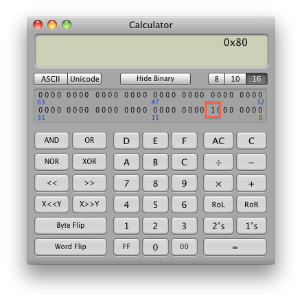

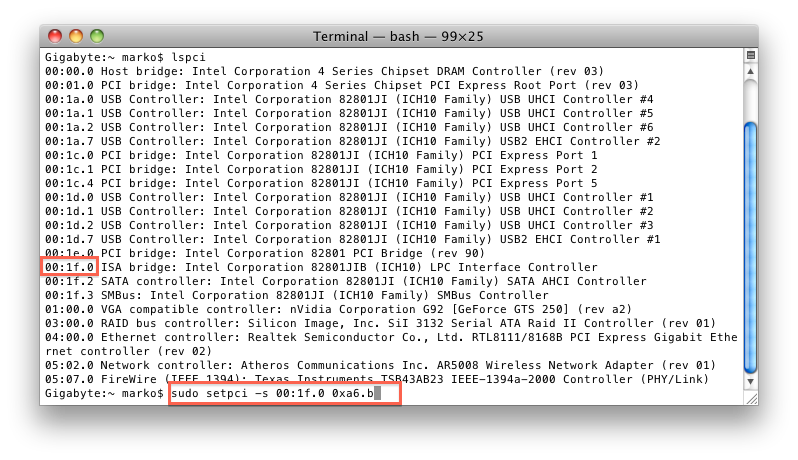

00diabolic Posted July 9, 2010 Share Posted July 9, 2010 Download ICH10 datasheet and read page 455. Notice bit 7. Then get ICH8M datasheet and check if it has a similar bit. If yes then you can try to use lspci to check if deeper C-states work. That CSTInfo in ioreg says that you have some C-states, but it doesn't say how many. I have the bit mm67. How do I check with lspci the c-states? I am still having trouble with my speedstep.. SOOOO I tried something that I never thought would actually work and it did not but it was close. I booted up with a MB4,1 DSDT in place. It booted really slow and actually got all the way through to the gui. Frozen on the blue screen right before you hit the desktop. I had to do a complete bios reset to get back to where I am now which makes sense. I did this for 2 reasons. 1 to see if it would work as my system is so close to a MB4,1. Also because I'm frustrated that speedstep is still not working as well as it should be. I was seeing stepping in voodoo monitor now I am seeing a single frozen state as I was before I made the change to fake model. Now I have a theory and it leads me back to the DSDT and thus this test. I believe the problem I have has to do with my DSDT not being specific enough to properly load the framework for speedstep correctly. For example SBUS as outlined in post 399 in this thread by Master Chief. He indicates the sbus helps ID your CPU and I have the problem he is refering to. He has 2 lists on that post.. Off the first list I have. 51 0 0x553ec000 0x3000 0x2000 com.apple.driver.AppleFileSystemDriver (2.0) <18 4 3>3 1> 62 0 0x5b470000 0x7000 0x6000 com.apple.iokit.SCSITaskUserClient (2.6.5) <54 18 5 4 3 1> 83 0 0x5b927000 0x7000 0x6000 com.apple.driver.AppleIntelMeromProfile (19) <73 6 5 4 3> <-- NOT MY CPU 96 0 0x5ba9f000 0x8000 0x7000 com.apple.driver.AppleIntelNehalemProfile (11) <73 6 4 3> <-- NOT MY CPU 103 0 0x5bb2b000 0x5000 0x4000 com.apple.driver.AppleIntelYonahProfile (14) <73 6 4 3> <-- NOT MY CPU 110 0 0x54e3f000 0x9000 0x8000 com.apple.driver.AppleTyMCEDriver (1.0.1d8) <77 14 13 7 6 5 4 3 1> Off the second list I only have 35 1 0x55185000 0x3000 0x2000 com.apple.iokit.IOSMBusFamily (1.1) <5 4 3> My cpu is com.apple.driver.AppleIntelPenrynProfile (17) <73 6 4 3> which is also loaded but I dont need the rest of them and they prob cause more trouble there there worth. This also must be affecting speedstep. Since the system is loading all the other CPU profiles It must not be able to properly load a speedstep profile for me either, thus it half works. This is a theory of course. I would like to hear other ideas. I know it all boils down to the DSDT though. Here is the kernel log for the MB4,1 DSDT load. Interesting results.. Froze at SMC is stuck and cannot recover. Must be a SMC device in the MB4,1 DSDT that I dont have that caused the freeze. If I removed it maybe it would load. But where is it? kernel[0]: npvhash=4095 kernel[0]: PAE enabled kernel[0]: 64 bit mode enabled kernel[0]: Darwin Kernel Version 10.4.0: Fri Apr 23 18:28:53 PDT 2010; root:xnu-1504.7.4~1/RELEASE_I386 kernel[0]: vm_page_bootstrap: 970906 free pages and 77670 wired pages kernel[0]: standard timeslicing quantum is 10000 us kernel[0]: mig_table_max_displ = 73 kernel[0]: AppleACPICPU: ProcessorId=0 LocalApicId=0 Enabled kernel[0]: AppleACPICPU: ProcessorId=1 LocalApicId=1 Enabled kernel[0]: calling mpo_policy_init for Quarantine kernel[0]: Security policy loaded: Quarantine policy (Quarantine) kernel[0]: calling mpo_policy_init for Sandbox kernel[0]: Security policy loaded: Seatbelt sandbox policy (Sandbox) kernel[0]: calling mpo_policy_init for TMSafetyNet kernel[0]: Security policy loaded: Safety net for Time Machine (TMSafetyNet) kernel[0]: Copyright © 1982, 1986, 1989, 1991, 1993 kernel[0]: The Regents of the University of California. All rights reserved. kernel[0]: MAC Framework successfully initialized kernel[0]: using 16384 buffer headers and 4096 cluster IO buffer headers kernel[0]: VoodooMonitor: © 2009 Mojodojo, All Rights Reserved. Based on VoodooPower code by superhai. Special thanks to markswell for cpuid utilities. kernel[0]: IOAPIC: Version 0x20 Vectors 64:87 kernel[0]: ACPI: System State [s0 S3 S4 S5] (S3) kernel[0]: AppleIntelCPUPowerManagement: initialization complete kernel[0]: netkas presents fakesmc, a kext which emulates smc device kernel[0]: Sleep failure code 0x00048000 0x1000da6d kernel[0]: mbinit: done (64 MB memory set for mbuf pool) kernel[0]: From path: "uuid", kernel[0]: Waiting for boot volume with UUID A7538321-92AC-3B73-89C5-42EDD8DED244 kernel[0]: Waiting on <dict ID="0"><key>IOProviderClass</key> <string ID="1">IOResources</string><key>IOResourceMatch</key> <string ID="2">boot-uuid-media</string></dict> kernel[0]: com.apple.AppleFSCompressionTypeZlib kmod start kernel[0]: com.apple.AppleFSCompressionTypeZlib load succeeded kernel[0]: AppleIntelCPUPowerManagementClient: ready kernel[0]: Got boot device = IOService:/AppleACPIPlatformExpert/PCI0/AppleACPIPCI/SATA@1F,2 /AppleICH8AHCI/PRT0@0/IOAHCIDevice@0/AppleAHCIDiskDriver/ IOAHCIBlockStorageDevice/IOBlockStorageDriver/HITACHI HTS545032B9A300 Media/ IOFDiskPartitionScheme/Untitled 2@2 kernel[0]: BSD root: disk0s2, major 14, minor 2 kernel[0]: USBMSC Identifier (non-unique): 222222222222 0x152d 0x2338 0x100 kernel[0]: USBMSC Identifier (non-unique): 5LAEYKSL 0x4c5 0x201d 0x1 kernel[0]: hfs: Removed 1 orphaned / unlinked files and 0 directories kernel[0]: systemShutdown false kernel[0]: Waiting for DSMOS... kernel[0]: Previous Shutdown Cause: 0 kernel[0]: wl0: Broadcom BCM4328 802.11 Wireless Controller kernel[0]: 5.10.91.27 kernel[0]: SMS::setupInts ERROR: checkForInvalidInts failed (kSMCKeyNotFound) kernel[0]: SMS::initHelper ERROR setupInts failed (kSMCKeyNotFound) kernel[0]: SMS::initHelperStatic ERROR: initHelper failed (kSMCKeyNotFound), NOT calling registerService() kernel[0]: IG: Invalid firmware max backlight setting kernel[0]: VoodooHDADevice[0x465d3000]::init kernel[0]: nid 11 is input monitor kernel[0]: Enabling input audio routing switching at node 24: kernel[0]: Enabling output audio routing switching at node 27: kernel[0]: TIMEOUT numcmd=1, sent=1, received=0 15:57:46: --- last message repeated 1 time --- kernel[0]: error: codec #1 is not responding, probing aborted kernel[0]: Pin sense: cad 0 nid=24 res=0 kernel[0]: switch nid 34 conn 0 off kernel[0]: mute nid 34 conn 0 off kernel[0]: switch nid 34 conn 1 on kernel[0]: mute nid 34 conn 1 on kernel[0]: setDesc change description Microphone (CD) channel 1 assoc 1 kernel[0]: Pin sense: cad 0 nid=27 res=0 kernel[0]: setDesc change description Speaker (CD) channel 0 assoc 0 kernel[0]: Sound assertion "!fProvider->open ( this )" failed in "/SourceCache/ AppleHDA/AppleHDA-187.4.1/AppleHDAController/ AppleHDAController.cpp" at line 299 goto Exit kernel[0]: DSMOS has arrived kernel[0]: IntelMemory::init kernel[0]: --- last message repeated 1 time --- kernel[0]: InitPool: offset= 0x08000000 size = 0x08000000 kernel[0]: com_ZyDAS_driver_ZD1211USB: Ethernet address 00:0e:2e:70:fe:b8 kernel[0]: AirPort_Brcm43xx: Ethernet address 00:1f:e1:50:a6:03 kernel[0]: IO80211Controller::dataLinkLayerAttachComplete(): adding AppleEFINVRAM notification kernel[0]: display: Not usable kernel[0]: SMC::smcSMCInABadState ERROR: SMC is stuck and cannot recover What I want to do is mod my DSDT to hopefully fix it closer to the Macbook4,1 but I am lost. Every time I try to add something I get compile errors. I'm simply not skilled enough. Can someone help me with this? Maybe give me some tips on editing the DSDT. I need to overhaul mine. What if I copy every device from the MB4,1 DSDT and its structure and set mine up exactly like that. Will that work? Its really close to this MB4,1 DSDT as it is but some additional items here and there and some names changed. I guess if I could figure out what I needed to keep in mine and go from that then id almost have it. Thanks 00D Link to comment https://www.insanelymac.com/forum/topic/181631-dsdt-vanilla-speedstep-generic-scope-_pr/page/69/#findComment-1507570 Share on other sites More sharing options...
mm67 Posted July 9, 2010 Share Posted July 9, 2010 I have the bit mm67. How do I check with lspci the c-states? First you use lspci to find address of your LPC controller, then you use setpci command to read a specific register, on ICH10 that register is A6 and register is 8 bits long so I use sudo setpci -s 0:1f.0 0xa6.b. Let's say result from command is 80, I open Calculator, put it to Programmer mode and input value 80. From the picture you can see that bit 7 is set. Link to comment https://www.insanelymac.com/forum/topic/181631-dsdt-vanilla-speedstep-generic-scope-_pr/page/69/#findComment-1507625 Share on other sites More sharing options...
