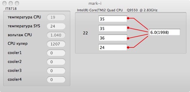

You never used mark-i ? You could have seen C-states working long time ago with that one :)
Just trying to keep up with you young fellows... :P
I tried mark-i some time ago, felt like an obscure app with the russian and all.
Downloaded from kdawgs link a few posts back and looks like I've got the wrong one - must be an all english version out there somewhere.
Hers a snapshot of what I mean...
Sorry to be off topic...
Your version is just as english as mine :) On left side third value from up is cpu voltage. Above that are NB and CPU temperatures.

Hi,
after a lot of struggling i managed to compile dsdt with right speedstepcode -at least i hope so- and even got rid of my C-state errors.
Now: how can i tell, if speedstep REALLY works? None of the .kexts from 1st topic will load on Leopard ;)
cpu-x ALWAYS shows max. multiplier
Hardware monitor does´t seem to be able to monitor the frequency
sysctl | grep ...cpufrequency always outputs max. frequency
Is there a way to monitor the CPU frequency? Perhaps without loading further .kexts?
?? voodoomonitor and voodoomonitor.kext work fine in leopard ??
Hi,
Now: how can i tell, if speedstep REALLY works..
I would try mark-i first, it'll show proper C and P states. For some reason VooDoo Monitor show false voltage changes. You'll need to add ringacess.kext to your extras folder for mark-i. mark-i can be found somewhere in here from one of my posts.
