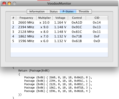

mitch_de Posted November 13, 2009 Share Posted November 13, 2009 [*]voodoomonitor shows my 9X voltage at 1.244 and my 6X voltage at 1.068 whereas voodoopstate shows 1.137 and 1.000 for those same multipliers, respectively. The values used by voodoopstate match my SSDT. Additionally the p-state tab in voodoomonitor shows yet another voltage for 6x (1.148) and the control column seems to have the wrong vid values I'd like to get this sorted out completely. Currently I think my SSDT tables are giving me working stepping but I'm not sure if the voltages are right. I could probably get to the bottom of this if the source for voodoomonitor was available. Is it?Thanks I believe that the speedstep tools which can show mVs show different mVolts because they do an different conversion (formula) getting mVolts from the acutal read(MSR) VID(that hex in PSS) . Any speedstep tool reads out VID and not mVolts (are not readable) and must convert that VID like 20hex to zzzz mVolts. CPU-X, which cant show mVolts only use thar hw.xyz kernel varibale to get MHz, not read MSR for MHZ. Also that gives sometimes different MHZ, if the speedstep tool didnt also update that kernel variable for MHz. CPU-X cant see MHZ changes in this case. The VID itself and "real mVolts" are same (i am 99% sure). If all Tools would show also VID beside mVolts, we would see that VIDs same, only mVolts (computed of of VID) maybe "virtually" different. MSR Tools, superhais & other voodoo, & .... may show different mVolts at same VID=same mVolts in real. So more an cosmetic problem. Link to comment https://www.insanelymac.com/forum/topic/181631-dsdt-vanilla-speedstep-generic-scope-_pr/page/32/#findComment-1329319 Share on other sites More sharing options...

bcc9 Posted November 13, 2009 Share Posted November 13, 2009 voodoomonitor fix #1: I looked at the source to the older cpu-i and see that it's using the wrong equation for the voltage: inline UInt32 IntelGetVoltage(UInt8 vid) { return 700 + ((vid & 0x3F) << 4); } whereas for my 45nm cpu the voltage should be as in voodoopstate (which is in turn from voodoopower): inline UInt32 IntelGetCoreNewVoltage(UInt8 vid) { return (1425 + ((vid & 0x3F) * 25)) >> 1; } thus for vid=0x22, cpu-i and voodoomonitor report 1.244 whereas the right value is 1.137 this part *is* effectively cosmetic (but damn confusing). It's also just 1 of the several issues I mentioned... Link to comment https://www.insanelymac.com/forum/topic/181631-dsdt-vanilla-speedstep-generic-scope-_pr/page/32/#findComment-1329368 Share on other sites More sharing options...

blackosx Posted November 13, 2009 Share Posted November 13, 2009 If you're converting the voltages reported by voodoomonitor back into vid values yourself and you have a 45nm intel cpu then yes. If you're using the control value column, then I'm not sure. Mine are screwy and don't match up with the other tabs. My E7300 is an 45nm CPU. Yes I just copied the values from the control value column reported by VoodooMonitor in to my _PSS method (See attached image) So I believe it's correct. HID+pointer would be your mouse. Probably I/O overflow of some sort. Okay. Thanks Link to comment https://www.insanelymac.com/forum/topic/181631-dsdt-vanilla-speedstep-generic-scope-_pr/page/32/#findComment-1329409 Share on other sites More sharing options...
bcc9 Posted November 13, 2009 Share Posted November 13, 2009 My E7300 is an 45nm CPU. Yes I just copied the values from the control value column reported by VoodooMonitor in to my _PSS method (See attached image) So I believe it's correct. Well I don't know, it's definitely wrong for my system. With voodoomonitor on the p-state tab, I see: 6x multiplier, 1.068v voltage (which would correspond to a vid of 0x17 and an actual voltage of 1.0000) on the p-state tab: 6x multiplier, 1.180 voltage, 0x61e control (ie a 0x1e vid which is not correct - does not match the SSDT) The 9x multiplier is consistent between those 2 voodoomonitor tabs however. My CPU has super-lfm modes which is probably breaking voodoomonitor's p-state tab completely. Screen shot if you want. Link to comment https://www.insanelymac.com/forum/topic/181631-dsdt-vanilla-speedstep-generic-scope-_pr/page/32/#findComment-1329413 Share on other sites More sharing options...
blackosx Posted November 13, 2009 Share Posted November 13, 2009 Well I don't know, it's definitely wrong for my system. With voodoomonitor on the p-state tab, I see:6x multiplier, 1.068v voltage (which would correspond to a vid of 0x17 and an actual voltage of 1.0000) on the p-state tab: 6x multiplier, 1.180 voltage, 0x61e control (ie a 0x1e vid which is not correct - does not match the SSDT) The 9x multiplier is consistent between those 2 voodoomonitor tabs however. My CPU has super-lfm modes which is probably breaking voodoomonitor's p-state tab completely. Screen shot if you want. I don't know any more than what I have shown to you, so maybe one of the more knowledgeable people can help throw some light on your finding. Sorry bcc9. Link to comment https://www.insanelymac.com/forum/topic/181631-dsdt-vanilla-speedstep-generic-scope-_pr/page/32/#findComment-1329444 Share on other sites More sharing options...

bcc9 Posted November 13, 2009 Share Posted November 13, 2009 I don't know any more than what I have shown to you, so maybe one of the more knowledgeable people can help throw some light on your finding. Sorry bcc9.For the p-state tab, I believe I already have identified the problem and made a fix. As I posted in the voodoopstate thread, voodoopstate (and voodoopower) are using the wrong vid values for their computed p-state due to roundoff errors (as well as being thrown off by the super-lfm frequencies). See the voodoopstate thread for my fixed version. It looks like voodoomonitor is just replicating the problem in its p-state tab. Link to comment https://www.insanelymac.com/forum/topic/181631-dsdt-vanilla-speedstep-generic-scope-_pr/page/32/#findComment-1329514 Share on other sites More sharing options...

FKA Posted November 13, 2009 Author Share Posted November 13, 2009 Well I don't know, it's definitely wrong for my system. With voodoomonitor on the p-state tab, I see:6x multiplier, 1.068v voltage (which would correspond to a vid of 0x17 and an actual voltage of 1.0000) on the p-state tab: 6x multiplier, 1.180 voltage, 0x61e control (ie a 0x1e vid which is not correct - does not match the SSDT) Hi bcc9 Are you sure that the 6x @1.068v isn't C1? @ 6x my correct voltage should be 1.084v but most of the time it's bouncing around 1.116v when there is maybe 3 > 4% cpu load. It hits 1.084v for short periods with 1 > 2% load and drops to 1.052v with 0 >1% loading - which I assume is C1?! D. Ladies & gentleman - get ready to rumble your dsdt compiling/disassembling New IASL + iASLme Tool (iasl is new, rest same) available - Nov 2009 Version OUT ! Source was out a few hours - mitch compiled again. You cant get it faster SALES! 100% off http://www.insanelymac.com/forum/index.php?showtopic=189272 Nice one mitch - many thanks! Link to comment https://www.insanelymac.com/forum/topic/181631-dsdt-vanilla-speedstep-generic-scope-_pr/page/32/#findComment-1329718 Share on other sites More sharing options...
