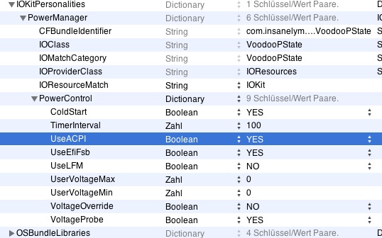

mitch_de Posted November 13, 2009 Share Posted November 13, 2009 zoliky: Be carefull to "take" PState values from others ! What never showed in all Pstates listed here is the FSB (in MHZ) which is used. The MHZ Values + mWatts values shown in the PSS lines are cosmetic/information and make no difference to the stepping. multi + VID is the main thing in each pss entry , that 0x0820 for example. 8 * FSB, 20hex VID. The second 0x0820 in the PSS is the same value and its used as an validate check. Some use here nothing, or 01, 02,....but thats at least not ACPI standard ! So YOU must safe that X* FSB is not OC eXtreme ! That isnt a problem with standard = unchanged FSB. But if you, like me =266 MHz FSB > 333 MHz FSB use the FSB for OC you must be very carefull and set correct multipliers (06zz, 07zz,...) in the PSS! Link to comment https://www.insanelymac.com/forum/topic/181631-dsdt-vanilla-speedstep-generic-scope-_pr/page/33/#findComment-1329878 Share on other sites More sharing options...

mitch_de Posted November 15, 2009 Share Posted November 15, 2009 Thanks. Do i need an newer PstateCahnger also ? I ask because zero mVolts shown, even all VIDs (to compute mV) are listed .All other is great working HINT: I set .kext by .plist to useACPI, which my OC_by_FSB cpu needs , voodooPstate is based on voodoopower and would take(reads cpu type) wrong 10* multi on my system=KP, even there is no 10* in dsdt PSS(=ACPI). I OC by FSB 266>333MHz on C2D 2.66 cpu. 10*333 would give to high OC, so PState 0 is 9*333=3000MHz (also BIOS multi is set dwon to 9*) , not 10*=3333MHz in my case. So if you get KPs and have working Pstates try to set useACPI in all voodoopower based .kext. useACPI reads your Pstates (dsdt) and not use cpu type standard Pstates. That non ACPI voodooway often KPs on FSB OC systems! Link to comment https://www.insanelymac.com/forum/topic/181631-dsdt-vanilla-speedstep-generic-scope-_pr/page/33/#findComment-1331417 Share on other sites More sharing options...

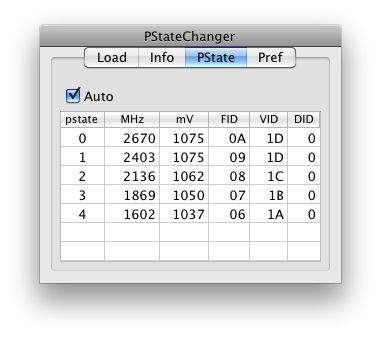

blackosx Posted November 16, 2009 Share Posted November 16, 2009 I have now used PStateChanger with VoodooPstate(bcc9's v4) to recalculate my values for P-states. They did read Package (0x06) { 2660, 0, 10, 10, 0x0A1D, 0 }, Package (0x06) { 2394, 0, 10, 10, 0x091C, 1 }, Package (0x06) { 2128, 0, 10, 10, 0x081C, 2 }, Package (0x06) { 1862, 0, 10, 10, 0x071B, 3 }, Package (0x06) { 1596, 0, 10, 10, 0x061B, 4 } and now read Package (0x06) { 2670, 0, 10, 10, 0x0A1D, 0 }, Package (0x06) { 2403, 0, 10, 10, 0x091D, 1 }, Package (0x06) { 2136, 0, 10, 10, 0x081C, 2 }, Package (0x06) { 1869, 0, 10, 10, 0x071B, 3 }, Package (0x06) { 1602, 0, 10, 10, 0x061A, 4 } So a slight change which must be down to the rounding. So Thanks bcc9 for pointing this out. Link to comment https://www.insanelymac.com/forum/topic/181631-dsdt-vanilla-speedstep-generic-scope-_pr/page/33/#findComment-1332486 Share on other sites More sharing options...
mitch_de Posted November 16, 2009 Share Posted November 16, 2009 Do yout get the mVolts shown ? (In PstateChanger) (look my screenshoots - no mVolts, but VIDs ?! ) If you perhaps i have an older version, can you share yours ? Someone else where PstateChanger + the kext V4 cant show mVolts but all others? Link to comment https://www.insanelymac.com/forum/topic/181631-dsdt-vanilla-speedstep-generic-scope-_pr/page/33/#findComment-1332488 Share on other sites More sharing options...
blackosx Posted November 16, 2009 Share Posted November 16, 2009 Do yout get the mVolts shown ? (In PstateChanger) (look my screenshoots - no mVolts, but VIDs ?! )If you perhaps i have an older version, can you share yours ? Someone else where PstateChanger + the kext V4 cant show mVolts but all others? Hi mitch I am using PstateChanger v1.0.3 (1) + the kext V4 posted by FormerlyKnownAs a couple of posts ago. It shows mVolts on mine. Here's a grab. Link to comment https://www.insanelymac.com/forum/topic/181631-dsdt-vanilla-speedstep-generic-scope-_pr/page/33/#findComment-1332493 Share on other sites More sharing options...
bcc9 Posted November 16, 2009 Share Posted November 16, 2009 Do yout get the mVolts shown ? (In PstateChanger) (look my screenshoots - no mVolts, but VIDs ?! )If you perhaps i have an older version, can you share yours ? Someone else where PstateChanger + the kext V4 cant show mVolts but all others? I'm assuming you have your 0 volt problem with hnak's versions as well, or is it something I broke? I'm not seeing that problem, and my PMs indicate that it's working OK for others. That v4 version is the latest&greatest if you want to play with my changes. The 0 volt issue should be easy to debug from the source, please do Link to comment https://www.insanelymac.com/forum/topic/181631-dsdt-vanilla-speedstep-generic-scope-_pr/page/33/#findComment-1332496 Share on other sites More sharing options...
