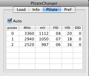

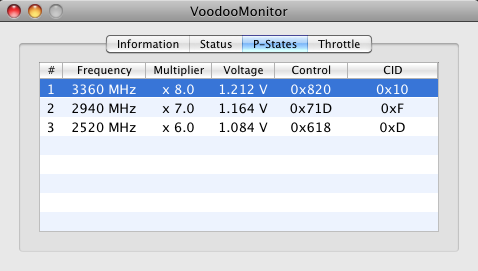

Can somebody riddle this for me:
Pstatechanger and voodoopstate give me a slightly lower vid for my x7 and x6 multi so I've amended my PSS accordingly.
        Method (_PSS, 0, NotSerialized)
           Return (Package (0x03)
               Package (0x06)
                   Zero,
                   Zero,
                   0x0A,
                   0x0A,
                   0x0820,
                   Zero
               Package (0x06)
                   Zero,
                   Zero,
                   0x0A,
                   0x0A,
                   0x071B,
                   One
               Package (0x06)
                   Zero,
                   Zero,
                   0x0A,
                   0x0A,
                   0x0616,
                   0x02

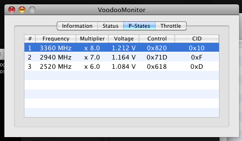

But voodoomonitor shows:
I've run this with and without _PSD method and with _PSD method using 0xFE (Hardware control) and get the same results.
Does this simply tally with the rounding involved with voodoopower's calculation?
D
As you questioned, I would guess it's down to the rounding. I got the same with my figures. Voodoomonitor still shows the old values, even though _PSS has the new values shown by Pstatechanger.
