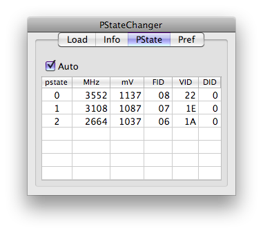

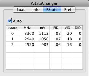

Can somebody riddle this for me:
Pstatechanger and voodoopstate give me a slightly lower vid for my x7 and x6 multi so I've amended my PSS accordingly.
...But voodoomonitor shows
Yes, the lower vids are the whole point of the roundoff fix.
Voodoomonitor's pstate tab, like pstatechanger's are static calculations made by them, not read from your PSS or from your cpu's current p-state.

Can you please post me your DSDT.dsl file and the FID/VID values you have taken from pstatechanger.
D.
Ok. I have attached the DSDT with FID/VID values.

@FKA
So is this what you're using for your Q9450?
		Method (_PSS, 0, NotSerialized)
		Return (Package (0x03)
			Package (0x06) { Zero, Zero, 10, 10, 0x00000822, 0 },
			Package (0x06) { Zero, Zero, 10, 10, 0x0000071E, 1 },
			Package (0x06) { Zero, Zero, 10, 10, 0x0000061A, 2 }
I was using:
			Package (0x06) { 3552, 75000, 10, 10, 0x00000820, 0 },
			Package (0x06) { 3108, 65000, 10, 10, 0x0000071C, 1 },
			Package (0x06) { 2664, 60000, 10, 10, 0x0000061A, 2 }
It seems we should have arrived at the same settings since we have the same processor.
@FKA
I was - I only ran the fixed voodoopstate-v4 yesterday and I get:
Which is what I'm using now.
Note: I'm only Oclocked to 3.36GHz
