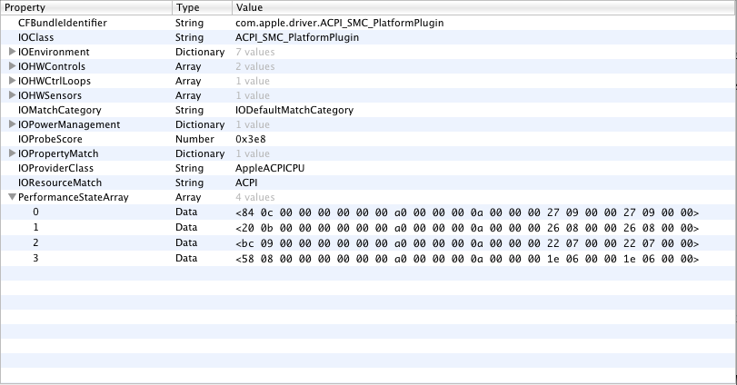

Master Chief Posted September 22, 2009 Share Posted September 22, 2009 Thanks i will change that.Here my IOREGISTRY output (before i changed that CFGD part) , PeformanceStates are loaded/used if i use superhais speedstep. Or what did you meaned with "do you see the tables" ? I was referring to: Root -> MacPro3,1 -> AppleACPIPlatformExpert -> ACPI Tables Pic shows situation with no AppleINTELCPU and no speedstep loaded+active. CPU runs cool, even without speedstep loaded (MSR shows that it runs always at max speed). less than 40 Celsius idle, 55 Celsius CPU load OC from 2.66 to 3.0 GHZ. Pic? As in picture? What picture are you talking about? I don't see one, except for the one in your post. How can i see if Cstates are found , where do they listed in the IOREGISTRY ? There should not be any _CST related errors at startup, and you see a CSTinfo property with IORegistryExplorer - you might want to read the whole thread I have no idea what you say there...Chameleon and SMBIOS patching works just fine with RC3 version on all my hardware in snow leopard... What I said was pretty clear as in I use ChameleonSM v1.1.12 on Leopard, and that it won't set/select the correct CPU speed. At least not without that snippet in com.apple.Boot.plist. And it also won't work with Snow Leopard. Presence of all table in OS X ioreg is not required... If that was true, then why won't C-States work on my Mac without them in the ACPI table? Also be aware that smc_platform_plugin has some limitations on P-States nr., if they are less or more then original model(used) it will print an error(fixable with dummy smc_platform.kext) Interesting. I didn't knew that. Can you please elaborate how this works? Thanks! Also for those who can't figure out how to get the value for .5 multi they can use voodoopower.kext and dump the log as described HERE The result will be something like this... I wonder if this method will list 0x4720 as maximum for my CPU because 0x8720 did end in a forced reboot (after the KP). See also Superhai's post #156 Link to comment https://www.insanelymac.com/forum/topic/181631-dsdt-vanilla-speedstep-generic-scope-_pr/page/11/#findComment-1276271 Share on other sites More sharing options...

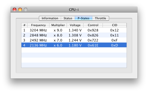

Superhai Posted September 22, 2009 Share Posted September 22, 2009 I wonder if this method will list 0x4720 as maximum for my CPU because 0x8720 did end in a forced reboot (after the KP). See also Superhai's post #156 0x8720 would be odd (and very high voltage for such a low frequency). You can have 0x88 (800MHz on 200MHz FSB) or 0x86 (600MHz on 200MHz FSB) if your CPU support SLFM. 0x47 is multiplier 7.5. Link to comment https://www.insanelymac.com/forum/topic/181631-dsdt-vanilla-speedstep-generic-scope-_pr/page/11/#findComment-1276413 Share on other sites More sharing options...

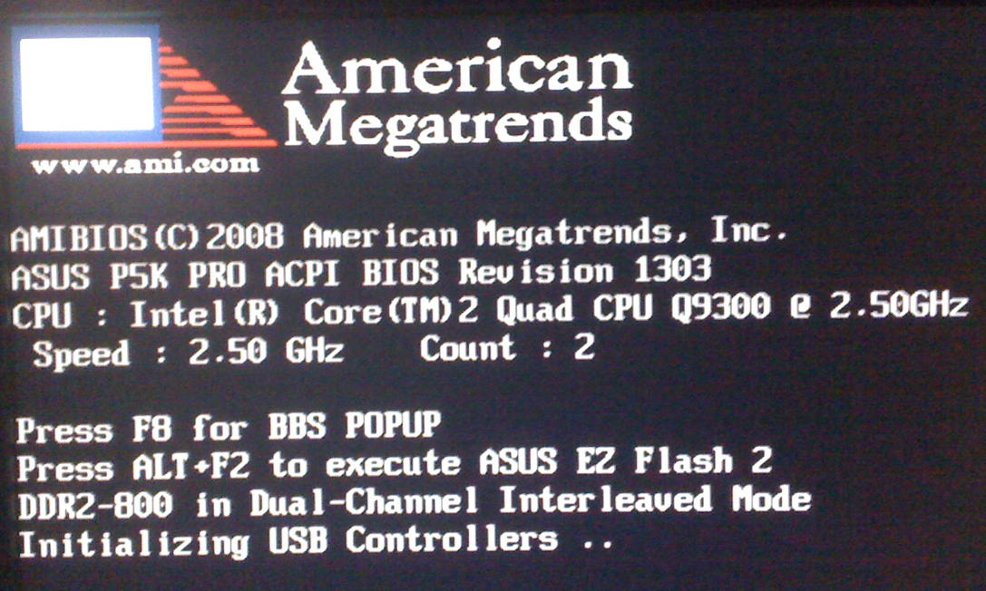

Master Chief Posted September 22, 2009 Share Posted September 22, 2009 0x8720 would be odd (and very high voltage for such a low frequency). You can have 0x88 (800MHz on 200MHz FSB) or 0x86 (600MHz on 200MHz FSB) if your CPU support SLFM. 0x47 is multiplier 7.5. Just what I thought. Thanks. Now a very important note: I somehow smoked a perfectly good functioning Intel Q9300 running @2.5Ghz so everyone here is warned!!! n.b. I have a picture of the BIOS startup screen showing only two cores (I had to boot into Leopard on the same hack first, simply because of the stutter (that's how bad it is). Anyway, enjoy the attached picture while I take a shower and rethink what I did. I was happy to have two of them – thanks to the supplier for making the error – including another P5K PRO motherboard, but I will not continue experimenting. And now I have to fix this craptastic stutter, but I have no idea why, especially since I am using my Leopard DSDT?!? Any pointers as to where I should be looking first? Link to comment https://www.insanelymac.com/forum/topic/181631-dsdt-vanilla-speedstep-generic-scope-_pr/page/11/#findComment-1276833 Share on other sites More sharing options...
FKA Posted September 22, 2009 Author Share Posted September 22, 2009 Just what I thought. Thanks. Now a very important note: I somehow smoked a perfectly good functioning Intel Q9300 running @2.5Ghz so everyone here is warned!!! ouch! do you have any idea what you did wrong? overvolted with the aformention VID ? or the corrupt BIOS you flashed ? D Link to comment https://www.insanelymac.com/forum/topic/181631-dsdt-vanilla-speedstep-generic-scope-_pr/page/11/#findComment-1276852 Share on other sites More sharing options...
Master Chief Posted September 22, 2009 Share Posted September 22, 2009 ouch! do you have any idea what you did wrong? overvolted with the aformention VID ? or the corrupt BIOS you flashed ? D Not really. And that BIOS issue I was having was really my own fault: I used the DVD that came with the motherboard to flash the original BIOS. Which of course was way too old and thus did not support my CPU and thus I had to install two other CPU's to get it going again. That's how old it was. Anyway I was using the latest BIOS (1303) and everything was working just fine. And for some time already. Until I got this KP and had to do a reboot. Which of course failed for only 2 cores. At first I didn't even noticed that it said something about the CPU, but then I did another reboot and noticed the 2 in my boot screen. I checked the BIOS settings and "Max CPUID Value Limit" was disabled so that was not it. My P-State changes are very limited/relaxed so that can't be it (planning to attach them later). I did try The Kings 0x8720 multiplier and got a KP, but that was it. At least that's what I thought. I am however not blaming him nor anyone else but myself for getting into this trouble. Now back to Snow Leopard and fixing the stutter. Link to comment https://www.insanelymac.com/forum/topic/181631-dsdt-vanilla-speedstep-generic-scope-_pr/page/11/#findComment-1276911 Share on other sites More sharing options...
