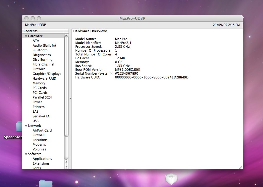

WinstonAce Posted September 21, 2009 Share Posted September 21, 2009 What is your model identifier under system profiler? Link to comment https://www.insanelymac.com/forum/topic/181631-dsdt-vanilla-speedstep-generic-scope-_pr/page/10/#findComment-1274573 Share on other sites More sharing options...

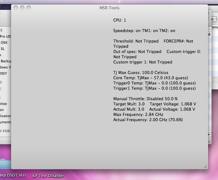

Squirrelf Posted September 21, 2009 Share Posted September 21, 2009 remove cpui kext, and disabler, reboot run MSRtools posted in this thread and check if your cpu is still at max frequency As I have noticed cpui has an impact on how the cpu runs.... and maybe you'll see that speed step is actually working, if not than never mind .... anyway, you may be able to have speed step but your odle temps will be still high... idle with speed step I managed to be "only" 5C hotter (still +10C on average use) compared to having disabler( but no speed step) lower temp is the whole point for me, less heat usually mean less power consumption... so I don't care about speed step until someone finds a fix for the temperature (well ssdt + c-states did the trick, super low temps, full benchmark on load, even if my cpu is not supposed to support anything but C1E, which I think is why video and sound was stuttering, which is not an option for me )... you may be able to get nice temps after including c-states to your dsdt, since your cpu support C2/C4 you maybe won't get stuttering like I did... Link to comment https://www.insanelymac.com/forum/topic/181631-dsdt-vanilla-speedstep-generic-scope-_pr/page/10/#findComment-1274634 Share on other sites More sharing options...
keeza Posted September 21, 2009 Share Posted September 21, 2009 What is your model identifier under system profiler? Please see attached pic form sys profile. did you try this? Think I am now getting somewhere. See my reply to Eliade. Thank you for pointing out my DSDT error. and you may wanna try the fixes in snow itself. coz snow leopard brings about new problems even if you have a perfect leopard. Yes I did, compiled without error! OK I agree, plan on getting a copy next week. remove cpui kext, and disabler, rebootrun MSRtools posted in this thread and check if your cpu is still at max frequency As I have noticed cpui has an impact on how the cpu runs.... and maybe you'll see that speed step is actually working, if not than never mind .... anyway, you may be able to have speed step but your odle temps will be still high... idle with speed step I managed to be "only" 5C hotter (still +10C on average use) compared to having disabler( but no speed step) lower temp is the whole point for me, less heat usually mean less power consumption... so I don't care about speed step until someone finds a fix for the temperature (well ssdt + c-states did the trick, super low temps, full benchmark on load, even if my cpu is not supposed to support anything but C1E, which I think is why video and sound was stuttering, which is not an option for me )... you may be able to get nice temps after including c-states to your dsdt, since your cpu support C2/C4 you maybe won't get stuttering like I did... I removed the CPUi kext as you suggested. I also ammended my DSDT as Yeehaa suggested. Now I have stepper data - I think this is good. I agree with you that without a temp reduction Speedstepping is of no real use. The way I look at it though is if I can get it working then when a fix comes along I'll be ready!! I think this looks good.... My output from MSR shows my CPU at my lowest frequency and voltage. Now I will try adding my full SSDT to my DSDT and see what happens...... Link to comment https://www.insanelymac.com/forum/topic/181631-dsdt-vanilla-speedstep-generic-scope-_pr/page/10/#findComment-1274656 Share on other sites More sharing options...
keeza Posted September 21, 2009 Share Posted September 21, 2009 Looks like I got it working!! CPUi shows stepping now, I seem to be hovering around the 45-50 degrees. It seems that CPUi possibly interferes with getting speedstepping working as Eliade suggested. I removed CPUi kext. I then re-installed CPUi and now the stepping is showing under the status tab. So its possible that this kext perhaps somehow impedes speedstepping. However, in my case, removing and reinstalling the kext seems to have fixed that. I will keep you posted on what happens from here. Thanks to all that helped, particularly Yeehaa, Eliade, Winston and all the others that have contributed to this board. Link to comment https://www.insanelymac.com/forum/topic/181631-dsdt-vanilla-speedstep-generic-scope-_pr/page/10/#findComment-1274696 Share on other sites More sharing options...
Squirrelf Posted September 21, 2009 Share Posted September 21, 2009 your temps are about the same as mine with speed step and no disabler (when my room is cool)... Now that you have speed step, I'd give cstates a shot if I were you, use your cst files if you had any with your acpi dump, otherwise try MP3.1 cst files, there are a bunch of dsdt posted in this thread with cst included, it's very easy... just copy and paste, (4 blocks of code, one big from your cst file and 3 other small ones that you can get from other dsdt with cstates fix in this thread), I'll post my c-ctates version if you need it, let me know... be sure AppleLPC is loaded when you try cstates (if you have the same ICH10R then use the dsdt fix posted earlier) just run some music in itunes, or a movie, don't move the mouse, and see if you have stuttering on my machine moving the mouse wildly made the stuttering go away during that moment. Temperature were about the same as having disabler and no speed step (maybe slightly lower temps), but with cst added, speed step was still running, under-load benchmark were perfect, I don't really know how to visually check c-states, but as long as temps are low, speedstep working and if you don't get stuttering than your setup will be perfect... however with cstates and appleLPC I lost Sleep, which I use often so that's a second reason why I don't use c-states... just so you know without c-states, but keeping appleLPC, sleep works for me... which cpui are you using, the one posted, or you recompiled it ? Link to comment https://www.insanelymac.com/forum/topic/181631-dsdt-vanilla-speedstep-generic-scope-_pr/page/10/#findComment-1274704 Share on other sites More sharing options...

WinstonAce Posted September 21, 2009 Share Posted September 21, 2009 Looks like I got it working!! For me it doesn't work with model MacPro2,1 I ned to use smbios.plist in order to change it to MacPro3,1 Link to comment https://www.insanelymac.com/forum/topic/181631-dsdt-vanilla-speedstep-generic-scope-_pr/page/10/#findComment-1274800 Share on other sites More sharing options...

keeza Posted September 21, 2009 Share Posted September 21, 2009 For me it doesn't work with model MacPro2,1I ned to use smbios.plist in order to change it to MacPro3,1 Thats odd, there were other posts earlier on that said you had to change info Plist located in AppleSMC in Platform.Kext. Then there was another post saying not to change it from 3,1 to 4,1 as it KP's. So I left it as is. However, when it was pointed out to me that my DSDT had compiling errors when in fact it compiled with no errors using DSDTSE; led me to create a new DSDT from scratch using Everest. I believe I got a better DSDT from Everest than from DSDTSE. I then meticulously made the changes to it and compared mine to numerous others (including yours) and left as much of the original intact as possible. Maybe that explains why it works with 2,1. Maybe that also explains why my ethernet works (internet and network) without a kext and DSDT patch. This is my dsdt with cst, we have almost the same board (ep45-ud3r)I've put all the "SSDT stuff" in the beginning of the dsdt Thank you. I'm giving myself a night away from my computer tonight as I'm starting to grow roots trying to get P-States working. Its 6.30pm in Sydney Oz. But I will try for CStates. BTW, is there a way to visually know if its working? And a Noob question, where is Symbios.plist located? Link to comment https://www.insanelymac.com/forum/topic/181631-dsdt-vanilla-speedstep-generic-scope-_pr/page/10/#findComment-1274818 Share on other sites More sharing options...
