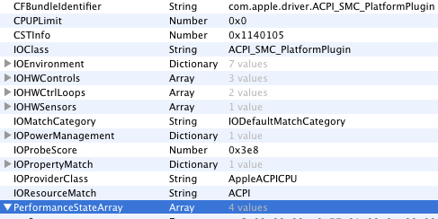

Beerkex'd Posted September 13, 2009 Share Posted September 13, 2009 Master Chief, thanks, I will try what you said and see what happens. I do have the ACPI_SMC_PlatformPlugin, AGPMEnabler and AGPMController as well but they only appear under CPU1. CPU2 only has the AppleACPICPU. I don't, however have "CSTInfo" like you..hmm I have P-state switching and proper shutdown when using VoodooPowerMini.kext (thanks Superhai). Without VoodooPower it runs at full throttle and doesn't shut down completely (the classic "lights go off but CPU fan keeps running"). Try this dsdt and drop ssdt tables. Did you make it? What CPU is installed on the P5Q-E it was taken from, and does AppleLPC.kext load on it? You have to change a device ID in the kext, or you can patch it in the DSDT (excerpt from mine below). I thought AppleLPC.kext needed to be loaded for C-state switching to work at all? Device (LPCB) { Name (_ADR, 0x001F0000) Method (_DSM, 4, NotSerialized) { Store (Package (0x02) { "device-id", Buffer (0x04) { 0x18, 0x3A, 0x00, 0x00 } }, Local0) DTGP (Arg0, Arg1, Arg2, Arg3, RefOf (Local0)) Return (Local0) } Device (IELK) { (....) The main difference I can see from your method and mine is that you inserted the whole thing inside Scope _PR instead of at the end of the DSDT. I copied your entire Scope _PR and also your HPET device to my DSDT (it is very different from mine). I don't get the evaluation errors on boot (with or without DropSSDT=y) and there is no break-up in the sound, but there is no state changing either, it's running at full throttle. CPU temps went up by 4-5 degrees Celsius. Your HPET (SBRG changed to LPCB for AppleLPC.kext): Device (HPET) { Name (_HID, EisaId ("PNP0103")) Name (CRS, ResourceTemplate () { IRQNoFlags () {0} IRQNoFlags () {8} Memory32Fixed (ReadOnly, 0xFED00000, // Address Base 0x00000400, // Address Length _Y0D) }) OperationRegion (^LPCR, SystemMemory, 0xFED1F404, 0x04) Field (LPCR, AnyAcc, NoLock, Preserve) { HPTS, 2, , 5, HPTE, 1, Offset (0x04) } Method (_STA, 0, NotSerialized) { If (LEqual (OSFL (), Zero)) { If (HPTE) { Return (0x0F) } } Else { If (HPTE) { Return (0x0B) } } Return (Zero) } Method (_CRS, 0, NotSerialized) { CreateDWordField (CRS, \_SB.PCI0.LPCB.HPET._Y0D._BAS, HPT) Multiply (HPTS, 0x1000, Local0) Add (Local0, 0xFED00000, HPT) Return (CRS) } } My old HPET: Device (HPET) { Name (_HID, EisaId ("PNP0103")) Name (ATT3, ResourceTemplate () { IRQNoFlags () {0} IRQNoFlags () {8} Memory32Fixed (ReadWrite, 0xFED00000, // Address Base 0x00000400, // Address Length ) }) Name (ATT4, ResourceTemplate () { }) Method (_STA, 0, NotSerialized) { Return (0x0F) } Method (_CRS, 0, NotSerialized) { Return (ATT3) } } I think I will keep trying with my previous method but use your HPET, seeing as it talks to the LPC. Here's my DSDT with your HPET and Scope _PR: ivik_beer_mashup.zip Link to comment https://www.insanelymac.com/forum/topic/181631-dsdt-vanilla-speedstep-generic-scope-_pr/page/6/#findComment-1264929 Share on other sites More sharing options...
yonika Posted September 13, 2009 Share Posted September 13, 2009 The original files appear to be fine. You might want to add a change _PSS object – one with more P-States – but that's apparently all you need. 1) Did you enable C States in your BIOS? And if that's a yes, then which one(s)? Edit: Already answered in post #125 2) What model do you see in System Profiler? Edit: Already answered in post #135 3) Can you please add a FACP dump for me? 4) Open IORegistryExplorer (part of Xcode) and check for the items in my two screen shots, do you see the same items there? n.b. If you don't see the items listed in my screen shots (in post #143) then your changes in Info.plist aren't working. p.s. Feel free to attach your modified Info.plist to see if I can spot the error O.k O.k, I think I am now the happiest man in the entire region, or as happy as one can be from seeing numbers jump from x6 to x9 and vice versa Well, first I'll say what happened, then I'll ask more questions I noticed in your message that you said I answered your question about system profiler in post #135, then I said to myself, Hey, I don't remember checking in the system profiler, so I did, and I saw it was on MacPro2,1. Then I checked my smbios.plist and saw that it was really on 2,1 and not 3,1 (it turns out, I changed the file on the wrong partition) I changed it to 3,1 and Bam, it started jumping with multipliers and voltage. Then I said to myself, are all the changes I tried really necessary to make it work ? and tried removing changes one by one. I ended with the following: smbios.plist with MacPro3,1. No change at all in AppleSMC plugin CPUPM SSDT in DSDT (although I did not try to remove that one yet) CPUISTx2 SSDTs in DSDT with an SPSS fix to look almost like NPSS (fixed last two values for each step, without this it did not work). No CST method in the DSDT at all (still no CST evaluation error on boot) No dropSSDT=yes flag on boot or com.apple.Boot.plist Now for the questions: 1. where do I find more p-states for my E8400 CPU ? is there any intel's official place it is written in ? any kind of database ? 2. How come it works without all the stuff I mentioned ? the SMC plugin change, the dropSSDT flag ? are all these actually unnecessary ? 3. How do I know if C-states work besides not having the error on boot ? is there an application that shows that ? 4. Before the success, I dumped the FACP (attached) and saw that it says "_cst support: 0" what does this mean ? Do i have c-states or not ??? 5. I read that deep sleep works when using the AppleIntelCPUPowerManagement.kext, how do I enable or go into it ? 6. Last question, what is AppleLPC.kext ? I saw it here, and asked myself if i'm missing something important ? Anyway, here are my files attached if someone wants to take a look, Thanks in advance, Jonathan FACP.zip Hack_Files___Success.zip Link to comment https://www.insanelymac.com/forum/topic/181631-dsdt-vanilla-speedstep-generic-scope-_pr/page/6/#findComment-1264971 Share on other sites More sharing options...
ivik Posted September 14, 2009 Share Posted September 14, 2009 Beerkex'd, DSDT and SSDT are your's, patched with dsdt patcher and added _CST and _PSS. I have done the same thing with my dsdt, and it is cool like in windows/linux. Do you have CPUPLimit set to 0 in your ioreg? Do you have PerformanceStateArray and stepper data in ioreg? You could try replacing NPSS with SPSS. Also try deleting in HPET Method (_STA, 0, NotSerialized) all, and leave just: Method (_STA, 0, NotSerialized) { Return (0x0F) } Also try reduce number of CPU's. I have core solo, and i don't know how core duos / C2d are handled. Link to comment https://www.insanelymac.com/forum/topic/181631-dsdt-vanilla-speedstep-generic-scope-_pr/page/6/#findComment-1265502 Share on other sites More sharing options...

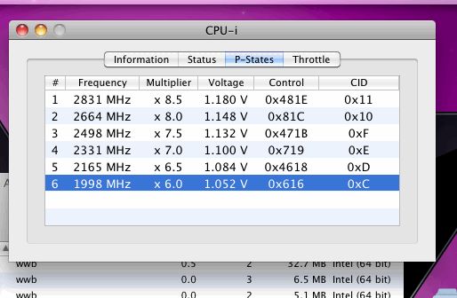

William Parker Posted September 14, 2009 Share Posted September 14, 2009 Have you made any progress using just p-states alone, if so how did you get the values for the fractional multiplier? @formerlyknownas Great thread, but is there another app besides p-state calculator that will allow fractional multipliers? The Q9550 has six p-states. with multipliers of 6, 6.5, 7, 7.5, 8 and 8.5. Without any editing of the dsdt and with nullcpupm in my extra folder CPU-i is showing a change from 6x at idle to 8.5 under load. The multiplier/freq is changing but the voltage always remains at the highest p-state. @william parker I am just delving into the speedstep myself. Also with the Q9550 processor. Since p-state setting are processor dependent... Please keep posted if you make any progress. Link to comment https://www.insanelymac.com/forum/topic/181631-dsdt-vanilla-speedstep-generic-scope-_pr/page/6/#findComment-1265636 Share on other sites More sharing options...

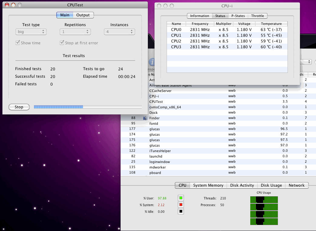

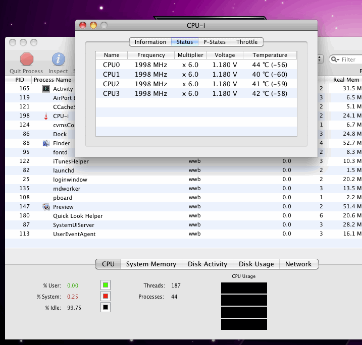

Master Chief Posted September 14, 2009 Share Posted September 14, 2009 Have you made any progress using just p-states alone, if so how did you get the values for the fractional multiplier? I think that I already explained that in post #118 O.k O.k, I think I am now the happiest man in the entire region, or as happy as one can be from seeing numbers jump from x6 to x9 and vice versa ... Now for the questions: 1. where do I find more p-states for my E8400 CPU ? is there any intel's official place it is written in ? any kind of database ? 2. How come it works without all the stuff I mentioned ? the SMC plugin change, the dropSSDT flag ? are all these actually unnecessary ? 3. How do I know if C-states work besides not having the error on boot ? is there an application that shows that ? 4. Before the success, I dumped the FACP (attached) and saw that it says "_cst support: 0" what does this mean ? Do i have c-states or not ??? 5. I read that deep sleep works when using the AppleIntelCPUPowerManagement.kext, how do I enable or go into it ? 6. Last question, what is AppleLPC.kext ? I saw it here, and asked myself if i'm missing something important ? ... 1) You'll either have to use the P-State Calculator (link in post #1) or use a calculator. 2) You MB/BIOS supports C1/C2 and C3 (check the latency in the FACP and post #46) so you don't need it. 3) The power should drop to either 1.000 (C2) or 0.500 (C3) in CPU-i. 4) Probably that CST is natively supported, but there's no documentation about this value. 5) You can check it with pmset -g | grep hibernatemode and change it with sudo pmset -a hibernatemode n* or use the Deep Sleep Widget. 6) This appears to be something that lowers the temperature a little, but I don't know, yet, what it really does or is used for. *Here are the values (from deepsleep.pdf) and the meaning of it: • 0 (quick): Default sleep behavior on most Apple computers. RAM is still powered on while sleeping. Wake up is fast. Safe sleep is disabled. • 1 (deep): Hibernation behavior. System is totally shut down while sleeping. RAM contents are dumped to disk. Wake up is slow. • 3 (safe): Default behavior on Powerbook HD and later computers. RAM is still powered on while sleeping. Wake up is fast. Safe sleep is enabled, so RAM contents are also dumped to disk before going to sleep. • 5 (deep): Same as mode 1 for systems with encrypted virtual memory. • 7 (safe): Same as mode 3 for systems with encrypted virtual memory. Master Chief, thanks, I will try what you said and see what happens. I do have the ACPI_SMC_PlatformPlugin, AGPMEnabler and AGPMController as well but they only appear under CPU1. CPU2 only has the AppleACPICPU. I don't, however have "CSTInfo" like you..hmm I have not found any information about CSTInfo as of yet i.e. I don't know exactly what it does/means. I have P-state switching and proper shutdown when using VoodooPowerMini.kext (thanks Superhai). Without VoodooPower it runs at full throttle and doesn't shut down completely (the classic "lights go off but CPU fan keeps running"). Also when using VoodooPower (and DSDT.aml with no SSDT data) I don't get the CST evaluation error messages on boot. I have used VoodooPower in the past (thanks Superhai) and I think that it injects data to prevent errors, and to make it work. Superhai? p.s. I see (uphuck) that you changed some device names in your DSDT (for the uninformed: to match a Mac): PIC -> IPIC DMAD > DMAC TMR -> TIMR RTC0 -> RTC COPR -> MATH OMSC -> LDRC Link to comment https://www.insanelymac.com/forum/topic/181631-dsdt-vanilla-speedstep-generic-scope-_pr/page/6/#findComment-1265691 Share on other sites More sharing options...
yonika Posted September 14, 2009 Share Posted September 14, 2009 I think that I already explained that in post #118 1) You'll either have to use the P-State Calculator (link in post #1) or use a calculator. 2) You MB/BIOS supports C1/C2 and C3 (check the latency in the FACP) so you don't need it. 3) The power should drop to either1.000 or 0.500 in CPU-i. 4) Probably that CST is natively supported, but there's no documentation about this value. 5) You can check it with pmset -g | grep hibernatemode and change it with sudo pmset -a hibernatemode n* or use the Deep Sleep Widget. 6) This appears to be something that lowers the temperature a little, but I don't know, yet, what it really does or is used for. *Here are the values (from deepsleep.pdf) and the meaning of it: • 0 (quick): Default sleep behavior on most Apple computers. RAM is still powered on while sleeping. Wake up is fast. Safe sleep is disabled. • 1 (deep): Hibernation behavior. System is totally shut down while sleeping. RAM contents are dumped to disk. Wake up is slow. • 3 (safe): Default behavior on Powerbook HD and later computers. RAM is still powered on while sleeping. Wake up is fast. Safe sleep is enabled, so RAM contents are also dumped to disk before going to sleep. • 5 (deep): Same as mode 1 for systems with encrypted virtual memory. • 7 (safe): Same as mode 3 for systems with encrypted virtual memory. I have not found any information about CSTInfo as of yet i.e. I don't know exactly what it does. I have used VoodooPower in the past (thanks Superhai) and I think that it injects data to prevent errors, and to make it work. Superhai? Hey, thanks for replying, I still don't understand somethings though, About p-states calculator ? All it does is convert from specific values I set to hex values for the PSS table, How do i know what power in [mW] or voltages to enter in the first place ? multiplier and speed is easy, though I'm not sure if there are more than just 6,7,8,9 ? About c-states in cpu-i ? where do i see that ? I can see only speed, multiplier and voltage, am I missing a column ? About deep sleep ? I tried Smartsleep prefPane (deep sleep widget has a bug in SL) which sets these values of hibernation mode, then I put my hackintosh to sleep, before sleep it gave me the gray screen of deep sleep, and went to sleep, but when I powered it up, it just booted normally, not from the sleep image, then I checked and saw that there was a saved sleep image on disk, I don't understand, how does Chameleon (I'm using RC1) knows if there is a sleep image or not ? and how to boot ? or maybe OS X needs to tell the bios it is not a regular boot ? Sorry for all these question on questions, and thank you for taking the time and patience to answer, It's just that it always looks close to solving these issues and something else comes up but now it feels like it's getting somewhere Thanks again, Jonathan Link to comment https://www.insanelymac.com/forum/topic/181631-dsdt-vanilla-speedstep-generic-scope-_pr/page/6/#findComment-1265753 Share on other sites More sharing options...
