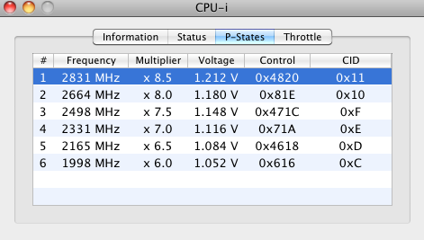

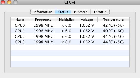

Dr. Hurt Posted September 25, 2009 Share Posted September 25, 2009 I had some free time so I played with this for a while and here's my experience so far. I removed nullcpupm I added macpro3,1 CST to my DSDT Created a legacy LPC kext Added SSDT (on 2 tables were dumped on my system) to DSDT. Results: AppleLPC loads No errors whatsoever P states recognised in cpu-i Speedstep working (no voltage drop though according to cpu-i) Shutdown working without open halt restart Sleep working without sleep enabler. CPU idle at 30C (vs 50C before adding CST to DSDT) PROBLEM: Sound stuttering when cpu usage is low. I think it's because Speed step keeps on switching too frequently. Loading the CPU fixes the issue but CPU temps rise. Tried to fix issue as follows: Disabled speedstep and C1E in BIOS, CPU idles at 36C, speedstep stops, sound still stutters. Removed SSDT from DSDT, and surprisingly speed step still works but I still have the same sound issue. PLEASE HELP!!! Here are my DSDT and SSDT tables: DSDT_SSDT.zip Link to comment https://www.insanelymac.com/forum/topic/181631-dsdt-vanilla-speedstep-generic-scope-_pr/page/12/#findComment-1280128 Share on other sites More sharing options...

Dr. Hurt Posted September 25, 2009 Share Posted September 25, 2009 Try removing the IRQs from your RTC, TMR and PIC devices.This works for me on a GA-EX58 with AppleIntelCPUPowerManagementClient, AppleIntelCPUPowerManagement, AppleHPET and AppleLPC. WOW... That actually worked!! Thanks. Now I have vanilla speedstep and all I had to do was add a Mac Pro 3,1 CST to my DSDT, delete my 2 IRQs, and create a legacy LPC kext. It even works without SSDT. Link to comment https://www.insanelymac.com/forum/topic/181631-dsdt-vanilla-speedstep-generic-scope-_pr/page/12/#findComment-1280305 Share on other sites More sharing options...

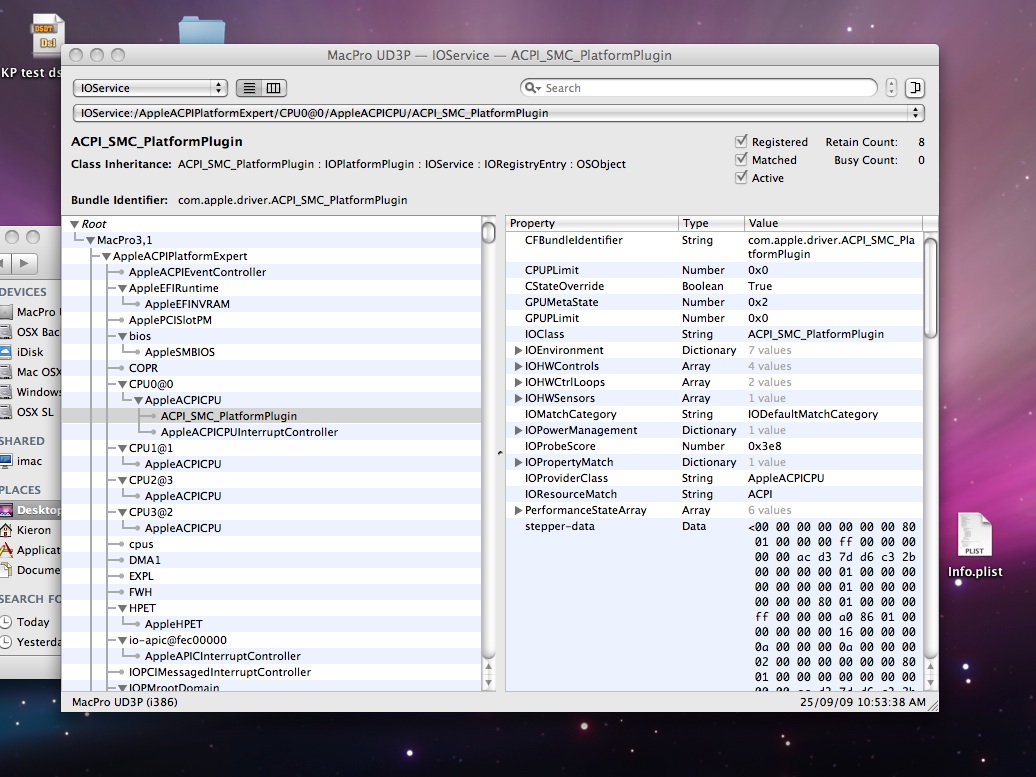

yeehaa Posted September 26, 2009 Share Posted September 26, 2009 How did you get this: "CStateOverride boolean True"? Also note the lack of: "CSTinfo Number 0xsomething". Do have C-State settings in your BIOS? Can you please attach your dsdt.dsl and a dump from IORegistryExplorer? Thanks! you get that if you use a corresponding mac version from ACPI_SMC. i dont know how it works, but if you try with different models in there that have a valid SPx then I think it overrides the stepping value from DSDT and uses the values from the plist. Link to comment https://www.insanelymac.com/forum/topic/181631-dsdt-vanilla-speedstep-generic-scope-_pr/page/12/#findComment-1280786 Share on other sites More sharing options...
Master Chief Posted September 26, 2009 Share Posted September 26, 2009 you get that if you use a corresponding mac version from ACPI_SMC. i dont know how it works, but if you try with different models in there that have a valid SPx then I think it overrides the stepping value from DSDT and uses the values from the plist. It must be me because you use MacPro3,1 and it works. I use it and err.. no dice. But this is most likely the cause of me not using some sort of SMBIOS injection. Link to comment https://www.insanelymac.com/forum/topic/181631-dsdt-vanilla-speedstep-generic-scope-_pr/page/12/#findComment-1280881 Share on other sites More sharing options...
keeza Posted September 26, 2009 Share Posted September 26, 2009 How did you get this: "CStateOverride boolean True"? Also note the lack of: "CSTinfo Number 0xsomething". Do have C-State settings in your BIOS? Can you please attach your dsdt.dsl and a dump from IORegistryExplorer? Thanks! Not sure about the Boolean message, wanted to look into that. At this point I don't have a stable system. I had another lock-up whilst Carbon Copying to a backup partition - I was unable to reboot but have fixed that now. I have 4 theories as to why my system is unstable: 1) My graphics card has incorrect device id (PCIO instead of GFX????) 2) My Cstates don't have a memory allocation (see my post #258) 3) I have incorrectly added my LPC device in my dsdt (PX40 is my LPC device-see attched LSPCI text) 4) My PState values have been incorectly calculated. Further to number 4 my PState values were calculated from CPUi and P-State calculator. The formula that CPUi uses to calculate voltage appears to be: 700 + VID x 16 (multiply before addition). This site Link states a different calculation 800 + VID x 12.5 (for Core2 CPU's) but the results are very similar with either calculation. In P-State calculator you enter a Core Voltage value under CPU Characteristics. If you reduce (or increase) this core voltage the result will be an increase or decrease the power required for the P-State, see example below (second value): 0x00000B0F, // 2831 Mhz in hex 0x00017318, // Power required for this PState 0x000000A0, 0x0000000A, 0x00004826, 0x00004826 // FID=8.5, VID=38 So I believe that its hard to get these values wrong if using PState calculator (unless the accuracy of the Calculator itself is in question). So while its possible to have varying Core Voltage settings in P-State calculator (under CPU characteristics) this setting has an affect on the P-Sate value it generates, i.e. if you decrease the Core Voltage this will increase the power requirement for the P-State and vice versa. What is in question though, as I don't know the answer (i intend to try it out) is the BIOS settings. If I have set say 1.3v as my core voltage under CPU characteristics in P-State Calculator should my VCore voltage in BIOS be set to the same (and not set to Auto?) Could the interaction between BIOS under Auto settings and P-State settings in my dsdt under OSX result in the high voltages and be a reason for my instability? Or is it something in my setup? All I am is a humble architect and not a programmer or coder. I have only been using OSX for about a year and my main working machine is currently an imac. when my hack is stable I intend to port everything across to my "G5". In honesty I was ready to drop the C-State P-State additions as it was causing me too much grief (and I don't want to be a pain -- the ---- to anyone. But hey, I built my hack into a G5 case, spent numerous hours getting to this point and enjoyed the ride but I think I've come as far as I can with my present knowledge. I've attached appropriate files if anyone cares to check them for me. It would be appreciated. P.S. Could my instability be caused by being on 10.5.8??? Should I use fakesmc instead of decrypt? I get a free replacement @9550. Word! WTF! Are they telling me that OS X includes technology to disable our CPUs? Congrats on pulling that off! Awesome prcessor especially for overclocking. I didn't know that disabling algorithms existed for processors! Keez_CState.zip Link to comment https://www.insanelymac.com/forum/topic/181631-dsdt-vanilla-speedstep-generic-scope-_pr/page/12/#findComment-1280897 Share on other sites More sharing options...
keeza Posted September 26, 2009 Share Posted September 26, 2009 you get that if you use a corresponding mac version from ACPI_SMC. i dont know how it works, but if you try with different models in there that have a valid SPx then I think it overrides the stepping value from DSDT and uses the values from the plist. Can you confirm the correct procedure for editing the model id in ACPI as referenced above - I suspect I may have done this incorrectly. I renamed the first instance of MacPro4,1 under <key>CStateDemotionDict</key> to Macpro3,1 and then I renamed every other instance of Macpro4,1 to MacPro3,1 in that kext. System Profiler says I have MacPro2,1. I don't use smbios.plist Maybe that explains my Boolean=True? EDIT: This is interesting, I have attached a pic of a comparison made between two separate dumps from Everest, one with C1 enabled in BIOS, the other with C1 & C3 enabled in BIOS. Notice the different values generated. Everything else was identical. C3 dump is the one I'm presently using. Is there a reason why I should use one instead of the other? Link to comment https://www.insanelymac.com/forum/topic/181631-dsdt-vanilla-speedstep-generic-scope-_pr/page/12/#findComment-1280942 Share on other sites More sharing options...
yeehaa Posted September 26, 2009 Share Posted September 26, 2009 It must be me because you use MacPro3,1 and it works. I use it and err.. no dice. But this is most likely the cause of me not using some sort of SMBIOS injection. In my case that Boolean thing came up when I used MacBookPro 4,1 or Macbook 3,1. not sure. right now i am using MacPro3,1 and this injection does not result in that Cstate override. Further to number 4 my PState values were calculated from CPUi and P-State calculator.The formula that CPUi uses to calculate voltage appears to be: 700 + VID x 16 (multiply before addition). This site Link states a different calculation 800 + VID x 12.5 (for Core2 CPU's) but the results are very similar with either calculation. In P-State calculator you enter a Core Voltage value under CPU Characteristics. If you reduce (or increase) this core voltage the result will be an increase or decrease the power required for the P-State, see example below (second value): All I am is a humble architect and not a programmer or coder. I have only been using OSX for about a year and my main working machine is currently an imac. when my hack is stable I intend to port everything across to my "G5". In honesty I was ready to drop the C-State P-State additions as it was causing me too much grief (and I don't want to be a pain -- the ---- to anyone. But hey, I built my hack into a G5 case, spent numerous hours getting to this point and enjoyed the ride but I think I've come as far as I can with my present knowledge. I've attached appropriate files if anyone cares to check them for me. It would be appreciated. P.S. Could my instability be caused by being on 10.5.8??? Should I use fakesmc instead of decrypt? you can get the pstates off your ssdt and edit like this: Get the lowest and highest values from SSDT and interpolate the values in between. I had 3 states in my ssdt tables and now i have 9. and switching is working perfectly. if you are stuck on calculating them by yourself scroll back and you will come across a posting by superhai detailing the process a bit About being a coder, am sure most of the people on this forum are not programmers either. almost all of them do this as a hobby or something. so moot point you should definitely switch to fakesmc (IMO) Can you confirm the correct procedure for editing the model id in ACPI as referenced above - I suspect I may have done this incorrectly.I renamed the first instance of MacPro4,1 under <key>CStateDemotionDict</key> to Macpro3,1 and then I renamed every other instance of Macpro4,1 to MacPro3,1 in that kext. System Profiler says I have MacPro2,1. I don't use smbios.plist Maybe that explains my Boolean=True? EDIT: This is interesting, I have attached a pic of a comparison made between two separate dumps from Everest, one with C1 enabled in BIOS, the other with C1 & C3 enabled in BIOS. Notice the different values generated. Everything else was identical. C3 dump is the one I'm presently using. Is there a reason why I should use one instead of the other? >I have not edited ACPI_SMC info.plist. i have working pstate and no cst errors after i added just my first SSDT table to dsdt. (the first table being CpuPm which points to all the CST and IST tables from within itself) >so what do you use for SMBios injection? >you should be using C3 dump. because the c1 dump does not have the memory addresses to the other cstates. Link to comment https://www.insanelymac.com/forum/topic/181631-dsdt-vanilla-speedstep-generic-scope-_pr/page/12/#findComment-1281436 Share on other sites More sharing options...

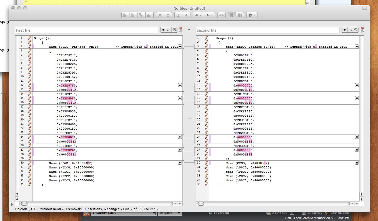

keeza Posted September 27, 2009 Share Posted September 27, 2009 In my case that Boolean thing came up when I used MacBookPro 4,1 or Macbook 3,1. not sure. right now i am using MacPro3,1 and this injection does not result in that Cstate override. you can get the pstates off your ssdt and edit like this: Get the lowest and highest values from SSDT and interpolate the values in between. I had 3 states in my ssdt tables and now i have 9. and switching is working perfectly. if you are stuck on calculating them by yourself scroll back and you will come across a posting by superhai detailing the process a bit About being a coder, am sure most of the people on this forum are not programmers either. almost all of them do this as a hobby or something. so moot point you should definitely switch to fakesmc (IMO) >I have not edited ACPI_SMC info.plist. i have working pstate and no cst errors after i added just my first SSDT table to dsdt. (the first table being CpuPm which points to all the CST and IST tables from within itself) >so what do you use for SMBios injection? >you should be using C3 dump. because the c1 dump does not have the memory addresses to the other cstates. FakeSMC has been installed and appears to work fine on 10.5.8 (Leopard version). P-States are working for me but temps are too high hence the need for C-States. I think the ACPI_SMC edits I have made holds the key as to why C-States are recognised but not loading. Should I perhaps forget about editing acpi_smcinfo.plist file and focus on looking at my smbios injection? I'm thinking that somehow an incompatible MacPro model is being injected and not allowing C-States to load, which you suggested could be the reason for the Boolean message in a post above. For smbios injection I have currently applesmbiosefi kext although I'm trying my system now without it and using a smbios.plist instead. I'm looking now for a template file so that I can create my own. Is creating a smbios.plist the correct way to change your model ID? I want to try different model ID's to see if they hold the key to unlocking this mystery. Working C-States is within my grasp..... Link to comment https://www.insanelymac.com/forum/topic/181631-dsdt-vanilla-speedstep-generic-scope-_pr/page/12/#findComment-1281980 Share on other sites More sharing options...

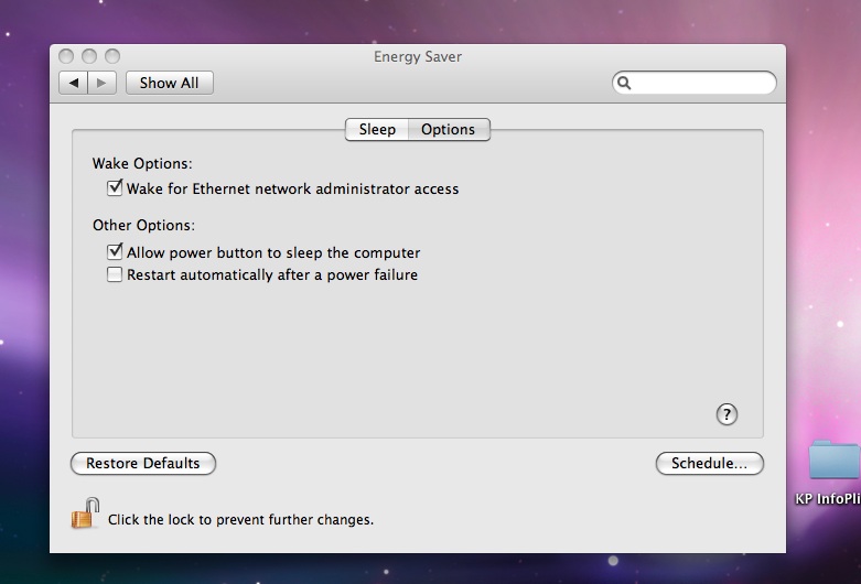

mm67 Posted September 27, 2009 Share Posted September 27, 2009 Just noticed that fixing the speedstep also had a nice side effect. Now I can use my usb keyboard and mouse to wake up from sleep. This never worked before on my EP45-UD3. Link to comment https://www.insanelymac.com/forum/topic/181631-dsdt-vanilla-speedstep-generic-scope-_pr/page/12/#findComment-1282042 Share on other sites More sharing options...
