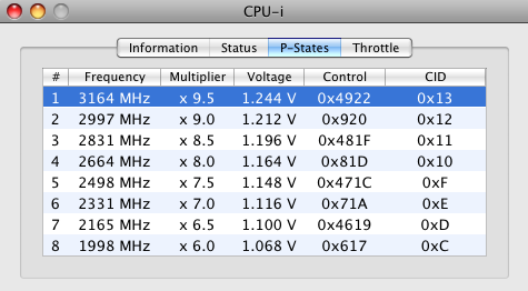

Need some help please to get my speedstepping working.
Please see my attached C-States which I created.
I've compiled my DSDT with the SSDT and no errors.
I've deleted Disabler kext from E/E
CPU-i shows my temps at idle have gone up (55-58 degrees) and no stepping or changes show under the P-States tab of CPU-i.
How can I check to make sure its loaded? I've gotten this far, need help to finish.

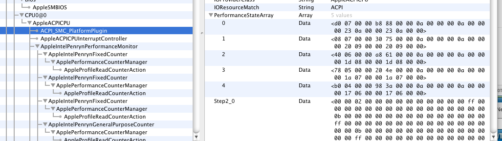

you can see whether the pstates are "loaded" thus: (screenshot from IORegExplorer; i have 5 pstates)
your latency values seem to have some problem. look at the 3rd and 4th values in each package. i would change them both to 0x0A, for every single package.
btw, you are confusing between pstates and cstates!

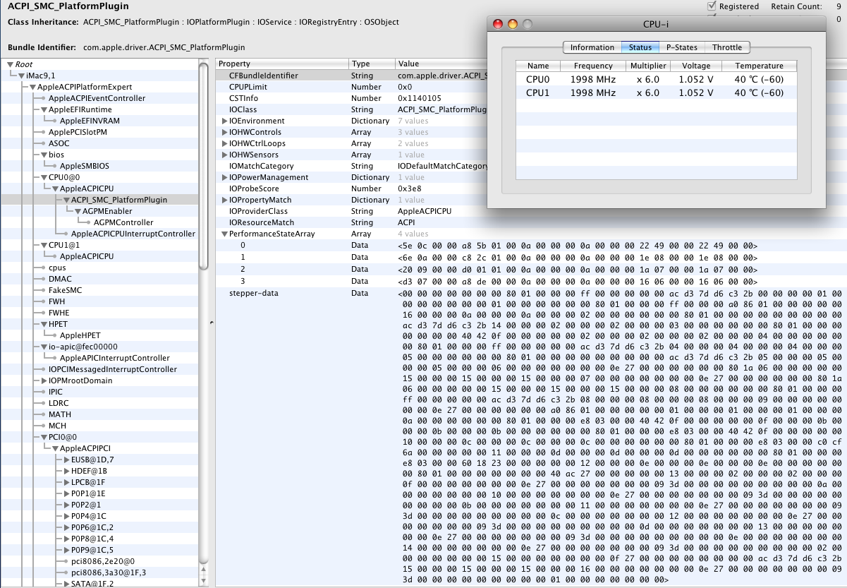

I also don't have CST error when c-states are enabled in bios,see post #125, I can also add that using the dropSSDT=y flag does not change the absence of cst errors on boot.
Jonathan

Okay, I finally had my breakthrough with this and I'm very excited :star_smile:. I have P-state switching (8 of them!) and I fixed the skipping sound.
I appended my SSDT tables (complete dump here: http://www.insanelym...p;#entry1258828 ) at the end of my DSDT following FormerlyKnownAs' example in the first post - carefully comparing my own SSDT dumps to his I picked the equivalent sections and inserted them one by one. I also followed Master Chief's advice (see earlier in the thread) and changed the 1 in Name (NPCP, 0x00000001) to a 2.
I have a C2D E8500 - so I removed all CPU references but CPU0 and CPU1 (probably not strictly necessary but it's cleaner). I also did some device renaming (not sure if that part is absolutely necessary either) to better match the DSDT of an iMac9,1, which is the model identifier I'm using.
Because Master Chief said it might make a difference, I changed the CPU labels to CPU0 and CPU1, they were P001 and P002 in the original DSDT.
Other than the renaming I've made some modifications to HPET, RTC, IPIC and TIMR devices, first copying some ideas from this blog here:
http://aserebln.blog...2009/07/20.html
..and later modifying them again, following THe KiNG's advice in the DSDT subforum over at the ProjectOSX forums. What got me started originally was the LPC device DSDT info posted here: http://www.insanelym...p;#entry1008957
As mentioned earlier in the thread, I have patched the LPC device ID in the DSDT so that AppleLPC.kext loads, using the method outlined by zhell here:
http://www.insanelym...howtopic=168014
As Superhai said in http://www.insanelym...p...t&p=1264201 it was a timing issue.
Thanks to ivik (see earlier in this thread) who alerted me to the fact that I was missing several lines of code from the P5Q-E's original DSDT in my HPET device - I guess it must have been patched out when using koalala's ACPI patcher.
I also did sudo pmset -a dps 1 - not sure if that's necessary either but it seemed like the right thing to do. type man pmset in terminal for more info.
Here's my DSDT: 1809_BK.dsl.zip
If you have a recent ASUS board with AMI BIOS you might be able to use some of the fixes, so take a look and take whatever you need.
Huge thanks to everyone who keeps pouring their knowledge and their findings into the community, you are all awesome. I'm really enjoying the ride.
Shouts and major props go out to my original partner in crime, Pere, 18seven for helping me fix my compiling errors and to the DSDT fairy (let's call him "R") who appears secretly in private messages once or twice a year :P
/EDIT

Okay, I finally had my breakthrough with this and I'm very excited :D. I have P-state switching (8 of them!) and I fixed the skipping sound.
Great! But why did you duplicate all objects but _CST? You might want to remove these, and use the objects in the first Processor block. Just a space saving nit of course.
