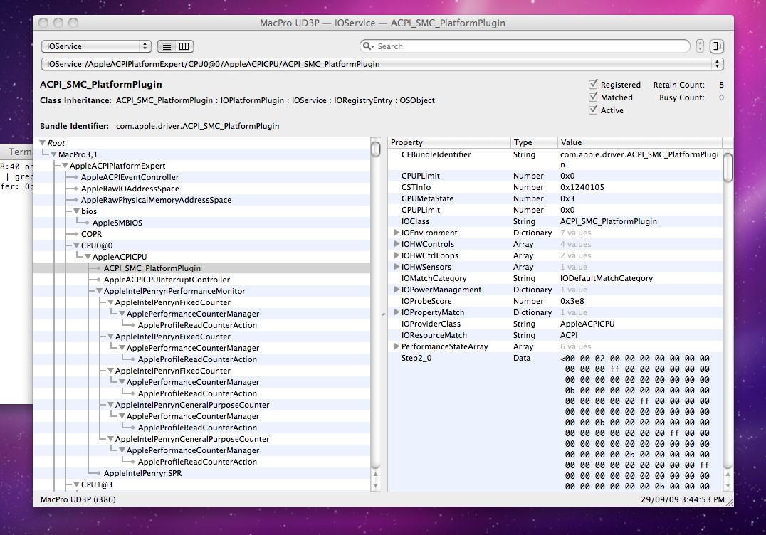

Master Chief Posted September 29, 2009 Share Posted September 29, 2009 Demystifying P-State Loading I installed Snow Leopard from the retail DVD for this exercise, and made no changes whatsoever. Here's a screen shot of System Profiler: And here's one of Xcodes' IORegistry Explorer: And both show P5K PRO simple because that's what I use, and because I use Chameleon v1.0.11 as boot loader – the one without SMBIOS patching capabilities – so that's what I get. I can change it, yes, but I rather do not (to show you what needs to be changed). I used a clean vanilla DSDT dump for this exercise, one without any modifications whatsoever related to P-States and C-States, and as a result I have the following two errors in kernel.log: Sep 29 07:13:57 Master-Chiefs-Mac kernel[0]: ACPI_SMC_PlatformPlugin::pushCPU_CSTData - _CST evaluation failed Sep 29 07:13:57: --- last message repeated 1 time --- Sep 29 07:13:57 Master-Chiefs-Mac kernel[0]: ACPI_SMC_PlatformPlugin::registerLPCDriver - WARNING - LPC device initialization failed: C-state power management not initialized My AMI BIOS (1303) has two default P-States, showing up as PerformanceStateArray under ACPI_SMC_PlatformPlugin. Here's a screen shot of it: And without any modification whatsoever, my CPU appears to be running at full speed: Note: I have stated otherwise, but that was on Leopard where the model identifier is changed to MacPro3,1 by the use of Chameleon with SMBIOS patching aka ChameleonSM v1.0.12 (doesn't work with Snow Leopard). And adding the following code to my DSDT: Name (_PSS, Package (0x04) { Package (0x06) { 2498, 88000, 10, 10, 0x4720, 0x0000 }, Package (0x06) { 2331, 59643, 10, 10, 0x071E, 0x0001 }, Package (0x06) { 2165, 51124, 10, 10, 0x461C, 0x0002 }, Package (0x06) { 1998, 41880, 10, 10, 0x061A, 0x0003 } }) To the first processor declaration block (Processor (CPU1, 0x01, 0x00000810, 0x06) {}) only results in this: No change in CPU speed whatsoever, but what is more interesting is that commenting out the Load() statement, results in this: As in no more PerformanceStateArray. And that simply proves that my otherwise invisible IST data is in fact loaded through this statement. Let's just say that I won't RIP my Processor definition blocks to something like this: Processor (CPU1, 0x01, 0x00000810, 0x06) {) Simply because there are rather important objects in it, and I don't want to fry another CPU. More to come in part II after the break. PhotoBucket is back on-line again so here we go... Now. At this stage I still block Load() from loading my IST tables (from BIOS) and I also removed my customized _PSS() object and thus this is what I get in IORegistry Explorer: The next thing I did was to replaced MacPro3,1 in Info.plist to P5K PRO – all five of them – and went on with my testing after a reboot to find this: Note the new properties and the added values! Ok, still only two default P-States. Well. Let's make that four again... by adding my customized _PSS() object. And only on the first Processor declaration, simply because that's where ACPI_SMC_PlatformPlugin.kext expects it to be (matching based on IOCPUNumber = 0). And here's what that looks like: And CPU-i not only starts up again (needs P-State data) but also shows all changes including: Frequency, Multiplier, Voltage and Temperature. Here's the result: And here's how a custom _CST() object affects the temperatures with a reported case temperature of 41 centigrade (in the BIOS): Note that the C-States aren't even working here/at this moment (CFGD set to 0x01000007) but changing this value will be part of my next exercise. Conclusion We P5K PRO user do not need a _CST() object to get P-States working, however, the temperatures are much higher without it. Not only that, the two errors in kernel.log will also be there. Next step is C-State activation! Note: See post #358 for additional P-State information. Link to comment https://www.insanelymac.com/forum/topic/181631-dsdt-vanilla-speedstep-generic-scope-_pr/page/14/#findComment-1283938 Share on other sites More sharing options...

oldnapalm Posted September 29, 2009 Share Posted September 29, 2009 Hey Master Chief, thanks for the great explanation. I followed your steps and got very close results (4 values under PerformanceStateArray after adding _PSS for my CPU and Step2_0), except that after adding _CST from MacPro3,1 temperatures are still high (> 60º C idle). The main difference here is that my SSDT doesn't have PDC0 so I gave a shot in the dark and used 0x80000000. Using NullCPUPowerManagement.kext and C1E enabled in BIOS I have decent temperatures (40-43º C idle) and CPU-i shows changes in frequency/multiplier/voltage, but only for cores 1 and 2, and between 2 states (my CPU has 4). In Leopard SpeedStep works for all cores using Superhai's VoodooPowerMini.kext, waiting for 64 bit version. Link to comment https://www.insanelymac.com/forum/topic/181631-dsdt-vanilla-speedstep-generic-scope-_pr/page/14/#findComment-1284861 Share on other sites More sharing options...
