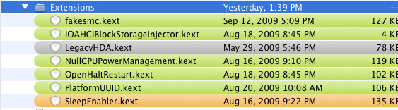

Here is the latest log. but still no sound...
only the trimmed LegacyHDA.kext is present.. any other ideas? I will try finally the DSDT approach.

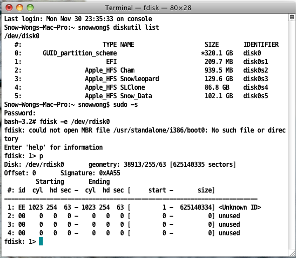

blackosx,
Need your help and advise.
My SL 10.6.2 was running fine till I tried to used a USB stick to boot chameleon instead of Cham partition.
Now booting from Cham some times encountered KP ( blue or black screen just before booting into SL)
Question:
None of the partitions are set active as shown in fdisk -e /dev/rdisk0 (see attachment)
Is this normal?
Partition 2,3&4 shown unused in fdisk whereas diskutil list clearly shown Partition 2=Cham, Partition 3=Snowleopard, Partition 4=SLClone, Partition 5=Snow_Data. (See attachment)
Is this normal? If so, how to set partition 2 or 3 or 4 active since they are listed unused?

In your system, under terminal if you type fdisk -e /dev/rdisk0 tthen p, does it show that all partitions (Cham, Snowleopard, etc) are unused except 1 (EFI) ?

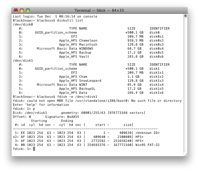

Here's the result of diskutil list, then fdisk -e /dev/rdisk1 followed by p from my system.
Note, my Snow Leopard install is disk1
And here's Rammjet's Fdisk guide if you haven't found it already.
http://www.insanelymac.com/forum/index.php?showtopic=22844

Thanks blackosx. This confirm my suspicion that there is something wrong with my setup.
Have gone through Rammjet's Fdisk guide as well as well as some others but didn't find any solution to my problem.
Any idea how I can fix the problem so fdisk show up the proper partition list like yours?
