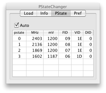

blackosx, I tried to implement the Speedstep but I can't get it to work. The DSDT file compiled just fine but when I look in the IORegistryExplorer, I don't see the CSTInfo and the PerfomanceStateArray doesn't look quite right. Also, I don't have the C2/C2E State Support and C4/C4E State Support showing up in BIOS.
I have attached my DSDT file so if its not too much trouble, could you please take a look at it?
Hi CyCLoBoT
Can you create a signature so I know what hardware you have? As for speedstep I need to know what motherboard (IIRC you have the EP45-DS3L) and CPU you are using.

And for your DSDT, it looks like you've had a good go at it. Are you sure you have the right FID/VID values in your PSS object? as 0x091E, 0x081E, 0x071E and 0x061E look a bit man made? (if you know what I mean). I have posted my latest DSDT here which includes my PSS and CST objects which you can use for reference. Read the next few posts from there to give you more info and see if that helps.
I did realize that the values did look weird comparing to what others have been getting on the forum including you. But I'm not sure why that's happening. I installed the VoodooPState.kext in the S/L/E folder and when I run the PStateChanger app, I get the following values in the PState tab:
Are there any other settings I have to modify in BIOS to get me the actual values? As I mentioned in my previous post, I don't have the C2/C2E State Support and C4/C4E State Support showing up in BIOS as well.
