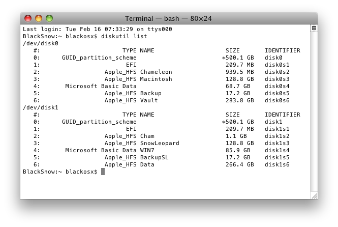

Hi CyCLoBoT
You'll be pleased to hear it's simple now but before doing anything make sure you have the BootCD or a Bootable USB stick and test you can boot in to your Snow Leopard install from which ever one you choose.
You will then also need Dr Hurt's Chameleon RC5 pre-release v8 installer that has the modified boot0 file. Download it from here and have it sat on your desktop for use later.
If you have followed this guide and have Chameleon installed on it's own partition and a spare WIN partition at diskXs4 then you are already set up to go. If you haven't followed my guide exactly then the partition you want to install Windows7 on to should be formatted as FAT (check section 3 of 'Part 1 - Preparation' PDF for a refresher).
Note: petrs99 has pointed out that Windows7 won't install on a partition number higher than 4.
Here's the result of diskutil list for reference. Note my SnowLeopard drive is disk1.
If you have more than one HDD then you must disconnect them all apart from the intended target HDD in SATA port 0. Then all you need to do is insert your Windows7 DVD, reboot and boot in to it. If you don't disconnect other drives then the Windows7 installer has been known to write the boot files it needs to a different volume.
From the Windows7 installer, you will have to format the target partition to NTFS then install. It should be obvious which partition is the one you want (here, mine shows as 86GB in size). Make sure you have identified the correct partition or you will destroy your current OS X installation. After completion, when you reboot Windows7 will have written it's code to the MBR of the disk and will become the default OS and always boot.
To get OS X back, you need to boot by using either the BootCD or the bootable USB stick (which you tested with earlier) and then run Dr Hurt's latest installer (which you downloaded earlier) and point it to your Cham partition.
This will install the RC5 pre-release v8 of Chameleon to your Cham partition and inject Chameleon's stage 0 boot code to the first 440bytes of the MBR, leaving the code that Windows7 put there intact. The modified boot code allows us to boot OS X while it's not the active partition allowing us to leave Windows7 as the active partition as it's won't enter sleep if it's not.
EDIT: If you want the latest version of Chameleon then it's still best to manually install it rather than wait for an installer to be released. And it is now recommended you use the fdisk440 binary for updating the MBR with Chameleon's stage 0 bootloader and for dual booting we can now use the official boot0hfs. This way it will leave and Windows code already present of the MBR intact.
When you reboot you should boot straight in to Chameleon and have the option of booting either OS X or Windows 7.
Note: As always, make sure you have a backup of your files incase anything goes wrong.

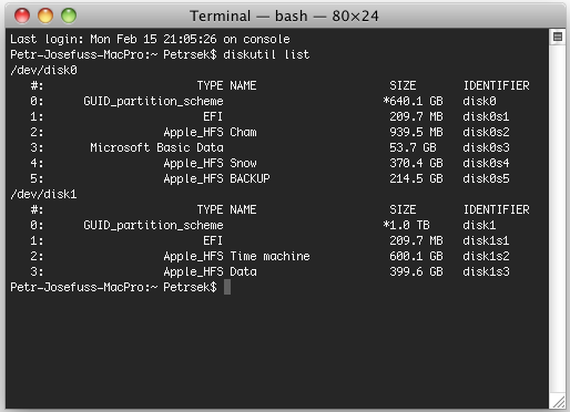

I started with 4th partition in FAT32 and I couldnt continue in Windows installer (There was always some kind of error). FAT32 was not the issue. With the second partition was everything how it should be, but it is kind of small:-)
I found something in topic from mickles on insanelymac in - Guide: Multiboot Windows 7, Leopard, Ubuntu on GPT disk, Using Chameleon 2.0 bootloader on EFI partition
You can have more than 4 partitions, but your windows 7 partition must be in the first three. It would also be wise to have your osx partition in the first three as well. All partitions for ubuntu and windows should be formatted as FAT.
Disk utility creates a hybrid MBR/GPT disk this way, but MBR only allows four primary partitions. The system EFI partition counts as one, so you have 3 beyond that to work with. Fdisk and diskpart can only mark those first four active, hence the reason to have osx in there as well.

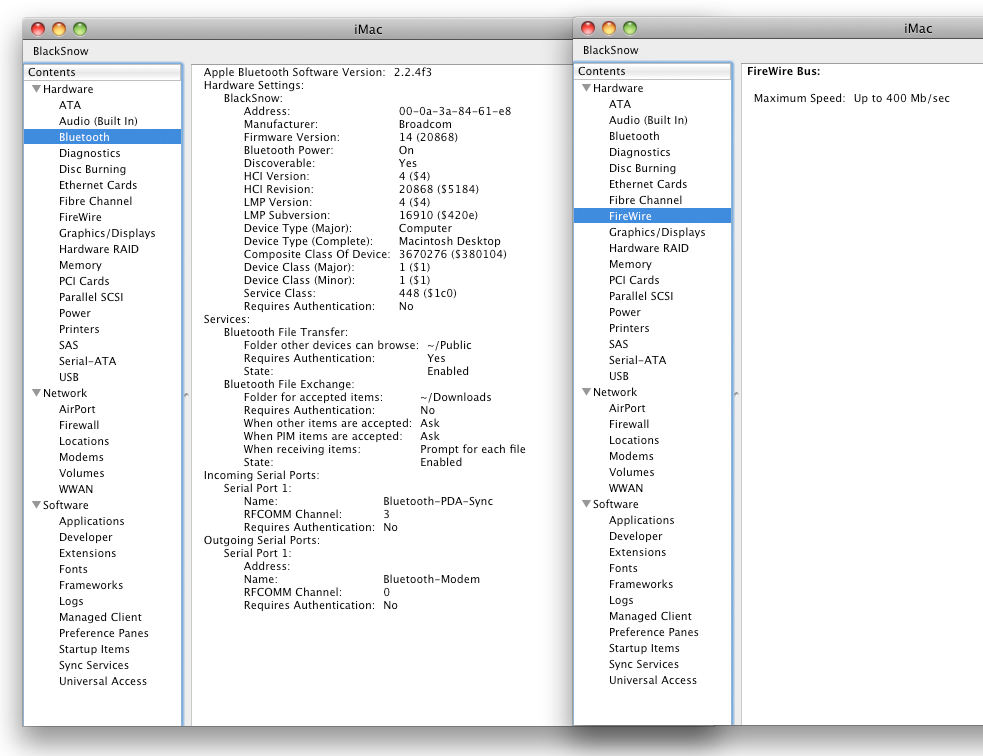

Hey guys, im still having problems with my dsdt (using generic 5 plus speedstep) Firewire looks like working but an attached hard disk don't work. Works perfect in a hackintosh without dsdt.
Bluetooth dongle isnt working, works perfect in a hackintosh without dsdt
Thanks in advance

Hi petrs99

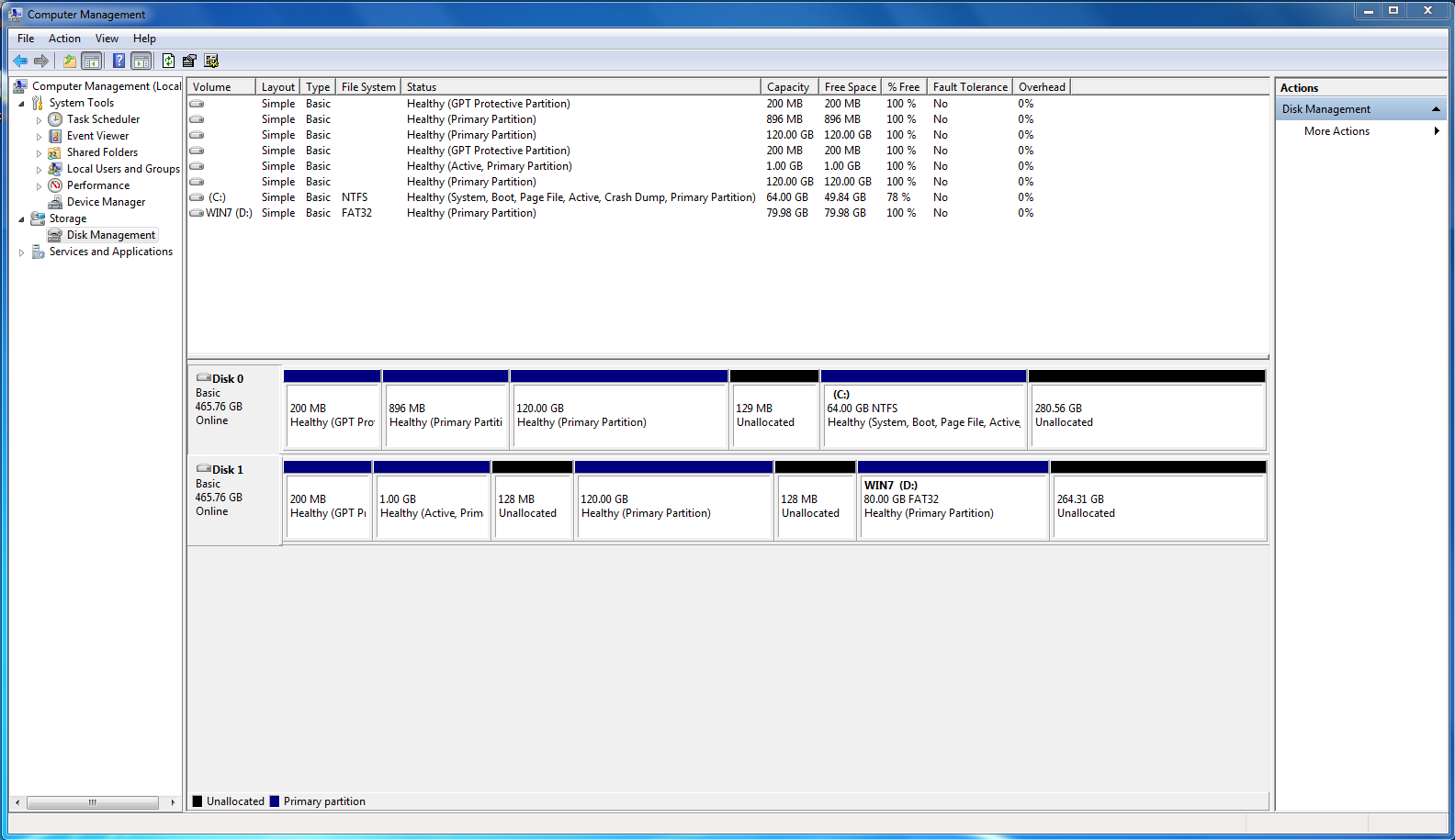

So it was because you were trying to install Windows7 on to your Backup partition which is disk0s5?
I have diveded my HD into 4 partitions (Cham,Data,Snow leopard,Backup)...
disk0s1 = EFI
disk0s2 = Cham
disk0s3 = Data
disk0s4 = Snow leopard
disk0s5 = Backup
Thanks for the tip here, I will add a pointer in the guide for this.
Though the partition scheme I have currently shown in my guide is good as I installed Windows7 to disk1s4
(Note: I have two HDD's installed).
~ blackosx$ diskutil list
/dev/disk0
  #:                       TYPE NAME                    SIZE       IDENTIFIER
  0:      GUID_partition_scheme                        *500.1 GB   disk0
  1:                        EFI                         209.7 MB   disk0s1
  2:                  Apple_HFS Cham                    1.1 GB     disk0s2
  3:                  Apple_HFS SnowLeopard             128.8 GB   disk0s3
  4:       Microsoft Basic Data                         85.9 GB    disk0s4
  5:                  Apple_HFS BackupSL                17.2 GB    disk0s5
  6:                  Apple_HFS Data                    266.4 GB   disk0s6
/dev/disk1
  0:      GUID_partition_scheme                        *500.1 GB   disk1
  1:                        EFI                         209.7 MB   disk1s1
  2:                  Apple_HFS Chameleon               939.5 MB   disk1s2
  3:                  Apple_HFS Macintosh               128.8 GB   disk1s3
  4:       Microsoft Basic Data                         68.7 GB    disk1s4
  5:                  Apple_HFS Backup                  17.2 GB    disk1s5
  6:                  Apple_HFS Vault                   283.8 GB   disk1s6
This ends up looking like this in Windows which is shown as disk0.

Hi xAberracus

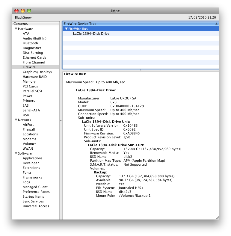

I use a Belkin F8T016NG Mini USB adapter and I have recently added an old adaptec Firewire400 PCI card though I have never actually used them. Here's what System Profiler shows for me.
I will one day try to find something to use them with and let you know how I get on.
EDIT: I have just tried my old external Lacie FireWire HDD and bingo!... works great :D
Here's a screenshot of System Profiler with it plugged it..
Do your firewire and bluetooth problems still appear when you use a DSDT you built yourself from the Gigabyte BIOS file as shown in my DSDT guide?
