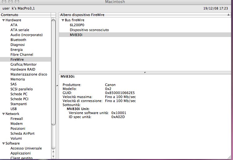

Guest cavallo
What about firewire video cams not recognized by imovie and other applications?
To me everything useless without that, why on g4 there are no problems?

Here one of my dv cam recognized but not by imovie or others why?post-194988-1229704152_thumb.jpg
Does it work if you switch kernels?
No it doesn't.
It's not a kernel problem, it is a kext problem.
Since i installed 10.5.6 kexts and i switch pc on with switched on camera it works.
If i switch off/on camera during use it stops working, i need to reboot.
It is not in any case normal.
