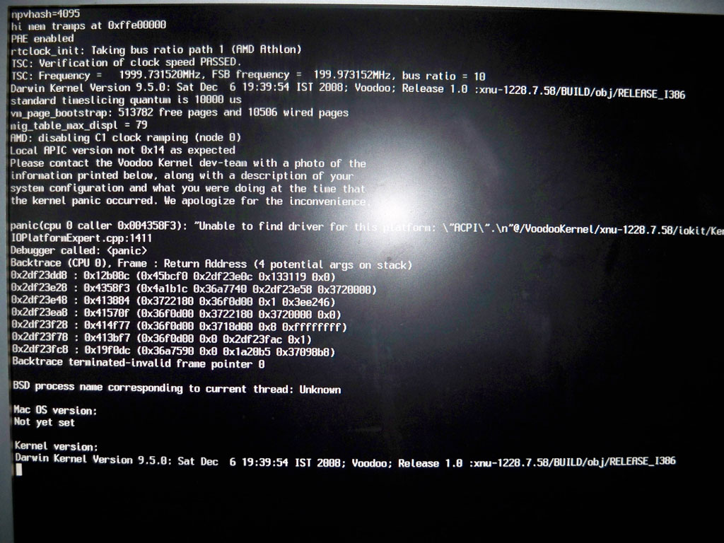

Hi mercurysquad,
I just got back from work and discovered that I am no longer able to boot to OS X. As you know from my older post, the system was running great with no kernel panics or crashes of any kind.
It says something about not being able to detect ACPI, but nothing has been changed in my hardware configuration or BIOS settings.
I have attached an image of the kernel panic.
Thanks!
hecker
EDIT: OK, I just booted the retail DVD with the Boot-132 CD and found out that I have an "Invalid node structure" on my OS X drive. Disk Utility was unable to restore it so I'll give Disk Warrior a try ASAP.
EDIT2: Ok, the partition table was fubar, but I was able to recover it by connecting the drive via IDE to USB adapter to my MacBook and running Disk Warrior from there. Disk Warrior recovered everything fine, as far as I can tell, but I was unable to properly boot from it when I placed the drive back into tha hackintosh. It failed to load some services due to inconsistent UID's or something. Anyway, I'm reinstalling OS X onto a new drive now and I'll try to use the Migration Assistant to recover my old files (or manually, if necessary).
Thinking about this whole mess, I remembered that I switched off the hack last night because it was taking forever to shutdown. The reason for that was that I had left SpotLight scanning the drives. I guess I'll better let it finish next time. :angel:
hello hecker
In the past i got it also, and I had to boot with -x, and then repair autorisations, don't know if it would be usefull in your case ?
cheers
fred
oups sorry, i had not seen your edit post

hello hecker
cheers
fred
Yeah, thank's though. I tried booting off the Disk Warrior boot CD but it gave me the damn ACPI error again. This is a bummer, man.
The first time I used the installer to install voodoo final on my laptop and booted up I also got the same error. I just booted with -s -f, deleted Extensions.mkext from single user mode and then rebooted, it worked.
Yeah that sucks man, had a similar situation when I killed my power on my desktop when windows was running the CHKDSK program...had to do some hardcore recovery and eventually a reinstall to get it working
Thanks for the hint. I was able to restore the partition table with Disk Warrior. Unfortunately the system still wouldn't boot but I was at least able rescue my files and have re-installed from scratch now.
I am somehow, unable to boot from me EFI partition anymore but that's a whole 'nother story. :(
Booting from my Boot-132 CD still works though. Here's a link to this problem:
